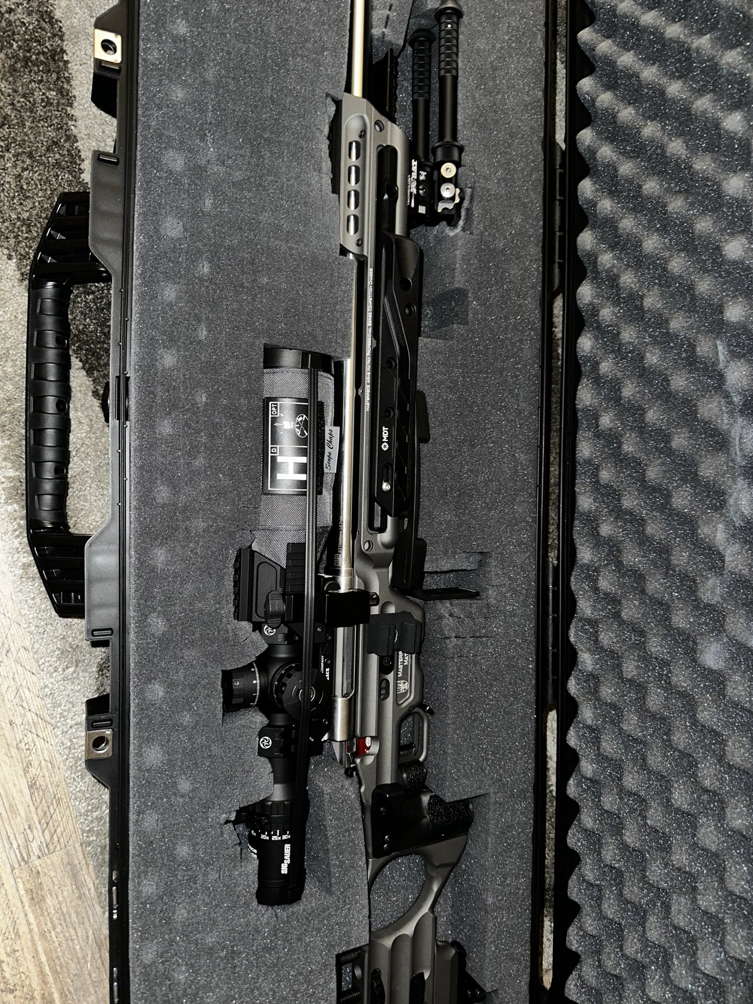

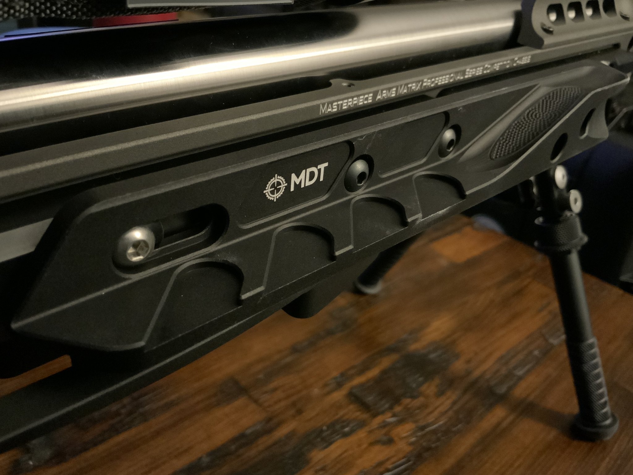

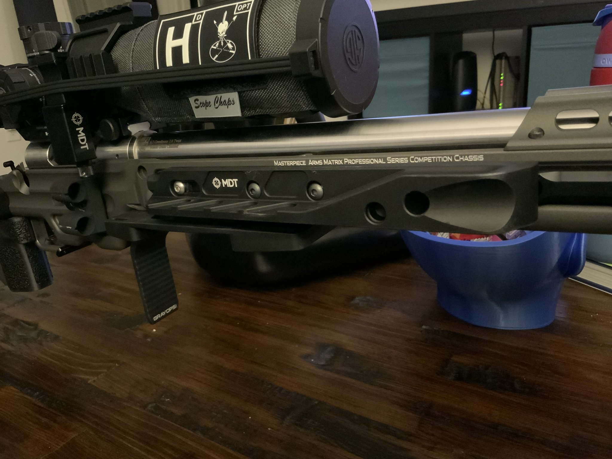

I currently have a MPA Matrix pro BA and recently added the MDT baker wings but notice the lip on the rail obstructing the baker wing from resting flat against the rail so I purchased a longer screw from Home Depot and was able to secure the bakerwing through my barrel weight. Pretty happy with the results! i Like it for the thumb/ hand support but still prefer my bag plate. I hope this helps anyone and everyone.
