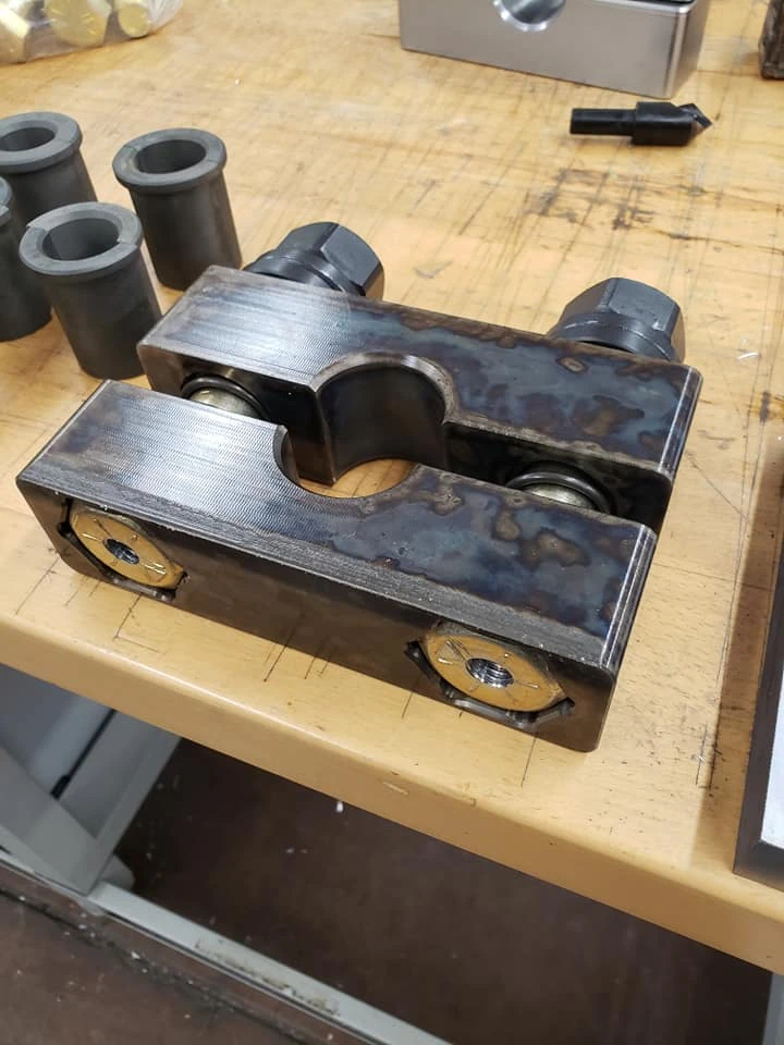

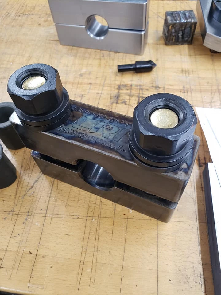

We tear down a metric shit ton of guns every day, week, and month. Remingtons are not hard to do at all. Tikka's, Howa's, Springfields, and Mausers are the real cock suckers. I'm going to sound like a salesman, but I'm really not trying to pimp my stuff. Just know that I have been exactly where you have multiple times with products sold as "the solution". Time is money for me, my staff has better things to do than fight stuff.
That realization compelled me to actually solve it one day around 8 or so years ago.
We've never had a barrel removal problem since I made what we call the "SuperDuty" line of gunsmithing tools. We install north of 100 barrels per month. The average barrel goes on/off the action at least 4 times during the course of that job. So, were looking at around 400 duty cycles per month. If we add in the fluting, piece work for muzzle threading, etc, were probably closer to 500/month.
500/month ='s 6,000 a year. Thats 48,000 duty cycles over the last 8 years give or take. The bolts on our vise finally wore out last summer and had to be replaced. It cost me $12.00 to fix. I used grade 5's when I made this cause that's all we had available in short order. All of our vices are fitted with grade 8 hardware now. The go to tool for remove in our shop is a 3' breaker bar in 1/2" drive. Its pretty common for us to insert a 6' cheater bar (heavy walled pipe) over that thing when we get one of the actions I mentioned earlier. I've had the knuckles and guts replaced on that breaker bar 2x a year for the last 5 or so years because of it. The vice however doesn't give up the goods.
One thing, we never use heat. Once upon a time I did, but not anymore. It really does open the door for more problems than solutions.
Happy to help.
C.
Chad, That is some vise you made, what a TANK, almost looks like you bone charcoal cased hardened it...........or did you ?
