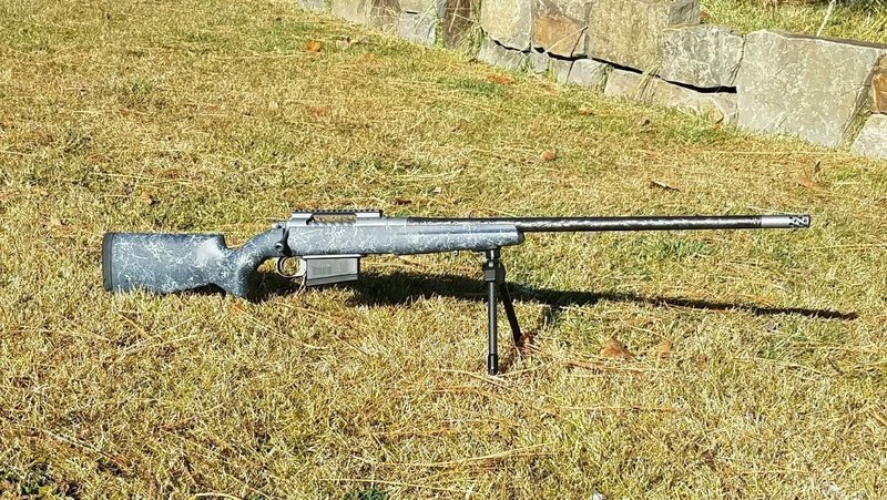

This came up on the Christensen arms Facebook feed this morning....
7lbs all in including the bipod...
