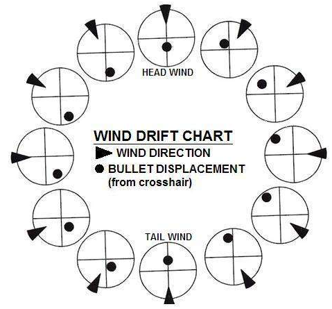

The high and Low effect of this chart is caused by aerodynamic jump (AJ).
AJ for a 90 or 270 degree wind is 0.1 Mil per 10mph (0.3 moa per 10mph) This is the easy way I remember this if you are having to manually add it to your data.
Drop is a direct factor of Time of Flight; headwind increases it, tailwind decreases it.
Crosswinds can also induce Magnus Effect.
As you view a spinning bullet from the upwind side, the upper or lower surface that is spinning away from you generates less aerodynamic drag, has less pressure, and thus generates aerodynamic lift in that direction, exactly like a wing.
As the other upper or lower side spins into the wind, the air on that side backs up in comparison, due to relative stagnation, and has the higher pressure.
This pressure differential generates lift in the direction of lower pressure, pushing the bullet toward the lower pressure. This is exactly the same principle as the way aircraft fly.

Keep in mind, that graphic is exaggerated to show the effect properly.
For example, a head wind or tail wind does affect the velocity, but inside 1k it’s almost so minuscule that you won’t see it on paper.

Aerodynamic jump is linear. The jump happens in the first 30 to 50 yards and sends the bullet in a consistent trajectory after its fully stabilized.
Aerodynamic Jump in a 30mph cross wind = 0.3 mil up or down at 200yds and 1000yds.

my 2c on this.
First of all, if you are zeroing your rifle in more than 10mph wind you're going to have a lot of trouble. Not with only AJ but right and left wind too. I think we all know its not a good situation. But, If you had to zero in high winds you will certainly want to take AJ into account. The easiest way to do this is to look at your ballistic calculator. Put in the wind speed and direction then read the 100yd numbers (use wind 1 on an AB platform). If it tells you to dial 0.1mil up at 100yds I would zero the rifle on the target center (POA=POI) and then slip my turrets to 0.1 up rather then slipping them to 0.0. This will account for the AJ adjustment.
We also want to think about how perfect your rifle zero is to start with? how much "noise" are we dealing with? Are you between clicks to get it just right? Could your fundamentals have changed from today to tomorrow to change your 100 yd zero? If we are zeroing our rifle in less then 10mph wind AJ is lost in the noise because its less then a 0.1mil. If its a 20 or 30 mph day AJ is going to start to matter... but your wind is going to be worse. So again, when zeroing in those wind conditions the AJ is lost in the noise because your wind zero will probably be so far off. Even if you adjusted for the wind, are you sure its right?
Ignoring the fact that zeroing in 20+mph winds gives you a hasty wind zero, at best, lets look at how much the AJ really matters. Again assume a right to left 20mph wind so your zero is 0.2 mil high. If the wind keep blowing that day and you are not using AJ in your calculator you should hit all day. if you are using AJ in the calculator you are .2 mils high for that day because you are adding AJ onto AJ. IF the the wind is gone the next day your are .2mils high all day. If the wind switches left to right you are at a perfect zero if you are not using AJ in your calculator or .2 mil low is your are using AJ in the calculator. either way your are .2 mils high or .2 mils low.
How much does that matter? 0.2 mils at 500yds is 3.6 inches. and 7.2 at 1000. How big is your target?
We can't say "its never going to work" because it could work out. It all depends on what wind you zeroed in, what the wind is today and if your using AJ in your calculator. Is zeroing in wind a good situation? no. Can we account for it? Yes. Can you zero on a better day? I hope so, for the sake of your windage zero which will likely mask the effects of AJ anyways.
