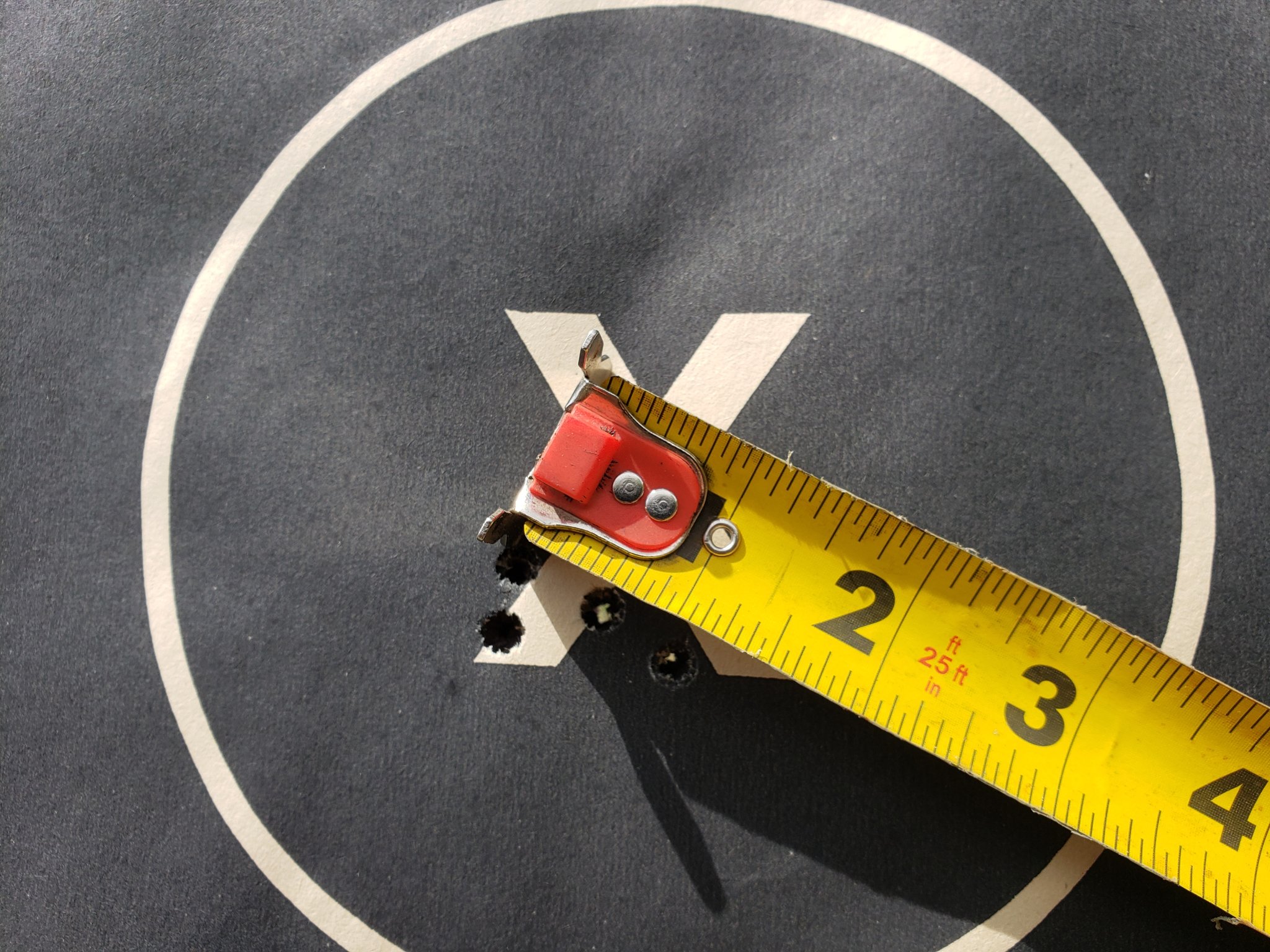

Does your rifle shoot better with a clean or dirty bore?
Since I don't get to shoot bolt action all that much, I figured out that my Howa 308 with Pacnor barrel shoots best dirty. I don't clean copper and now I barely clean for carbon.
7102941
5 round group, first shot I pulled but the next 4 were definitely on at 100 yards.
Which way does your rifle shoot best?

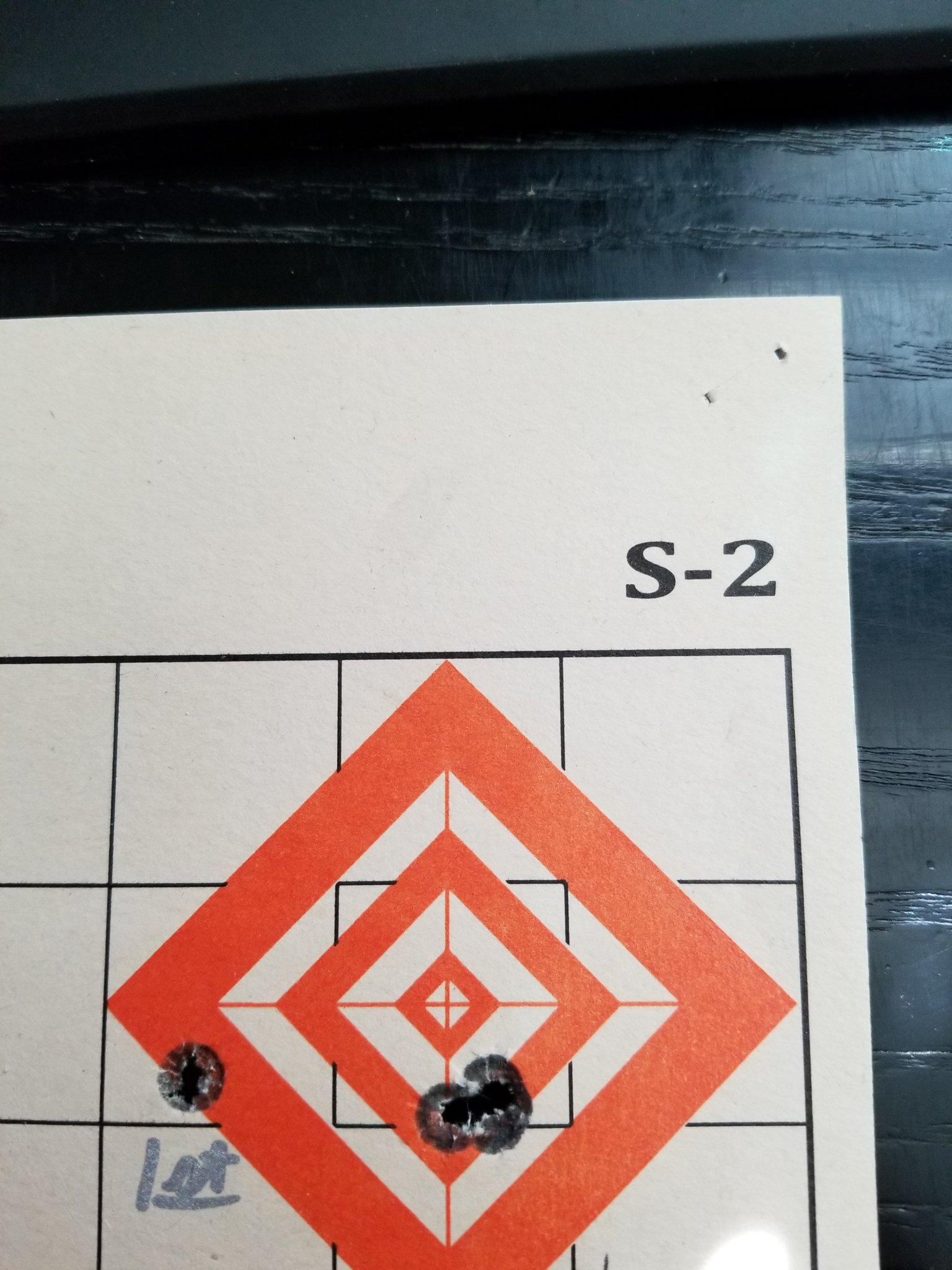

My rifles seem to need three to five shots from a clean barrel to settle back down to the original poi and group size.

My first round from a clean and lightly oiled bore was two inches below the usual poi. The second was one inch low. The third was maybe a half inch low. Then the group was back where I expected.
Somehow I expected the opposite but appears a clean bore results in lower velocities for the first few shots. Horizontal was dead on.

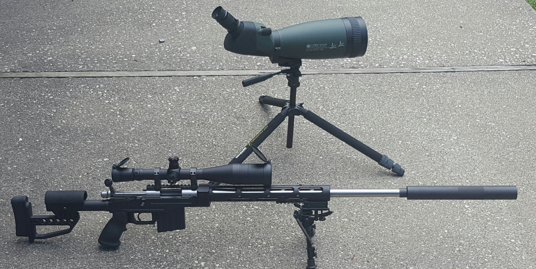

Rem 700 action / Bugholes barrel... heavy varmint profile , 0.900 at the muzzle.
Im shooting 100% suppressed. 41.5 gr H4350 @ 2745 fps. 140 Herger Hybrid Target . 0.40 - 0.65 " @ 100 y.

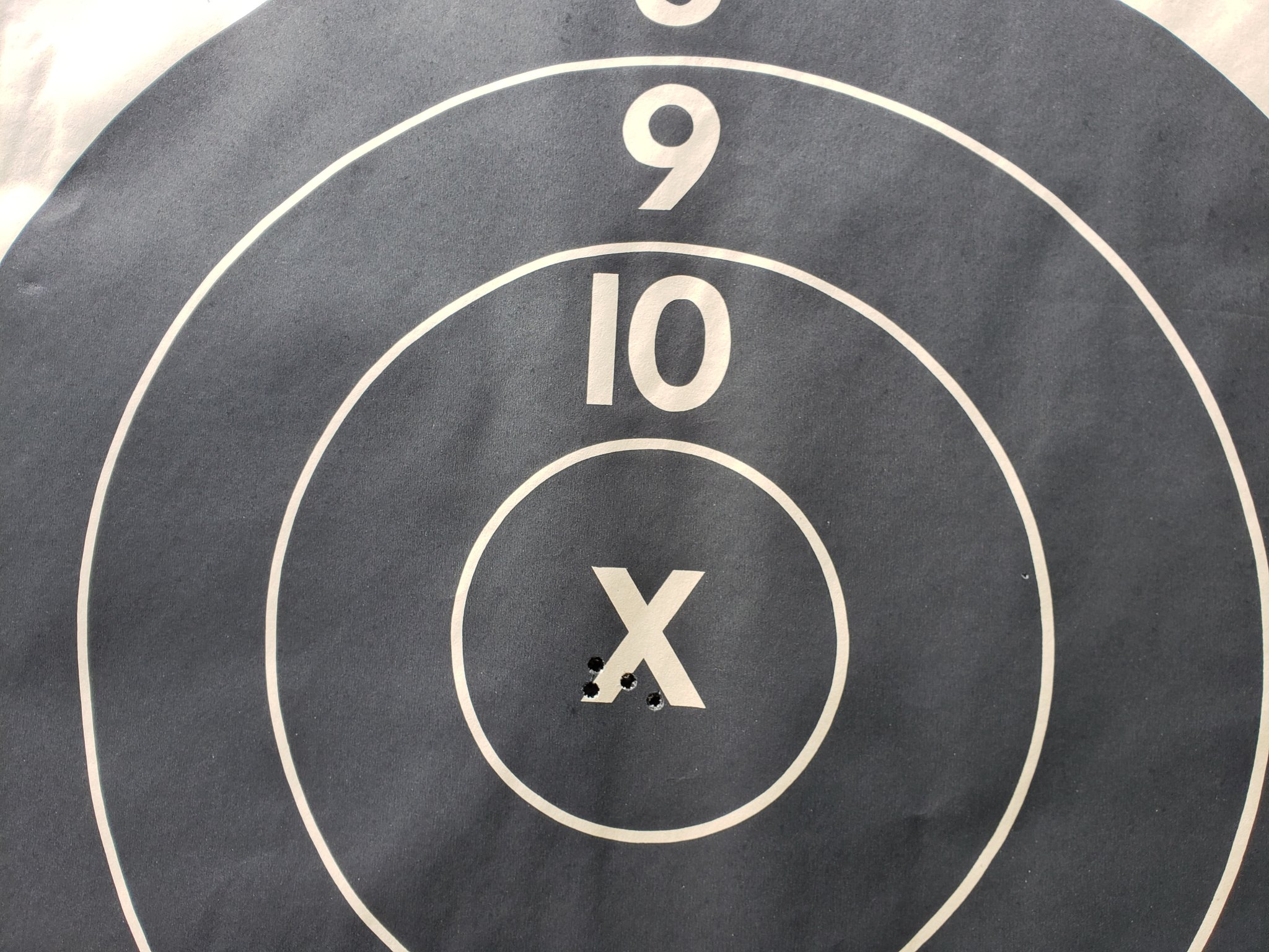

Lol tell that to my axmc 6.5 cm barrel with not a single patch through it in 800 supressed rounds through it...I might just never clean it
@300 yards
