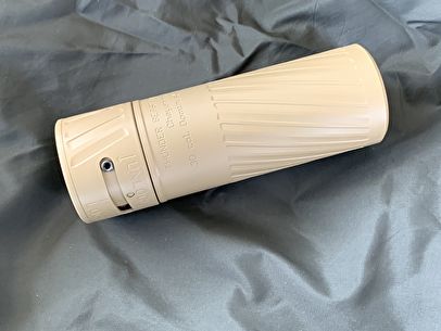

The new DOMINUS-K-SR is the “Short” or “Kurz” version of the hard-use, ultra-lightweight DOMINUS-SR.
The DOMINUS-K-SR is 5.45″ long, 1.8″ in diameter, and weighs only 10.0 ounces. This is 1.5″ shorter and 2.5 ounces lighter than the full-size version. When mounted, it adds only 4.87″ to the barrel overall length.
Just like its larger brother, the DOMINUS-K-SR is designed to withstand at least 10 cycles of the punishing SOCOM/SURG firing schedule, which earns it a hard-use/full-auto rating. It has our SR mount for precision-rifle-level accuracy along with positive retention.
The DOMINUS-K-SR meters at 145 dB (milspec left/right) and 134 dB at shooters-ear on a 20-inch .308 bolt-action rifle. This is roughly 4 dB quieter than the ULTRA 5 for the muzzle measurement.
On 10.3-inch MK18 (without any special tuning) shooting Mk318 5.56 ammunition, it meters at 145 dB muzzle (milspec left/right) and 144 dB at the shooter’s ear. Note that this is the same as the shooter’s ear dB for the full-size DOMINUS-SR for an untuned upper, which means that the shooter is experiencing primarily noise from the action as opposed to noise from the muzzle report.
*sigh* I don't even have paperwork back on the regular size, but I already want this one, too. It's probably more appropriately sized for an already long 22" upper.
