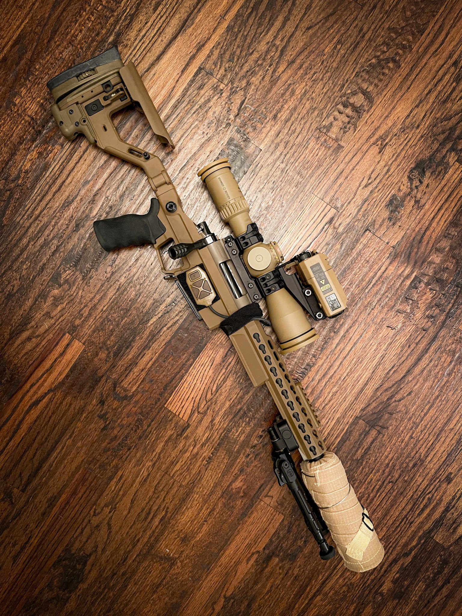

I’m running a Dominus CB on my Scar 20 and settled on a 130 gas jet. My load in Lapua brass is 43.5 Varget lot 5347, 175 Sierra and CCI 34 primer running ~2612FPS. This combo is turning out to be excellent.
