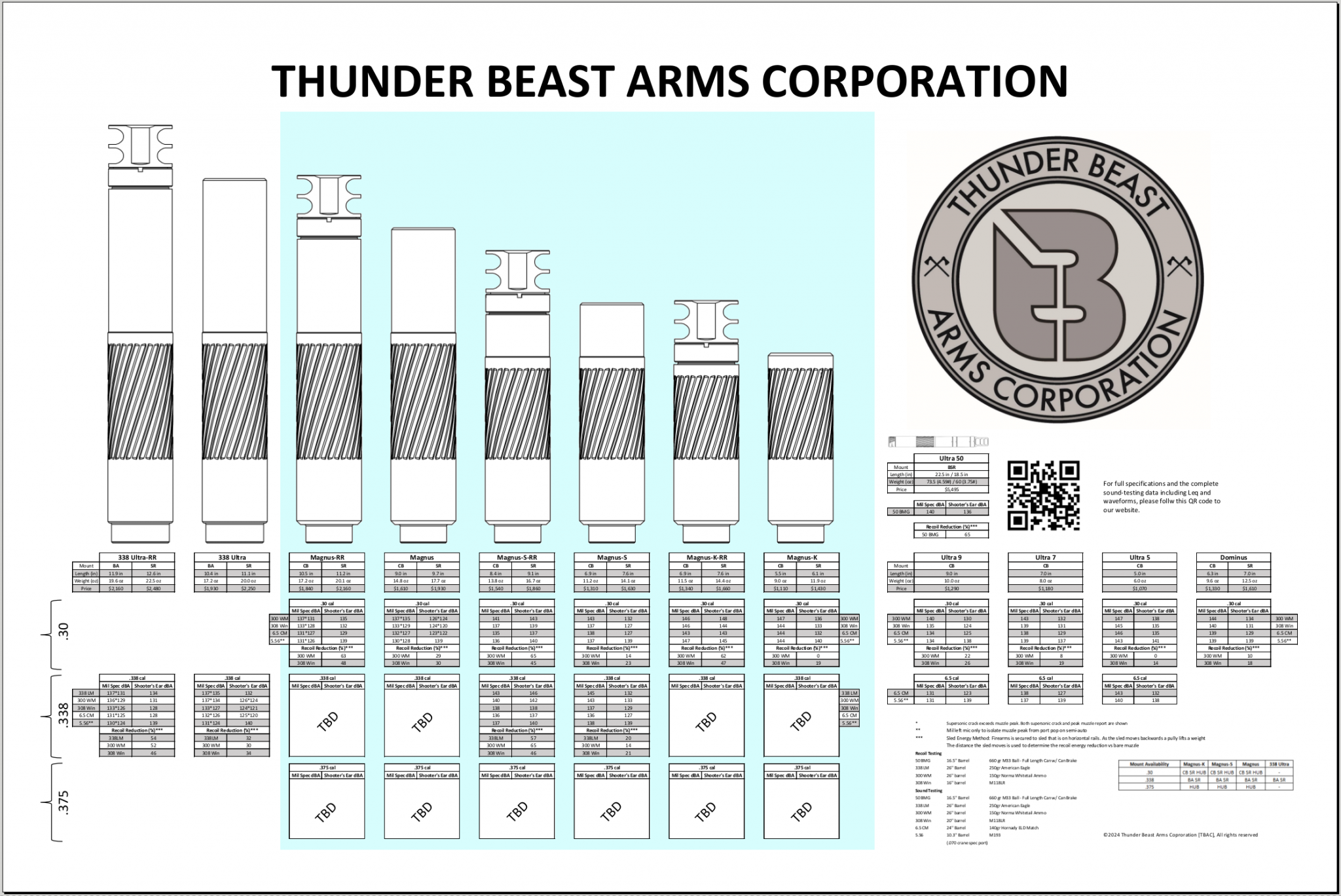

Yes, it is stronger.
Compare the minimum rated barrel lengths.
Dominus: 308-12.5", 300 Win Mag-18", 300 Norma-26"
Magnus: 308-8", 300 Win Mag-14.5", 300 Norma-16"

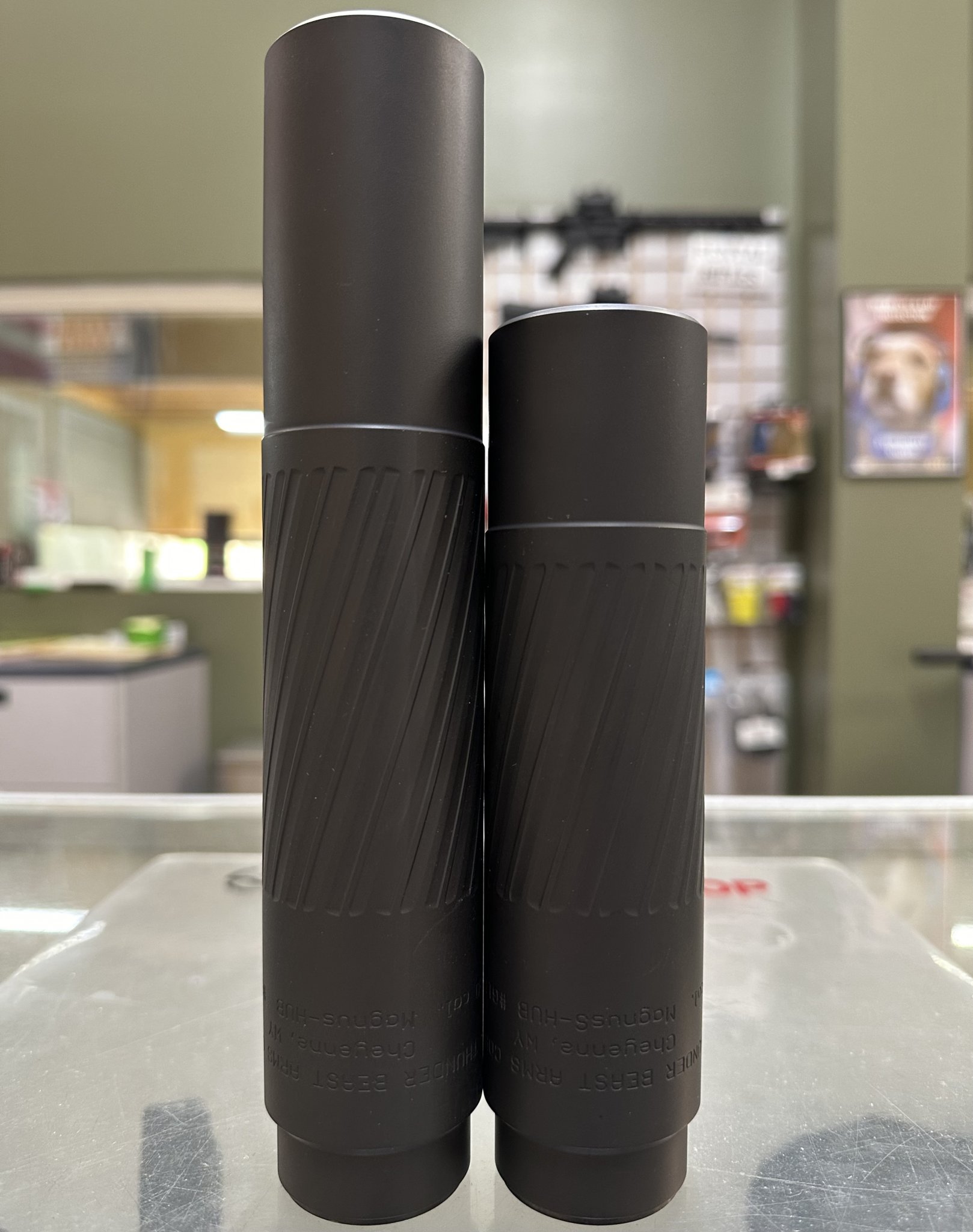

The last pic is my full-size Magnus vs. Magnus-S. Both are HUB models.
