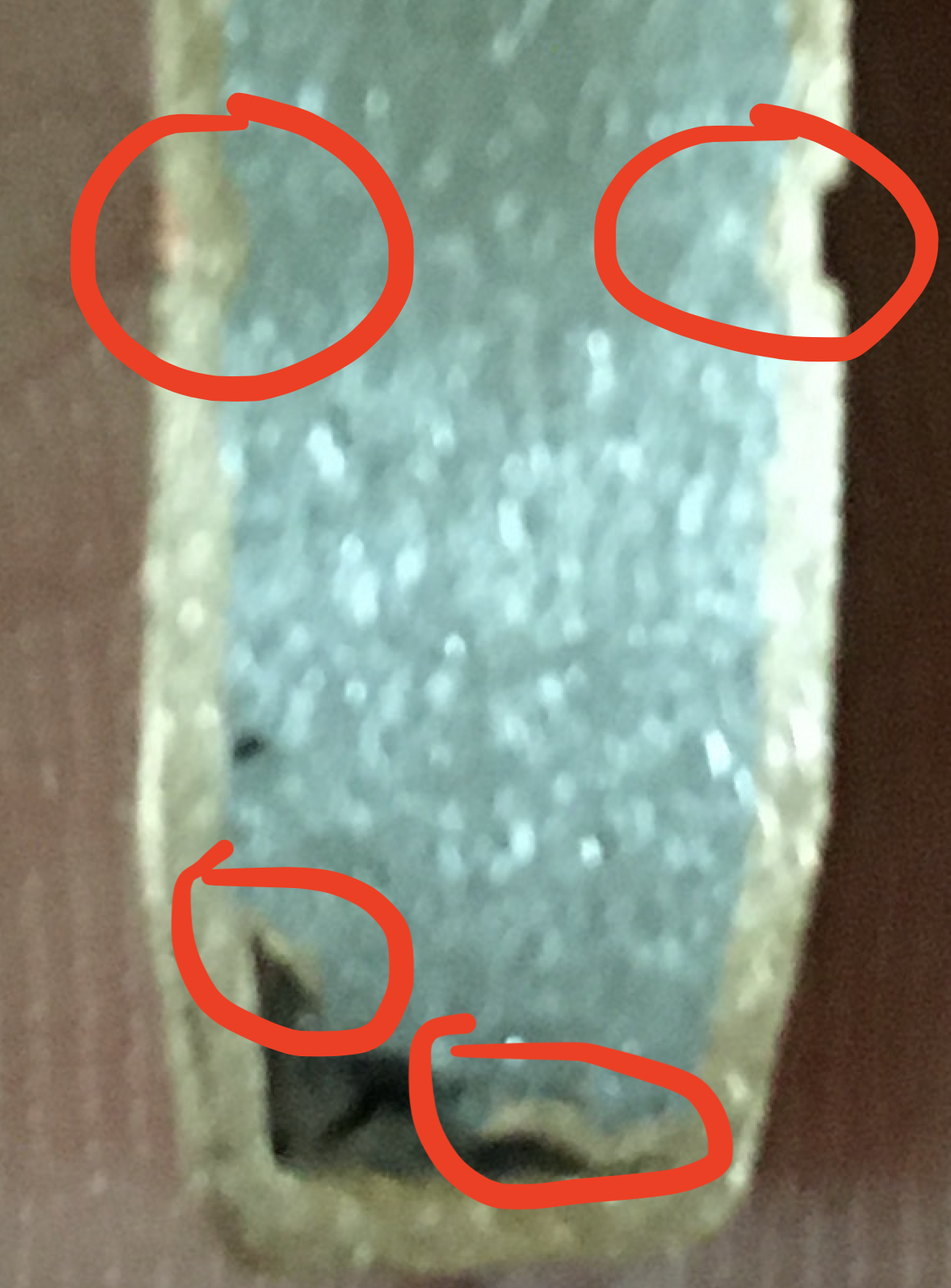

    I took my POF Revolution DI to the range with three different types of ammunition. a 147gr, a 150gr and a 180gr just to see how it handled each. With a 1:10 twist rate, I was expecting the worst from the 180gr ammunition and I was correct in that assumption. I went through 15 of 20 rounds out of the box and they were everywhere on a reasonably dialed-in rifle and I didn't even bother shooting the last five out of the box. It was that bad.
    The 180gr. ammunition was Winchester SuperX soft tip (180gr. as previously mentioned). I want to say the box was around $30 at Bass Pro. POF doesn't recommend soft tip ammo but I thought I'd at least try it as it was "on the shelf" and I wanted to see how it handled heavier bullets.
    Anyway, my enabling neighbor, who is an experienced, scientifically driven reloader, wanted to dissect the last five rounds. "Go for it" I said and gave him the remainder of the box. After checking every measurable parameter including grains of powder, he decided to cut the bullets themselves length-wise. And there it was. Voids in the lead core. That'll do it at 120,000rpm. So don't always blame the gun, buy (or produce) better ammo. Internet confirmation bias is a b*tch. Lesson learned.
    This is fascinating to me. How are soft point bullets manufactured? Do they draw the jacket and then pour lead in? Or are the jackets drawn around a lead slug?
    I'm hoping that jacket deformation is from the cutting process. When you can see the flaws with the naked eye in potato photos, you know it's bad.
    What's going on with the jacket at the bottom near that 'pocket'? That doesn't look right. Same with the cannelure. Apologies on the poor quality of the crop, the original image wasn't great when zoomed in. Click for more detail.
    The whole thing is also 'bent' in many ways, and has a lot of issues that would be major problems if fired in that condition.
    He basically said "it ain't easy to cut a bullet length wise". I'm sure some of the deformation you're seeing is from it being cut in half like that. We're not doing this with high-powered lasers :). I'll get more info from him tomorrow. I still have to file a "claim" with Winchester but he has the box and the lot number and I need that to completely fill out their online form.
    I'm sure he still has the bullets, I'll try to take some higher res photos too.
    Totally understand re: cutting. I've done my fair share of cross sections and you need a high speed cutter, and even still you'll have some deformation. Just wanted to make sure the bullets weren't like that stock, as that would have been brutally bad!
    I'm getting all the other information. He wrote everything down from powder grains to OAL, etc...Still has the box so I'll have the lot number here shortly along with when the ammo was manufactured. Just tough during the week with everything going on. The amount of powder was fairly consistent, nothing stood out. He knew which bullets to cut open based on weight. Out of the five left, several were lighter than the rest. Those were the ones halved. He used to be a member here, will try to get him to sign back in and share.
    This is very eye opening and makes me wondering if sorting bullets by weight has more merit than I had previously given it credit for. I wonder what would happen if you sorted them by weight and then cut them in half.
