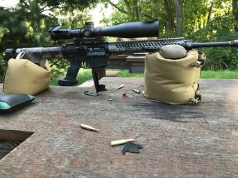

I was very lucky. First time shooting gun. Not good as gun malfunctioned.Fired out of battery!
Not a home build. Built by Tactical Rifles / David Rooney. I cannot comment as I am litigation. Sorry! BTW - 6.5 Creedmoor caliber.
Reactions: ddavis
There are only a couple ways it is possible for one to fire out of battery. 1. Cam pin breaks. 2. Barrel rotates in the upper reviver. I can't think of any others. I guess if the firing pin was way too long, it might be able to reach the primer, when the bolt was not in the locked the position.

Other than the issue with the builder/seller what has been determined to be the mechanical cause of the failure?
Something didn't work right.
Did a part break to cause this?
Was something not aligned?
Was there an out-of-spec part?

It fired out of battery. it appears that they installed an incorrect buffer spring.
