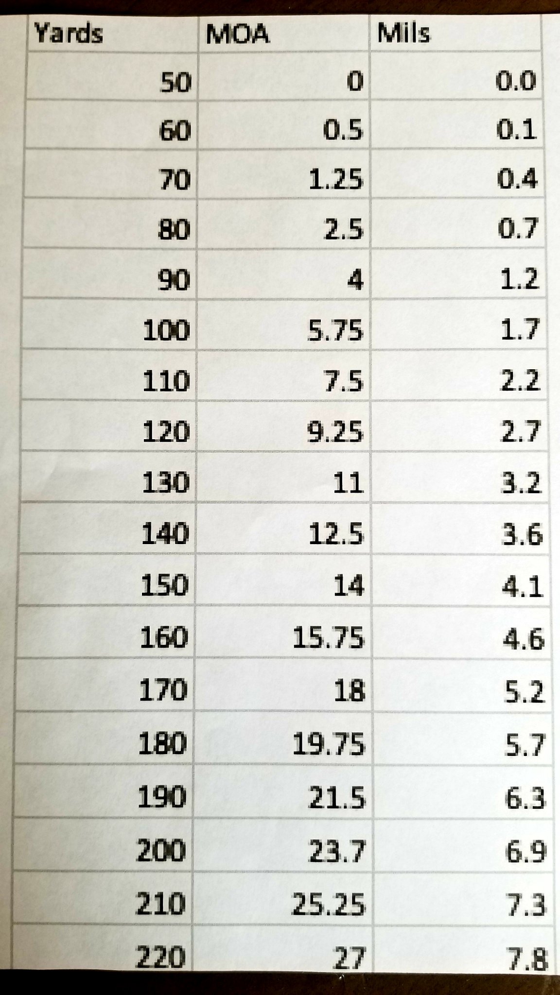

Some info for those interested.
Rifle:
V22, 18in Kukri barrel, 20 MOA rail, MPA full comp chassis, Trigger Tech diamond trigger. Vortex PST gen II 5x25x50 MOA FFP.
Environment:
Temp: 73-86
Baro: 29.90
Humidity: 42%
Winds: 060V110 at 2.4-5.2
Elevation: 127
Ammo: SK rifle match (red box)
Velocity:
low-1028
High-1083
Average -1057
Shots fired prone, heading 350 degrees with Harris bipod and rear bag.
DOPE: (yds)-(MOA)
50-0
60-.50
70-1.25
80-2.50
90-4.0
100-5.75
110-7.50
120-9.25
130-11.00
140-12.50
150-14.00
160-15.75
170-18.00
180-19.75
190-21.50
200-23.75
210-25.25
220-27.00
My rifle is identical to yours, except trigger. Same scope.
My average velocity with that ammo at similar temp/barometer/humidity is 1085fps. Elevation ~165 feet ASL, range heading similar to yours (almost due north).
DOPE is within 1/4 MOA out to about 150 yards. At 200 yards, I observe about 1.25 MOA less elevation required than your value (22.5 vs 23.75).
Some of this might be attributed to velocity difference... but the aggravation is in finding a BC that works from 100 to 400 yards. I need a higher BC to work past 150 - at "normal" rimfire BCs of .130 - .150, Strelok Pro gives me almost identical elevations to yours, and they are too high 200-300.
Rimfire. Voodoo. Animal parts/sacrifices, not the awesome rifle maker.
Had to convert it.
Makes sense. Probably a good starting point for most people.
Height over bore is about the only variable I don't see listed.
My scope sets 1.44 above bore. For my distance I used my Leica range finder and set a 100 yd plate then used a tape and set the other plates at 10 yd intervals. My tape is only good for 50 yards. My 50 to 100 yards was all taped.
