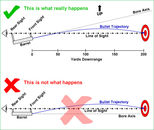

A 100 yd zero is much more forgiving since the bullet is reaching its apex for this shot. What this means is the bullet is at the zero elevation for a few yds before and after it passes the 100 yd distance.

That’s happening, sure but it also happens at other distances.
The bullet is falling immediately after leaving the barrel. Whenever we spin the turrets we are zeroing at that new range and creating the same basic concept.
The sole reason the 100 yard zero works so well for PR, is that the SOB angle needed at 100 is not too steep like a 25 or 50 yard zero that creates drastic hold unders, yet still close enough overcome most environmental conditions.

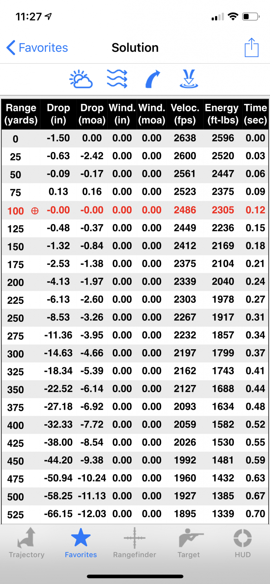

I’m still not really trusting the data though. I had to move +4MOA to go from 300 to 100. I can’t listen to the calculator and go -4.6 MOA to get back to 300. That’s too much.
I’m going to be 10 feet off at 1k yards :|
Maybe my chrono is a piece of shit. If someone has a lab radar tomorrow I’ll see if I can trade beer for a velocity check.

Scope is zero’d at 100 now. We’ll see how the match goes tomorrow.

For what it is worth, a tiny 1/8" offset from a dead centered zero = .12MOA, or .52" offset, a .5 moa issue at 300 or 1000. So you MUST account for your zero offset in the calculator if you have one.. most of us do.
1.3mils or abut 4.5MOA, is relatively normal for 300yards with a 308 in your velocity range with a bit lower station number (inHg). If your running 1/4minute scope don't get to caught up in the numbers you can not possibly dial for your down range solution.
Is your scope height actually 1.5 inches? That is what it says in that drop table.
I'll double check this. Its definitely very close to center. But awesome info. Thanks yet again! ALso I realized that .6 MOA is barely over 1.6 inches. Totally possible that the calc is right and I'm slightly high/low/have a missing offset.
Yeah its right around 1.5-1.6. Hard to get a perfect measurement though.
