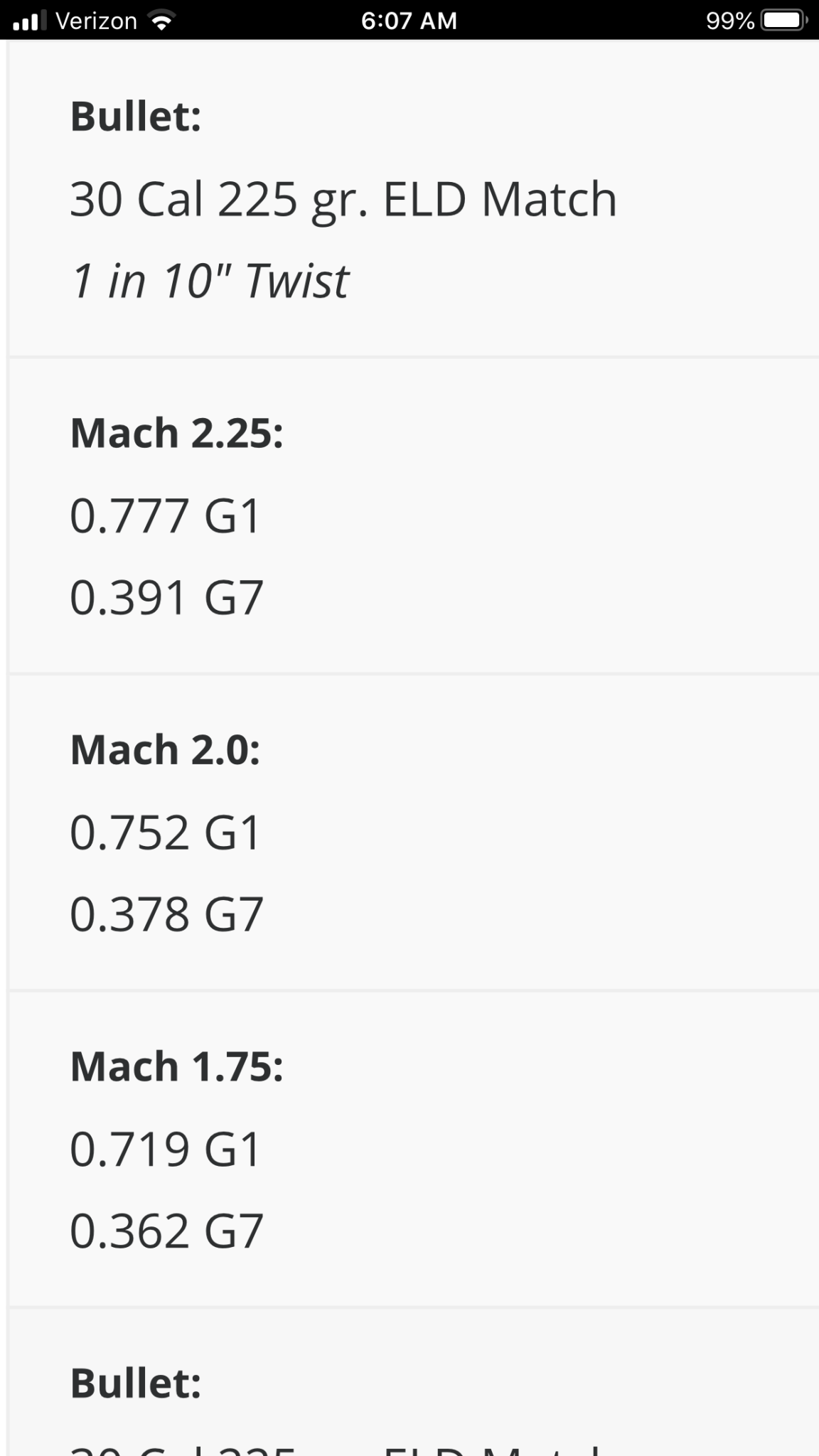

If you’re NOT using a custom curve and using a g1 or g7 BC then yes, you will have to change your Bc to match exact dope at different distance. Hornady has a pretty good example of different g7 scales per velocity range (mach) and how it effects their specific bullets.
Reactions: Raptor77

300 Win Mag 225g Hornady ELD Match over 66.3g H4350 seated .003 from the lands.
Well I’m not familiar with the 225 ELD m but I’ve had to adjust BC on 3 other ELDM’s.
I’d try these other BC’s they list for lower mach numbers.
Reactions: Seymour Fish
