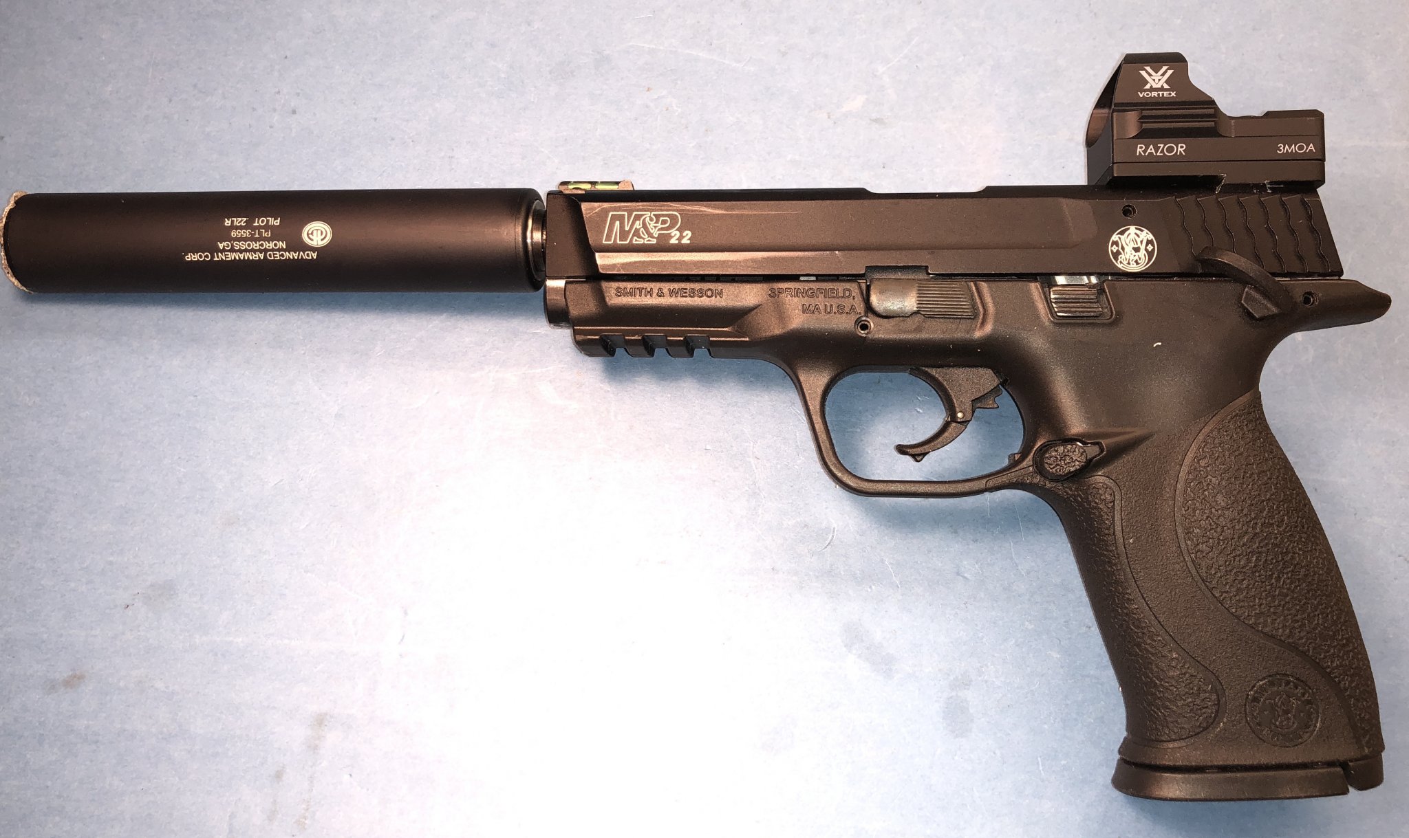

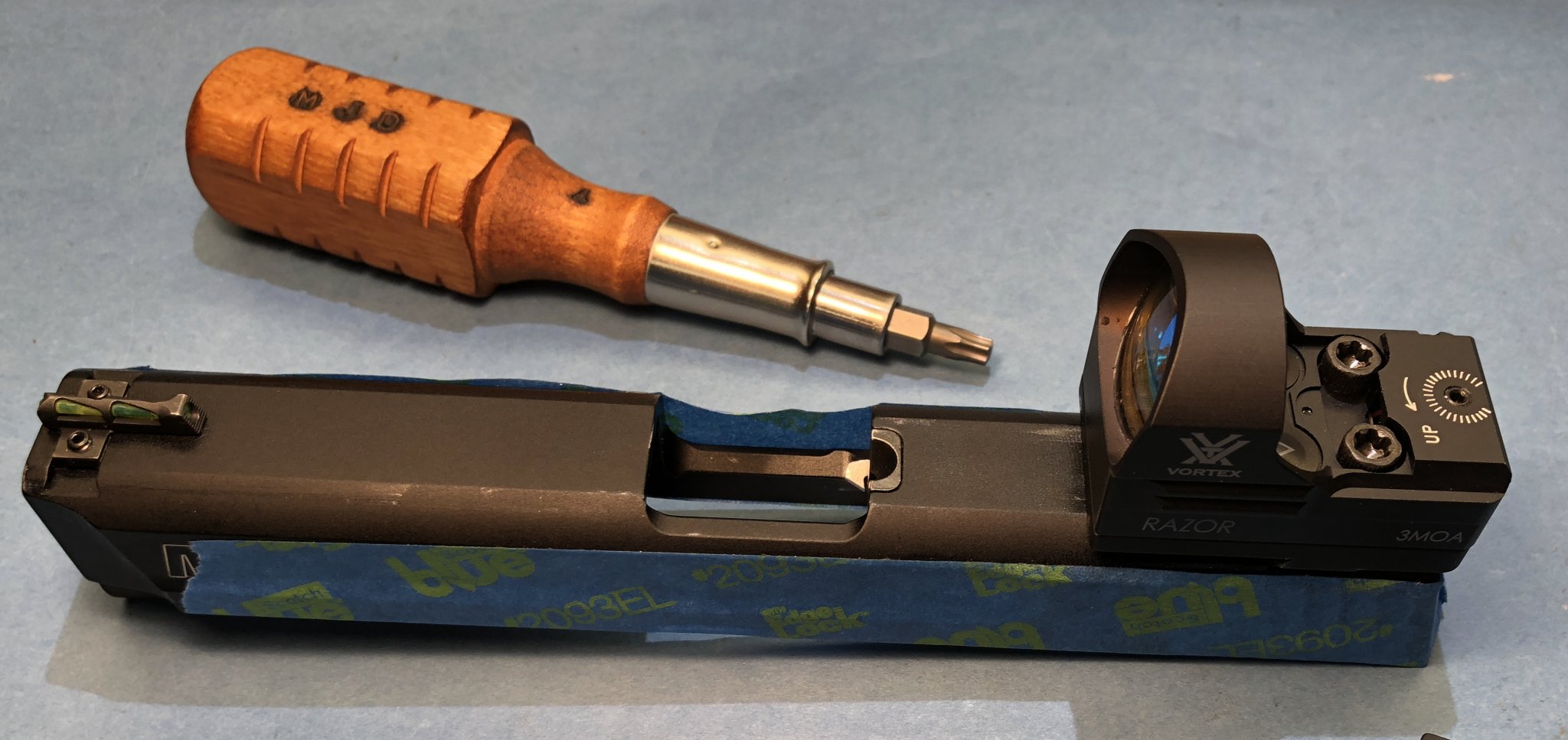

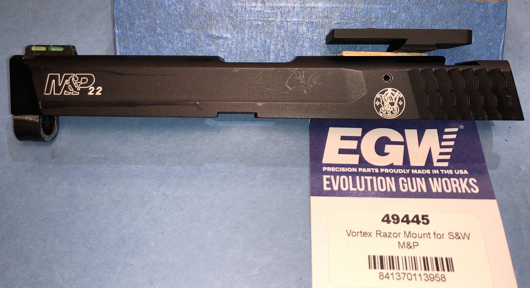

I prefer Trijicon RMR's on a milled slide for full size pistols, but for this M&P22 with alloy slide, not enough slide top thickness to mill out and flush mount the red dot. So, used an Evolution Gun Works dovetail mount for Vortex Razor and it works nicely for backyard varmints. EVG has dovetail mounts for Glock that will adapt to Venom or Razor model.
Obviously, the dovetail mount option obviates using BUIS; however, modern red dots are pretty robust.
