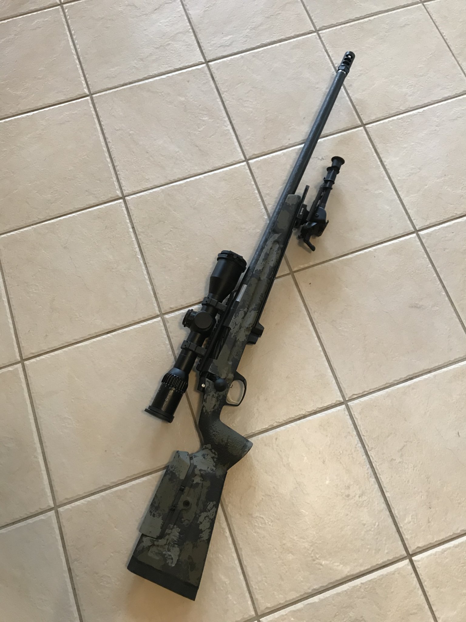

Twentyguns
Feb 2, 2019
4
6
Does anyone buy a 3k+ scope and mount it on a hunting rifle? I'm looking for a major glass upgrade to a titanium 7MM. It had an IOR Flea FFP on it for a long time and it was a great scope at the time, but sold it...and is now sporting Vortex HS SFP. I'd like to upgrade the glass and short of the Tangent, get the best glass, clarity/res, tracking, light gathering possible. Higher mag swing means I can pick out antler detail on a buck even if I left the spotter in camp.
I'm okay with FFP if, like the IOR, you can see your aim point at low mag, or if its illuminated. Primarily for western hunting deer and elk but like to practice out to and beyond 1.k at the range. Hard on gear and not enthused about carrying a cinder block made for the bench on my 6lb daily driver. But, aside from tapping steel, what are the thoughts on usefulness of maybe a ZC 4-20 or even their 5-27 since they are so close in weight for being at home on the range in the mountains?
Yep - did search but found little - given site title on dual application for the high enders.
Considered
Zero Comp 4-20 and the 5-27
Minox ZP5 5-25
March in ffp and sfp, similar power - was 3-27 I think
Kahles
S&B ultra short
and if I won the lotto - or was interested in Dead-vorce... the TT is what i would probably get.
Thinking ZC or Minox at the moment...
But if I'm going to spend more than 3k... buy once cry once thing for this one rifle... is anyone else crazy like me and thinking of putting all that PRS grade glass on a rifle that's going to wish it was punching paper? Running one of these higher end tubes for a hunting rig? I don't baby anything either.... it goes and gets used. Think they'll stand up... weather, over mountain - hill & dale or best left on the range rack?
Reactions: CSTactical
