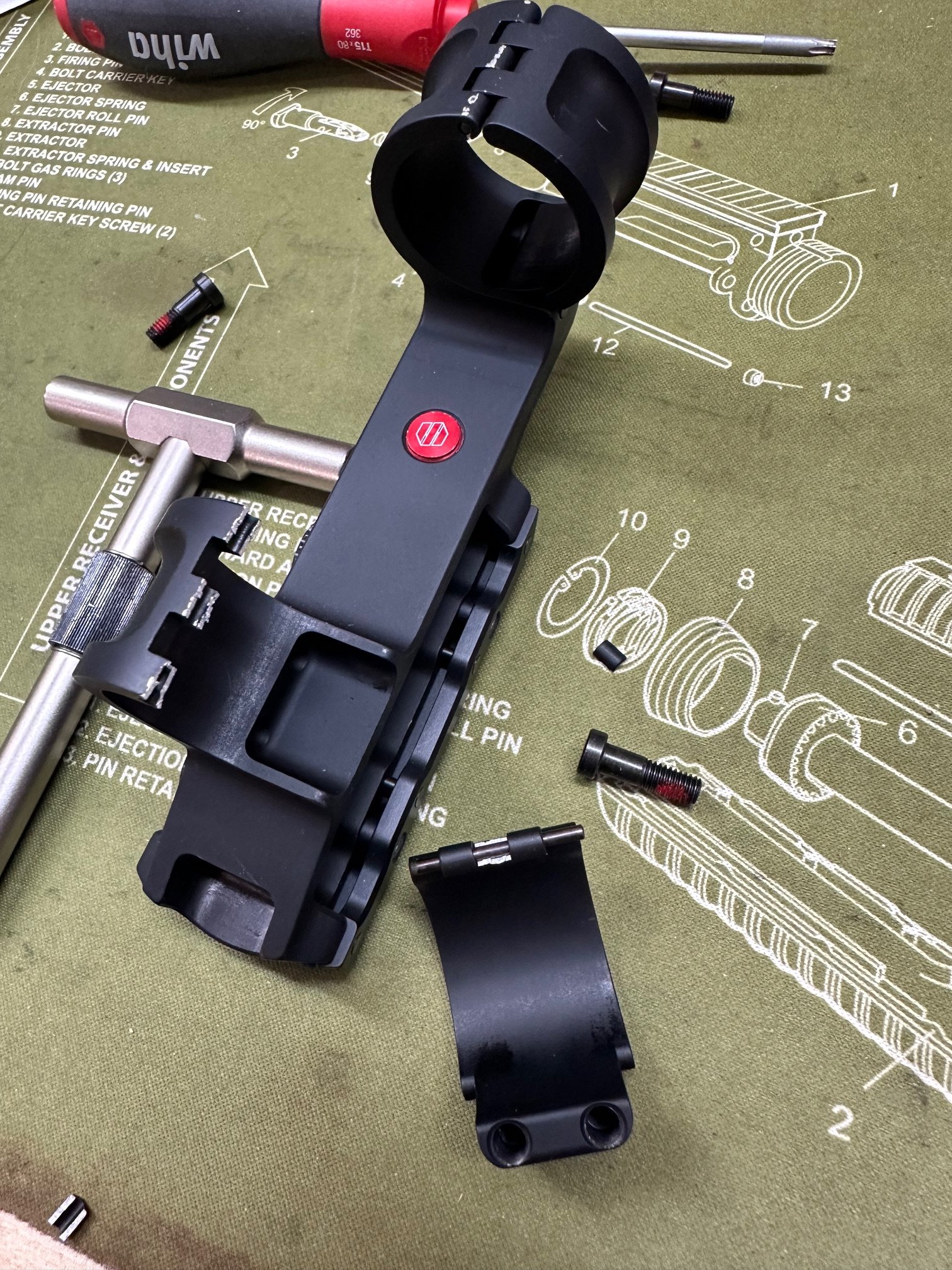

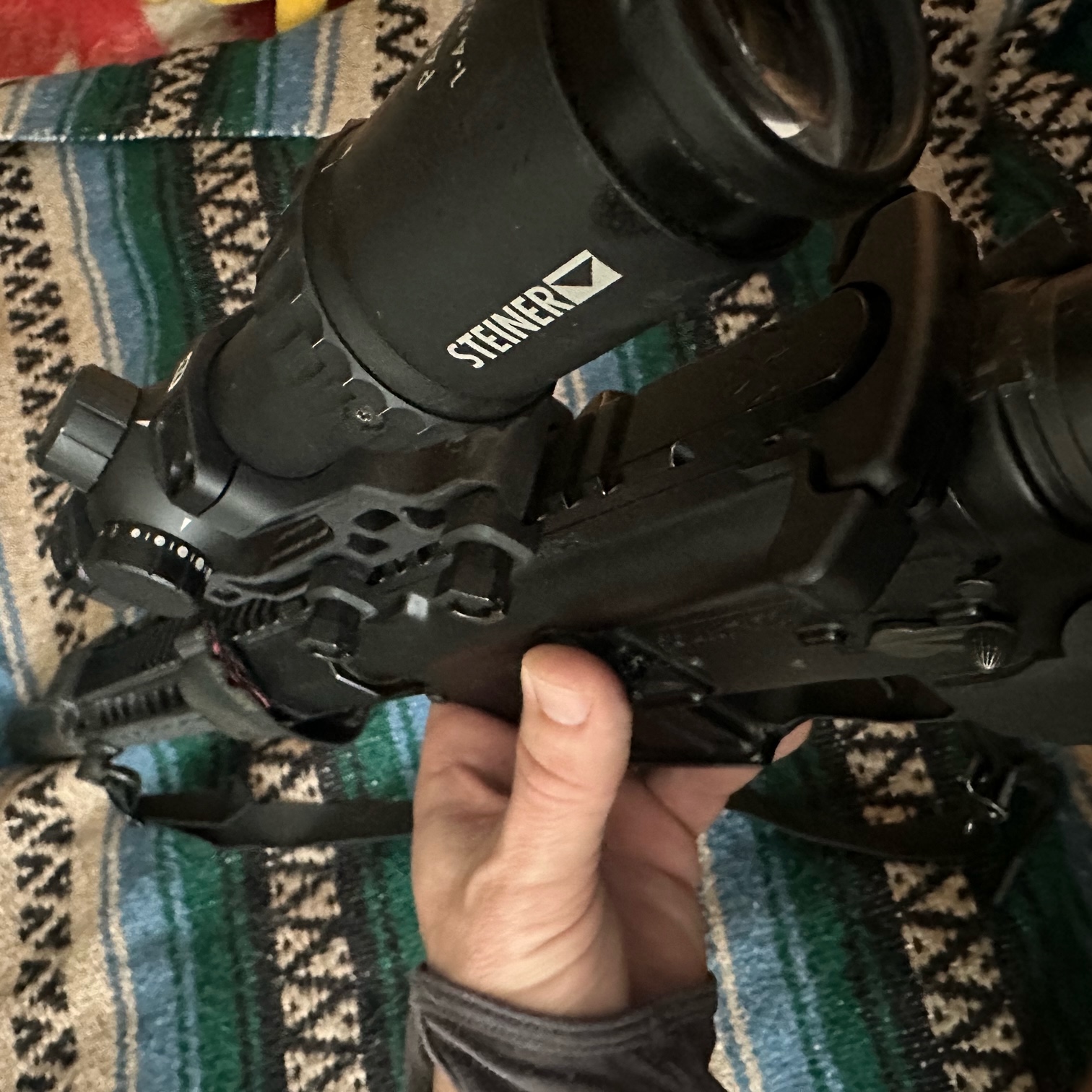

I was doing some scope shuffling yesterday, and while removing my Steiner P4xi from the Scalarworks mount, the mount kinda crumbled like a cookie. This is the second (and last) time a Scalarworks mount broke at the hinges on me. The front hinge is about to go, as well. This was not a hard-use set up and I never over-torque. Contacting Scalarworks tomorrow.
The first failure I had was on a brand new, just out of the box mount. The hinges failed as I was initially zeroing my LMT.

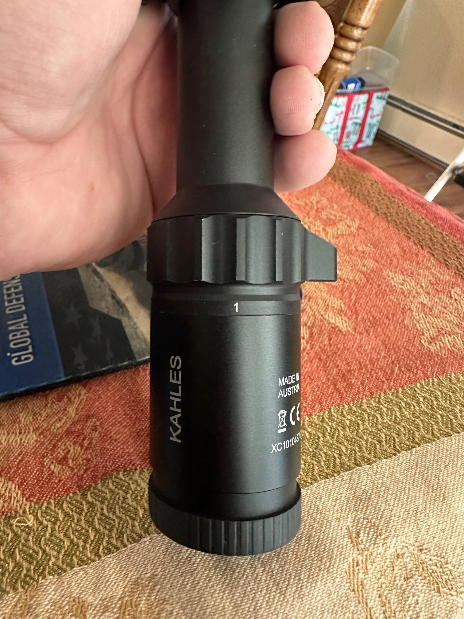

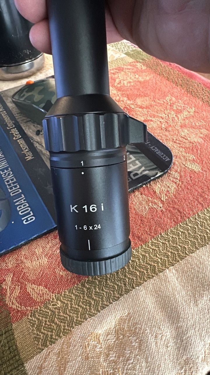

The other scope and mount I was doing swaptronics on was a Kahles K16i in a Badger C1 mount. I planned to put the Steiner in the Badger mount and sell off the Kahles and Scalarworks (well, just the Kahles now) to fund some recently purchased glass. As I'm removing the Kahles, I observe the "1" on the throwlever is not aligned with the dot on the eye bell. As soon as I grab the eye bell, it is loose. I turn it to tighten it (gently, not cranked) and here is how it aligns:
Almost 180 degrees out of whack. Look at the gap when I have the dot aligned with the 1:
So now I need to contact Kahles/Swaro tomorrow, as well.

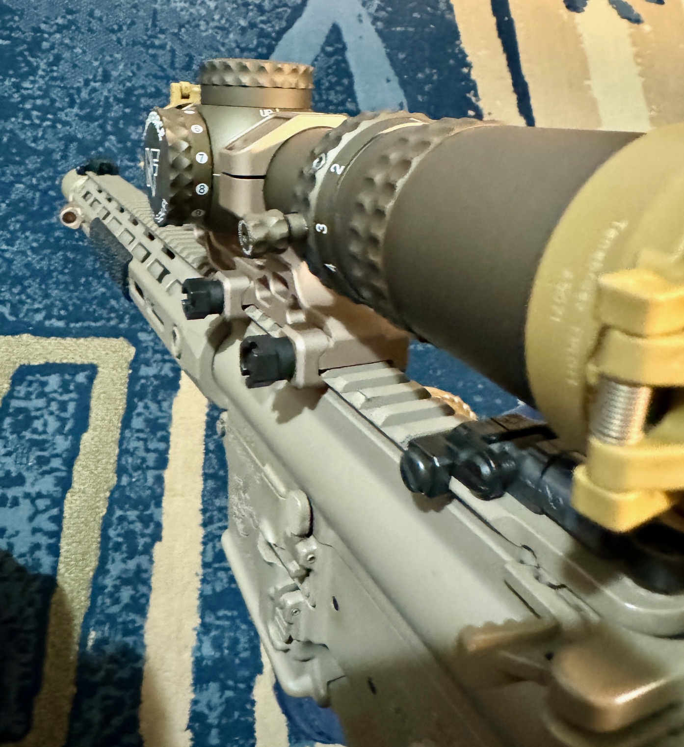

Badger C1 look great, other than the cross bolt heads that stick out. I like their modular socket system for add-ons and the design appears to be built like a tank (the Badger standard), just wish they had a more flush cross-bolt design. I’ve been really close to pulling the trigger on them. I bought a Leupold AR 34mm mount for my .260 gasser recently instead.
Do you dislike the cross bolts because they stick out too far for your liking (snag stuff) or because they interfere with your bolt release technique (slap the side of the receiver vs. pressing with thumb)?
I don't mind the cross bolts sticking out a bit. I've never had an interference issue. I like that my Badger C1's are cranked down for dear life with those beefy bolts and 1/2 nuts.

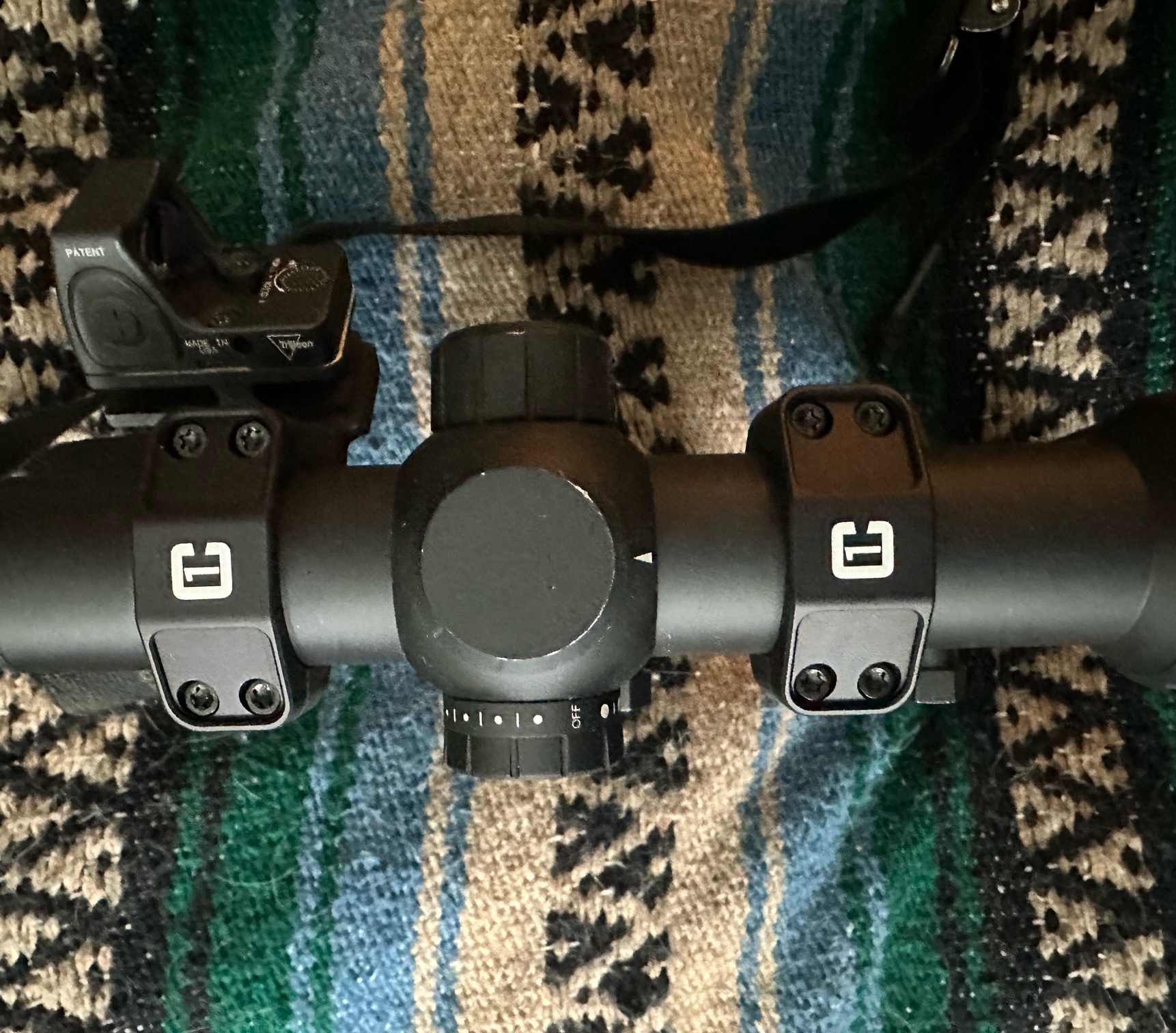

I don’t like additional snag hazards and knuckle busters. I don’t slap the bolt catch, but use my thumb instead. Maybe the picture makes it look worse than it actually is. It would be great if the left side bolts were flush with the rail clamps. Everything else is excellent with it, namely the lightening cuts, modular slots, ring design, double recoil lugs, coatings, and options for height, ring sizes, goose necks, and colors.

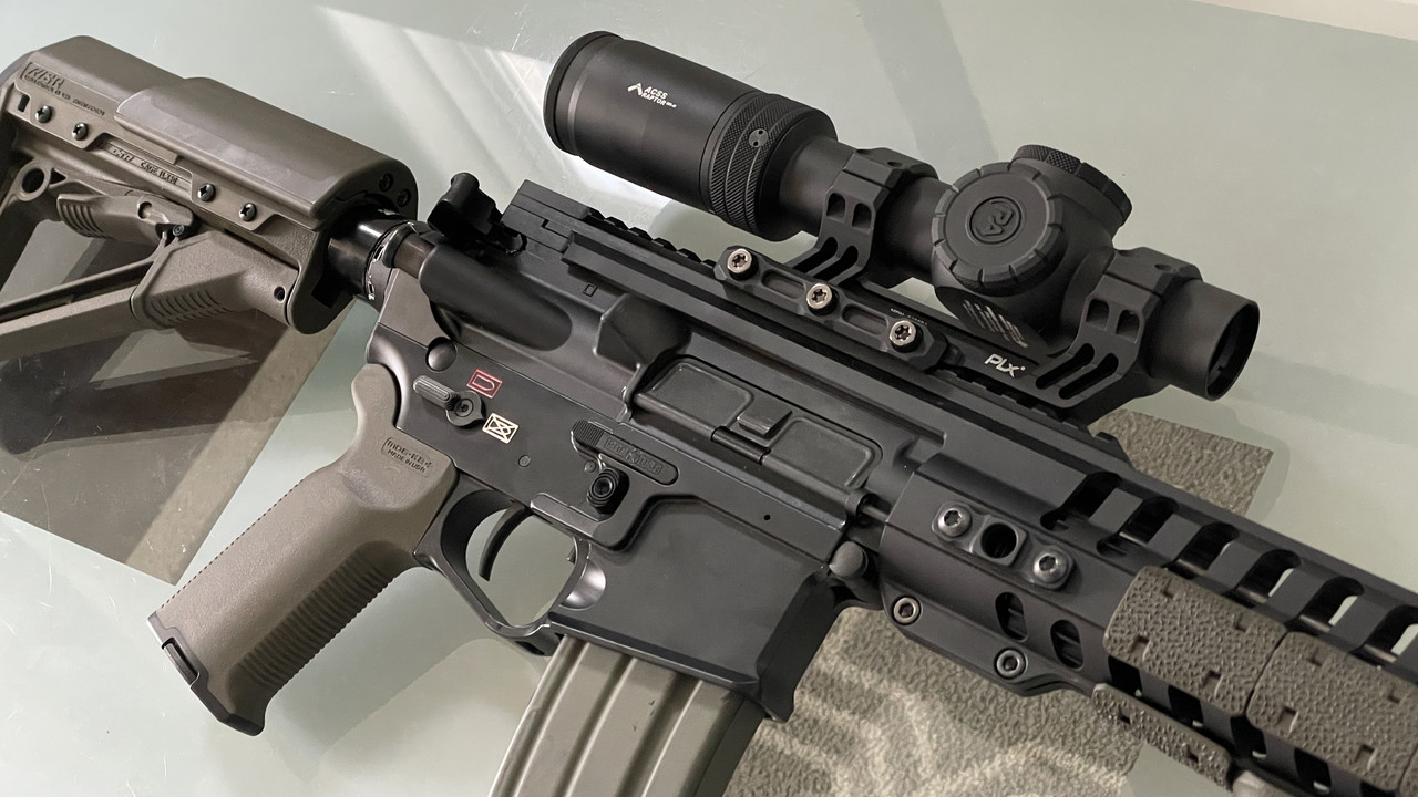

I'd also check out the Primary Arms PLX mounts. Made in the U.S.A. and very, very lightweight, about even with the Scalarworks. Well machined with some of the best cross bolts/nuts I've seen. And they cost a bit less than most of the other big names.
It doesn't. I have one but lacks in other areas. I also have the real deal and my first one, the old hinge design, did the same. The new one has held up exponentially longer on my 308 gas gun and no issues whatsoever. So the new version is good to go. I really wish they'd change the texture on the click drive wheels as they're downright painful on the digits when tightening them. Switching to a simple knurling would be much preferred.

The design of that Scalarworks mount seems to leave a lot to be desired as far as strength is concerned,
that hinge looks very weak and I am not surprised that it failed.

My Kahles scope was received at the US office in Rhode Island and a case number assigned. We'll see if it has to go back to Austria for repair. Supposedly, they will send email updates on progress.
Reactions: simonp
Just got my K16i back from Swarovski/Kahles. I shipped it on 9 APR and received it back 27 JUN, so 11 weeks and change door to door. That puts the time estimate right in the window of 10-12 weeks.
Along with my reported issue, they went through the whole thing and it seems like I pretty much have a new scope other than the housing, so fantastic customer service from Swaro/Kahles.
