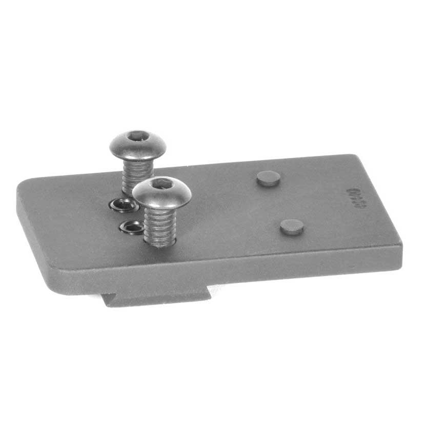

I just recently picked up a Rossi Gallery pump .22lr. I can't get it to shoot better that 5 1/2" high with the factory Buckhorn sight. I was only shooting at 25 yards. It has the rimfire dovetail groove on top of the receiver. Rossi makes a plastic picatinny base that will fit it but I would rather get a metal base over the plastic. Does anyone know of a metal dovetail to picatinny base for a rimfire rifle?
The dovetail is there for scope rings. A pic rail is redundant and will look dumb.

Romeo what?
If it's a Romeo 5, it uses the Aimpoint Micro footprint and Aimpoint makes a very low Micro mount for 11 mm dovetails. Thats how i have my Romeo 5 mounted to my CZ 452.
It's not an exact fit to a 3/8 dovetail but it should work good enough.

It's not an exact fit to a 3/8 dovetail but it should it is the Romeo 5.
Thanks for the heads up in the Aimpoint mount. I will look into that.
