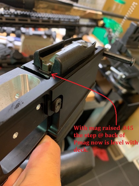

@Iron Worker - Here is another easy test for bolt over ride issues. For DPMS this should be checked.
Open the upper and slap a p-mag in. That little step/shelf at the back of mag picture below should be damn near level with the top of the lower.
If it's sitting low you'll be chasing your tail trying to get it to function reliably.
There's something like .050 height variation for the mag catch across 3 different lower blueprints for large frame DPMS. The one pictured was in spec, but on the low side. Absolutely nothing would fix the intermittent bolt over-ride. Once the catch was raised to the high side of spec nothing I've tried will make it malfunction. Any ammo, any mag with functional spring it eats it like a wood chipper.
