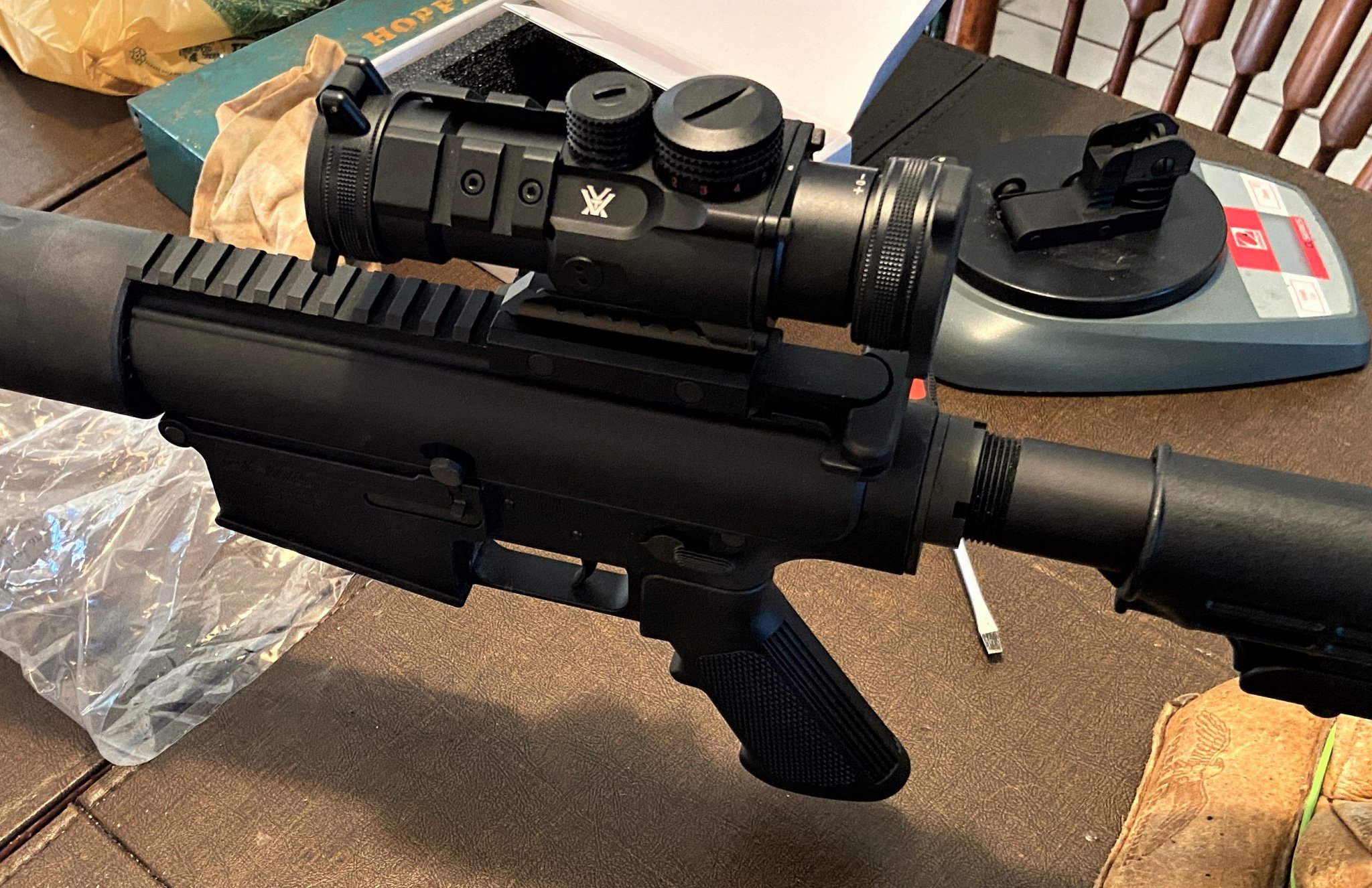

I recently lucked into a 1st Gen LR-308 DPMS AP4 that appears to have been sitting in a closet unfired since purchased new.
I mounted up a Vortex Spitfire 3X Prism Scope and am impressed so I also have a Magpul ACS-L stock w/ .7 Enhanced Recoil Pad on the way as well as a Precision Armament M4-72 Severe Duty Muzzle Brake but definitely want to swap out the stock charging handle for something more robust with increased leverage and functionality.

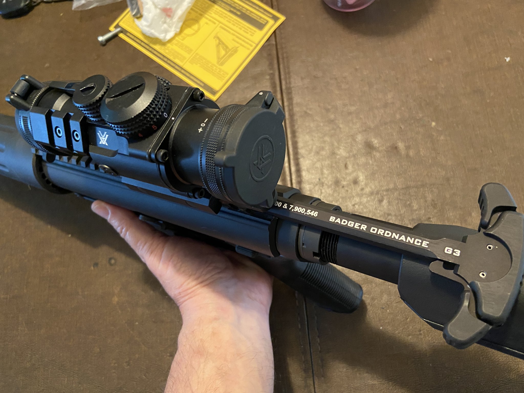

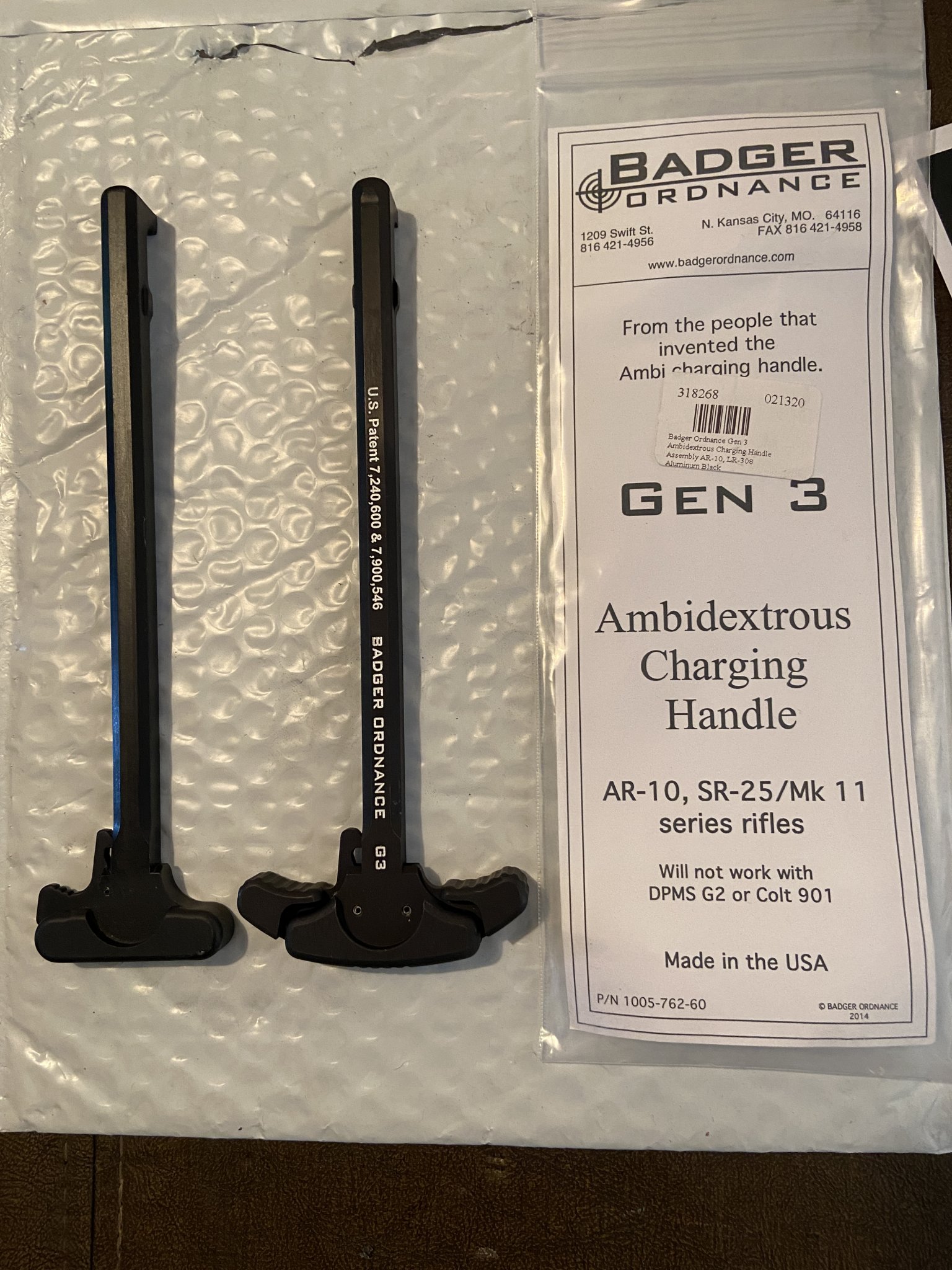

Thank you (and to all) as I just bought the last Badger Ordnance G3 Ambi Charging Handle Midway USA had in stock.
They all look cool and I'm sure they all function just fine as well but the Badger?...thanks again for bringing it to my attention because as soon as I saw it?...to me it looked cleaner and more in keeping with the theme of things on my LR-308 AP4 and when I saw there was only (1) left in stock?...I jumped! LOL!
Thanks again. :)

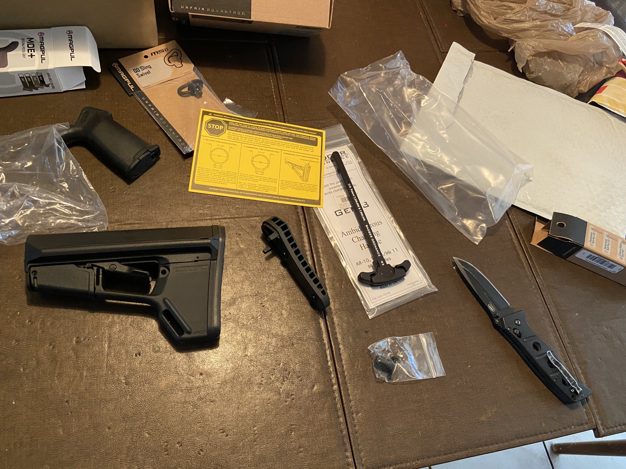

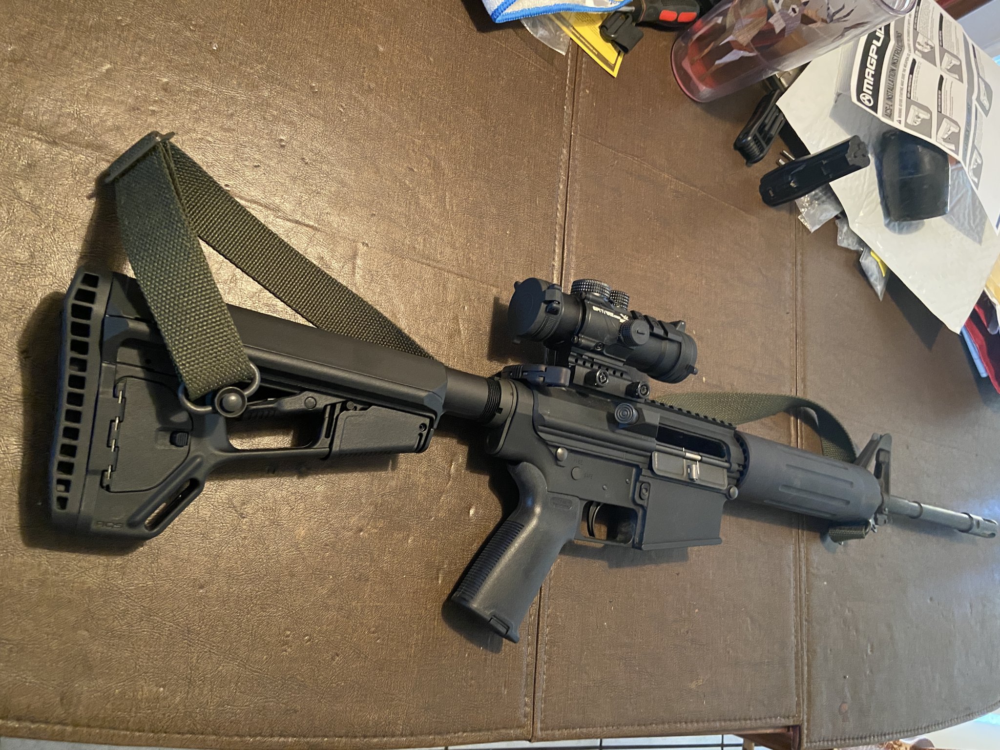

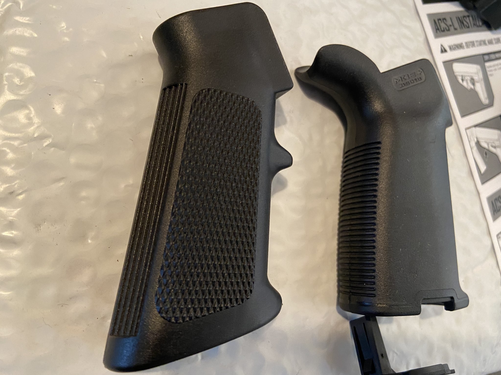

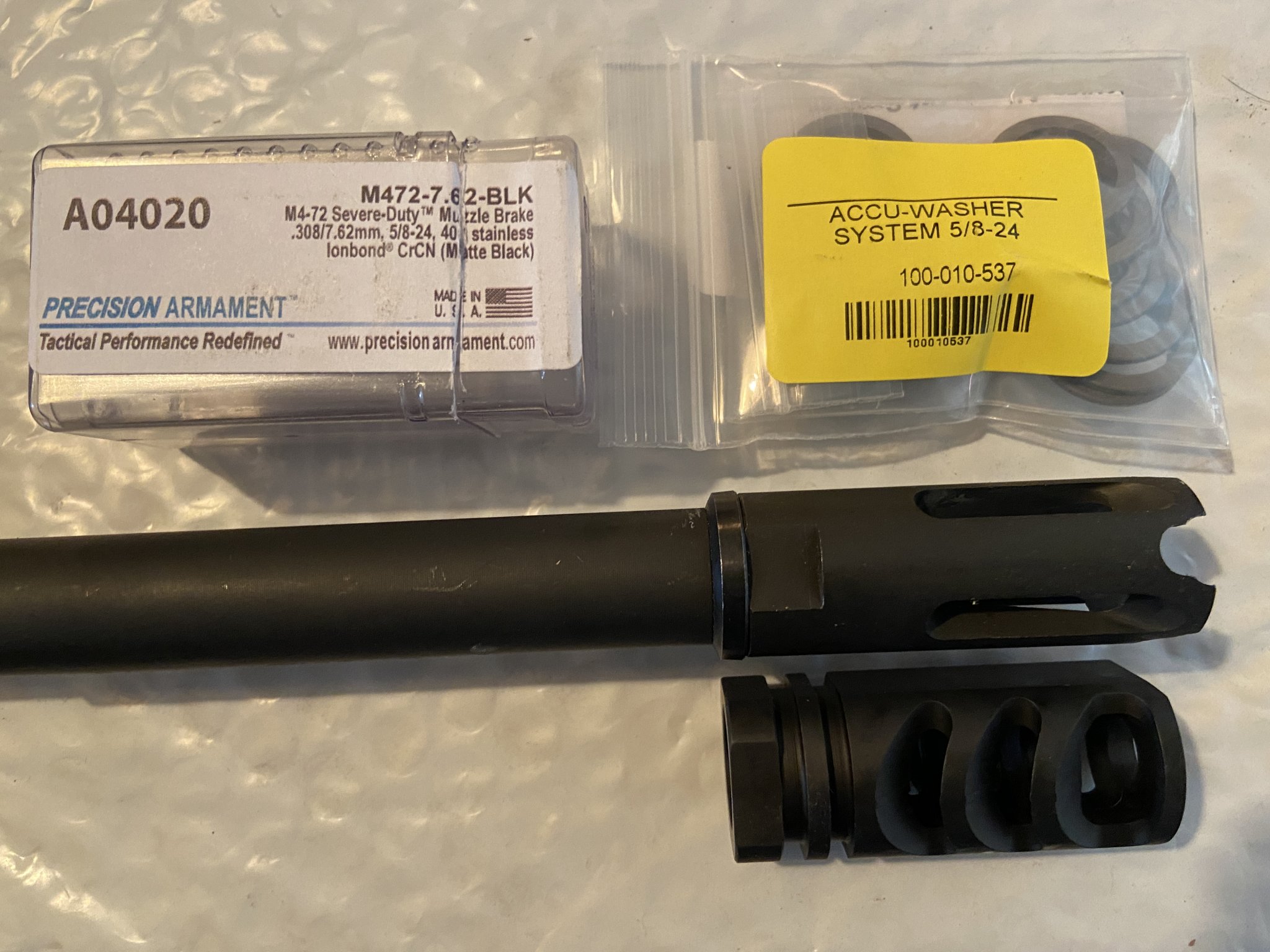

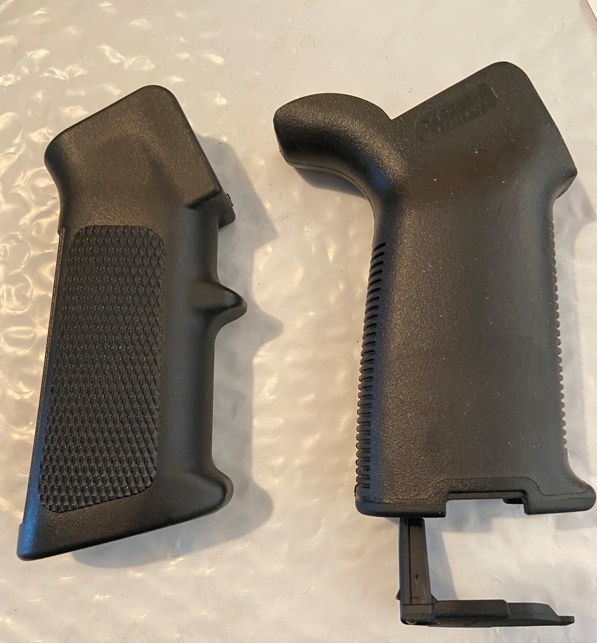

Everything except the Geisele SSA-E trigger from PSA came in today which was the Magpul ACS-L Stock w/ Enhanced .7" Recoil Pad along with the Magpul MOE+ grip, The Badger Ordnance Gen3 Ambi Charging Handle and Precision Armaments M4-72 Comp/Brake w/ Accushim Kit and I'll let the pix tell the rest of the story...

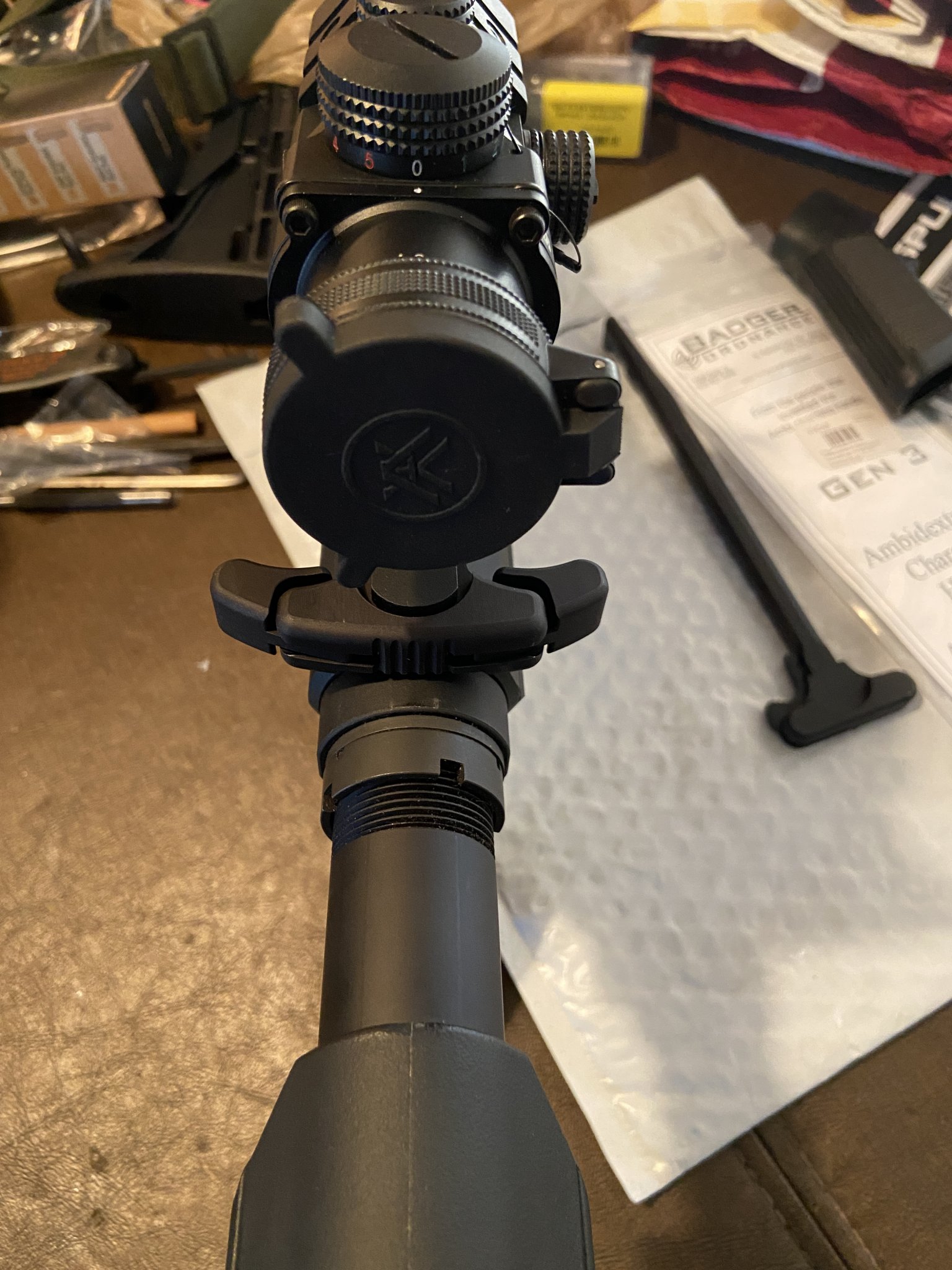

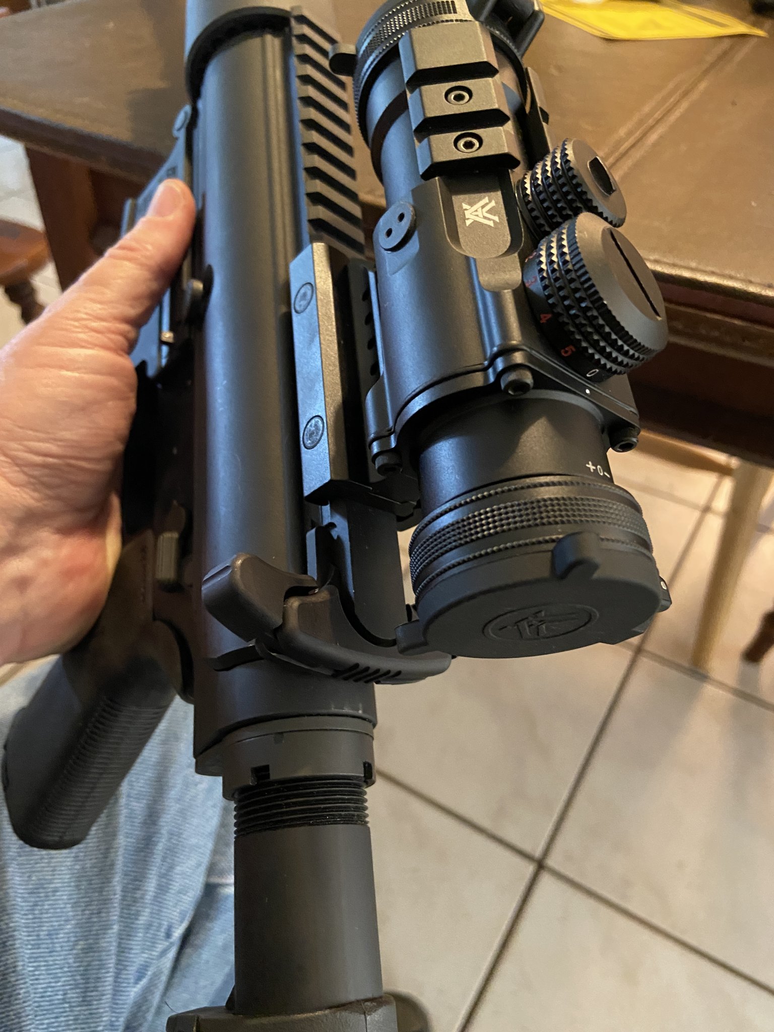

I've shot a few rifles where gas blow back was an issue but this DPMS LR-308 AP4 is not one of them and I obviously have no intentions of supressing it but the problem I did have was snatching the stock charging handle out from under my scope...that's entirely resolved and I can rack the BCG with ease now.

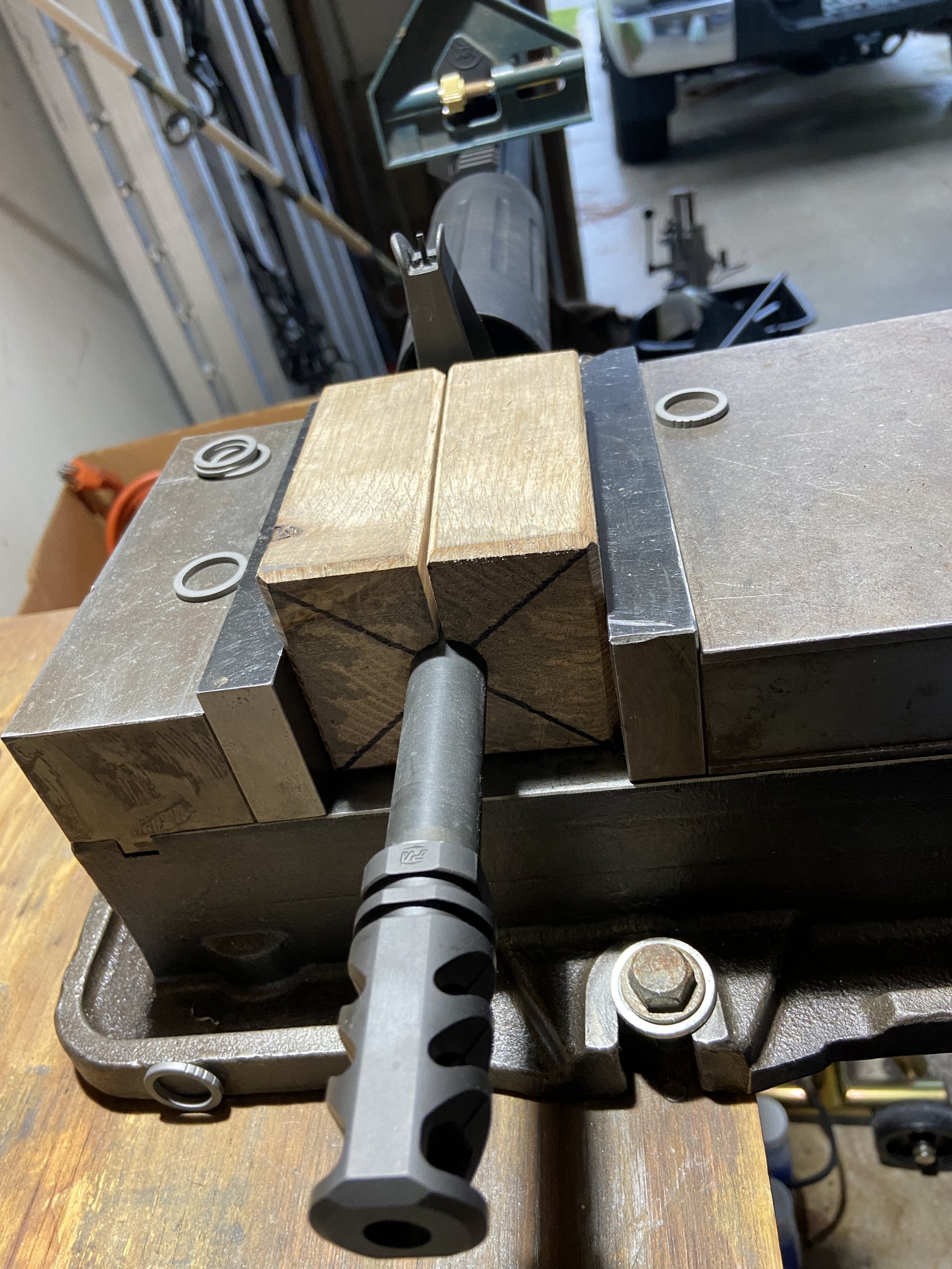

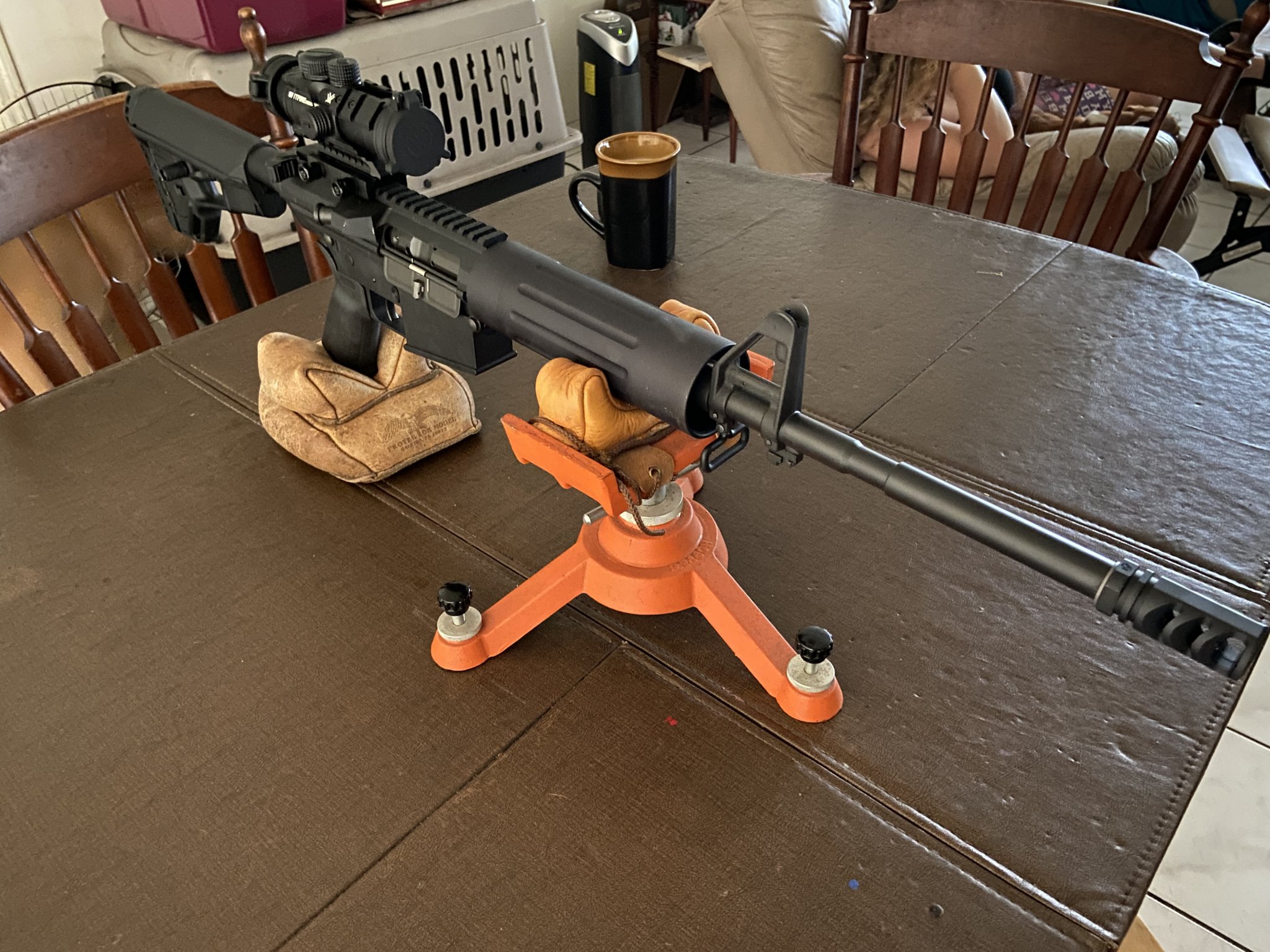

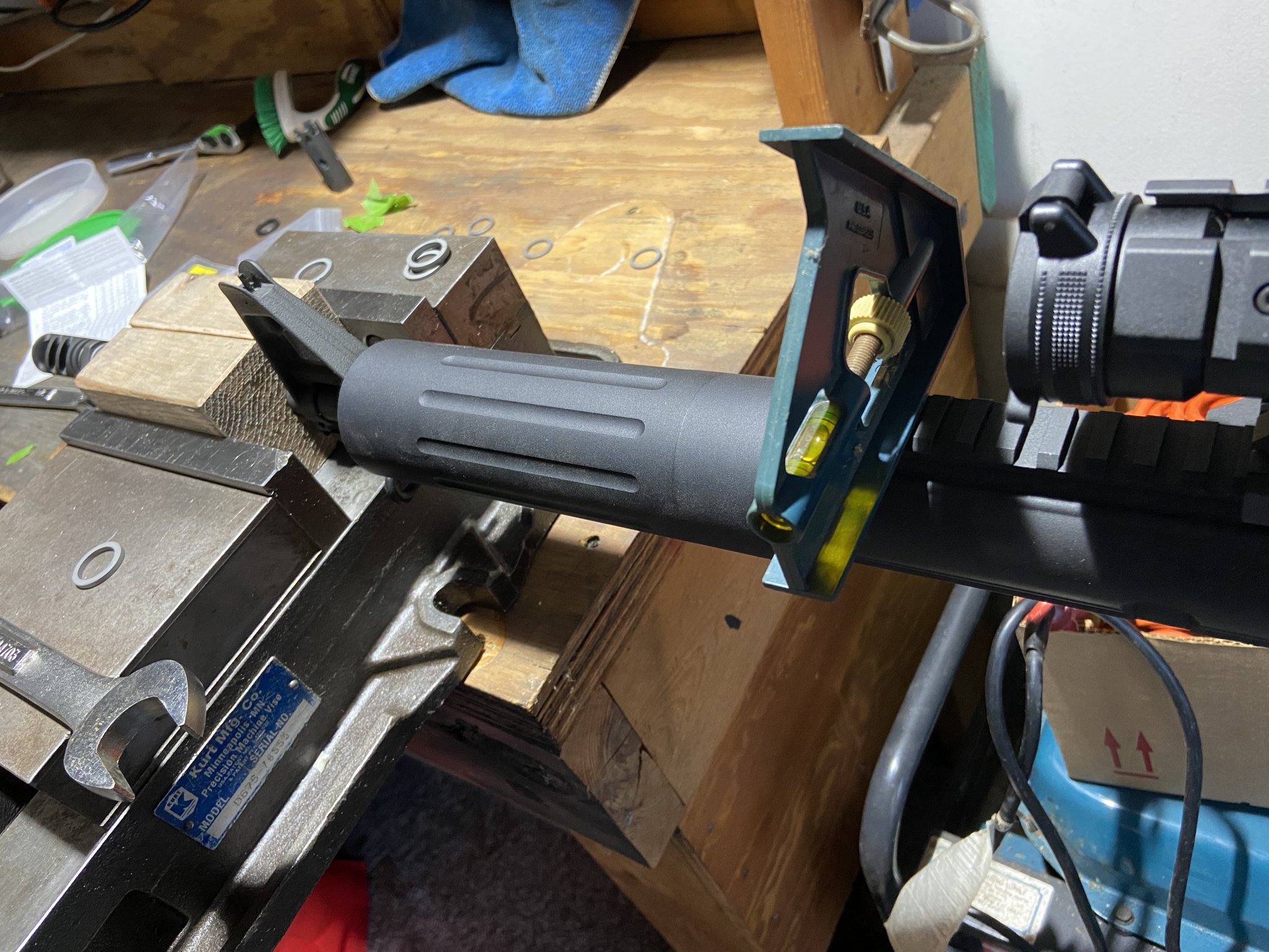

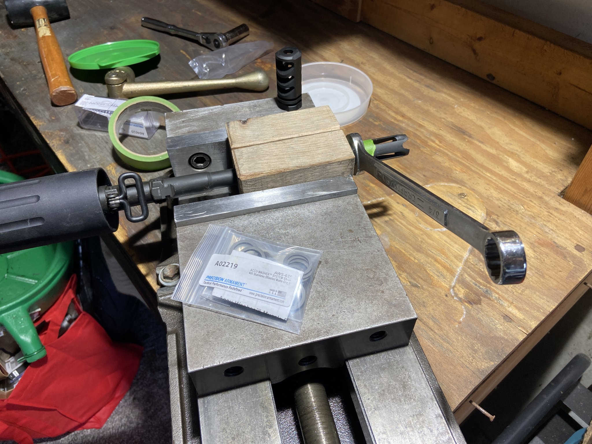

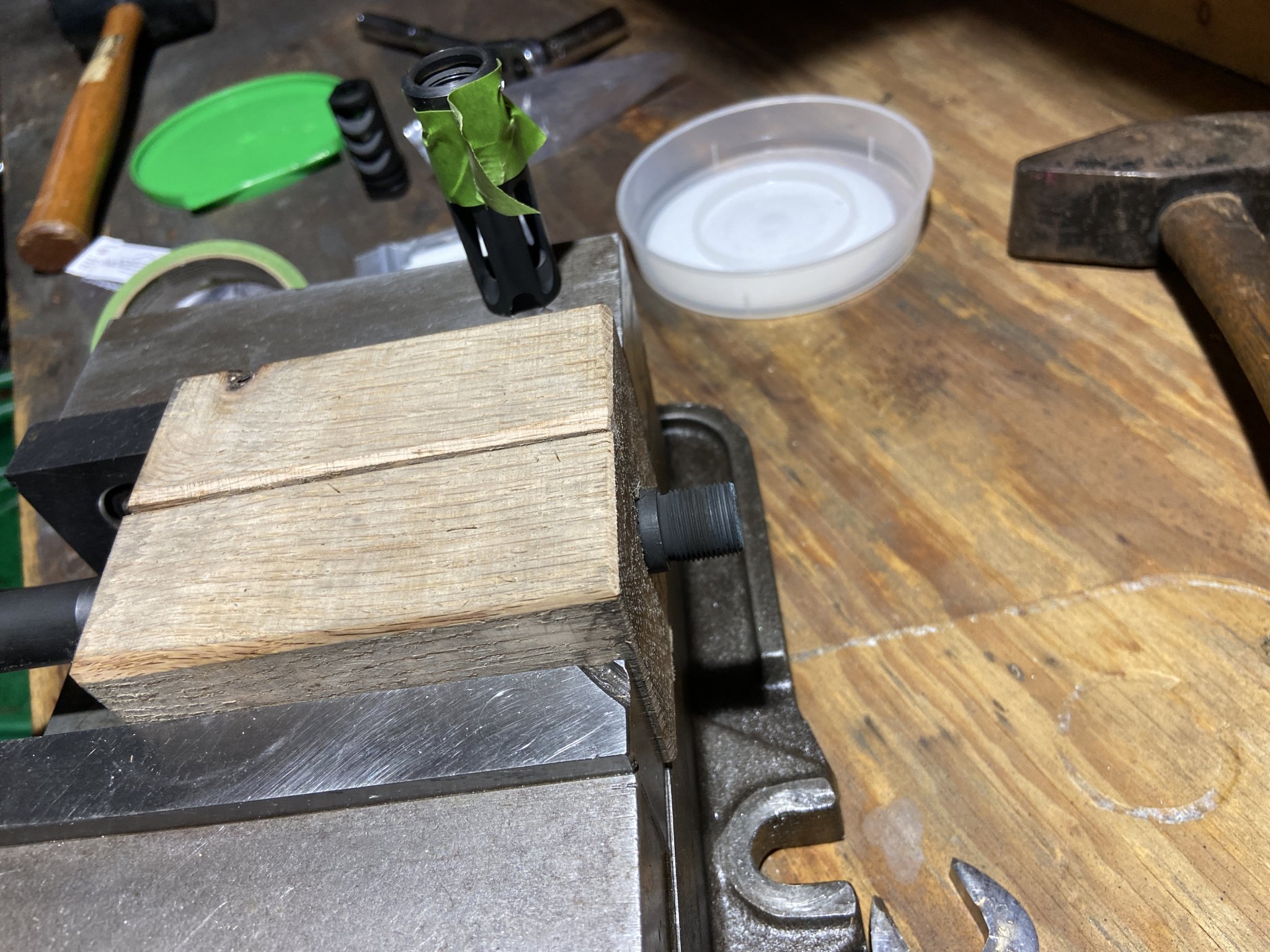

Here's some pix of the comp/brake install...I bored a barrel size hole in a block of oak and split it in 1/2 for some soft jaws in the vise and leveled out the upper receiver so I could then level out the muzzle brake for proper alignment.

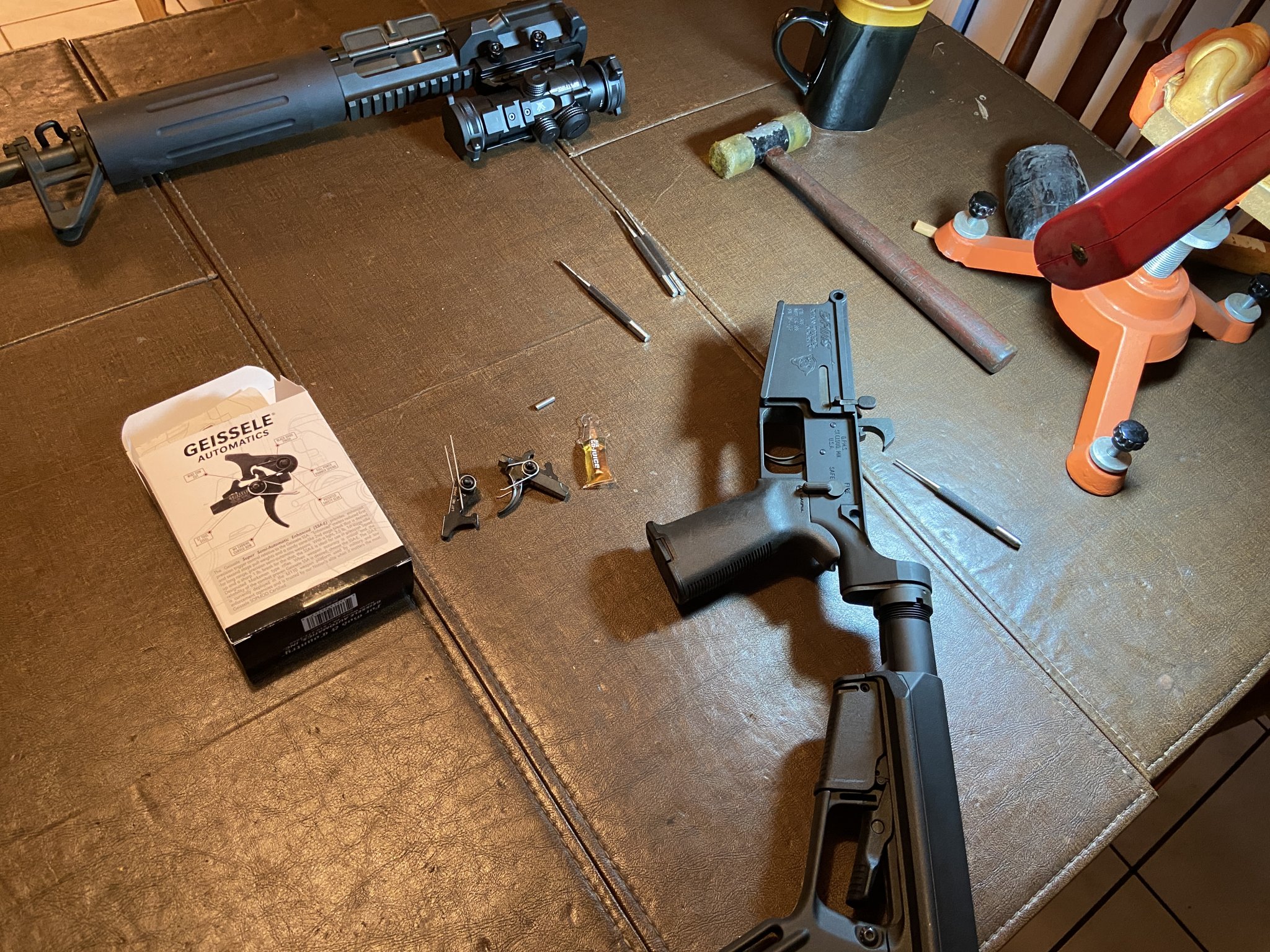

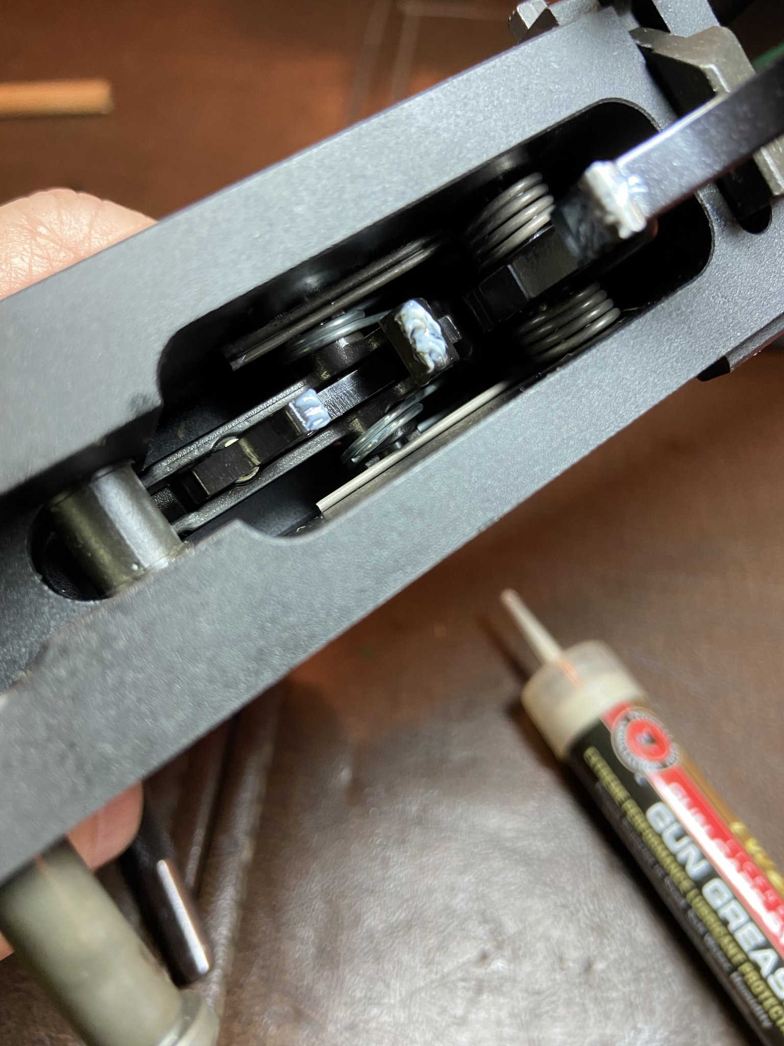

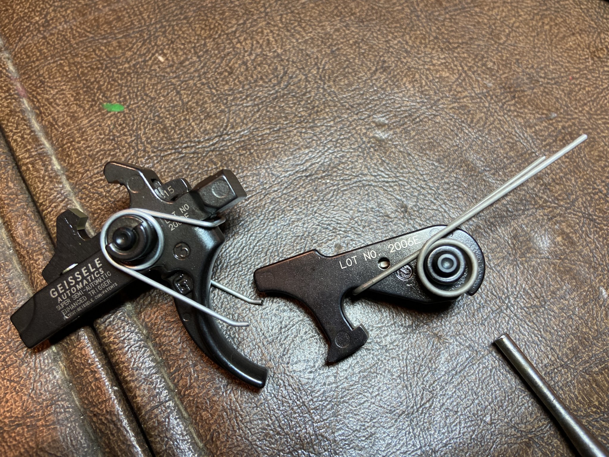

Well?...I installed the last of my mods this morning which was the Geissele SSA-E Trigger which along with my Magpul ACS-L stock w/ >7 Recoil Pad and MOE+ Grip and Badger Ordnance Charging handle?...I couldn't be more pleased with all of it! :)
The jury is still out for the Precision Armament M4-72 Muzzle Brake (until I get to the range this weekend) but like the other products?...the SSA-E trigger is both an awesome and well welcomed addition to this AP4 of mine.

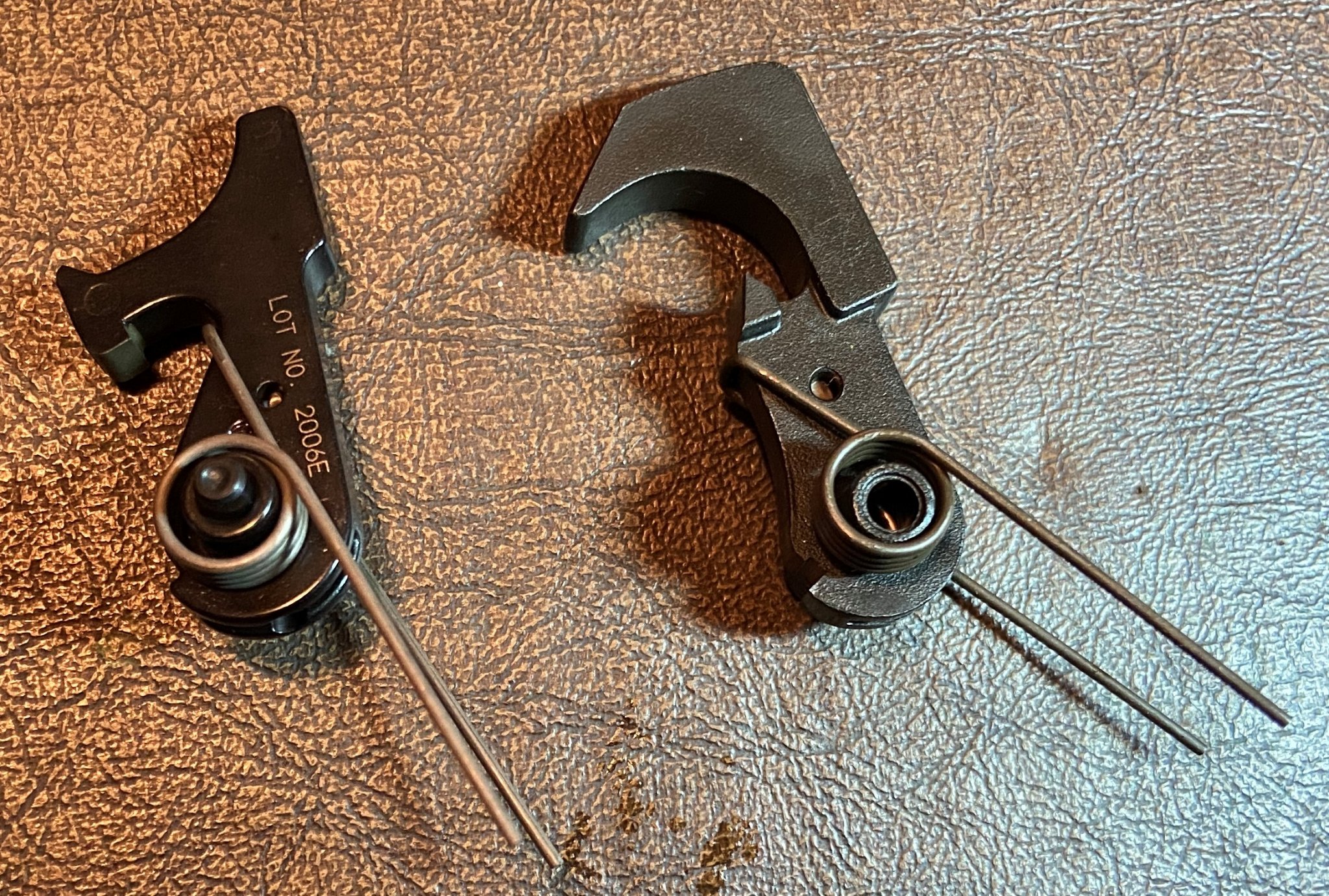

I've been an aerospace machinist by trade for well over 3 decades now and like the Badger Ordnance charging handle made of forged 7075 T6 alum with the ambi clevis tabs made of armory steel?...I liked that the Geissele SSA-E is made of S-7 (shock grade) Tool Steel (back in the day I installed all Chip McCormick Hammer/Disconnector/Sear S-7 lockworks in my P-14 IPSC race pistol that held up great) and very impressed that Geissele documents/tracks their products w/ Lot#s...I was also impressed at the well thought out design of the hammer because despite it weighing 1/4oz/8gms lighter than the factory hammer?...the mass was positioned in a more effective location resulting in a momentum advantage despite it's 20% lighter mass weight which is still driven by a full power hammer spring which would make for rapid full power firing pin strikes while enjoying a slight decrease in lock time.
The Geissele SSA-E Trigger installed and worked as advertised exceeding my expectations...it's approx 2lb 1st stage yielded a glassy smooth take up that ended in about 3/16ths" travel against a very defined 2nd stage wall and from there?...absolutely ZERO CREEP with an extremely crisp and light 3lb break where trigger reset seems to occur in < 1/6th".
Here's some pix of the trigger, install and finished product...my "SUPER AP4" :)
