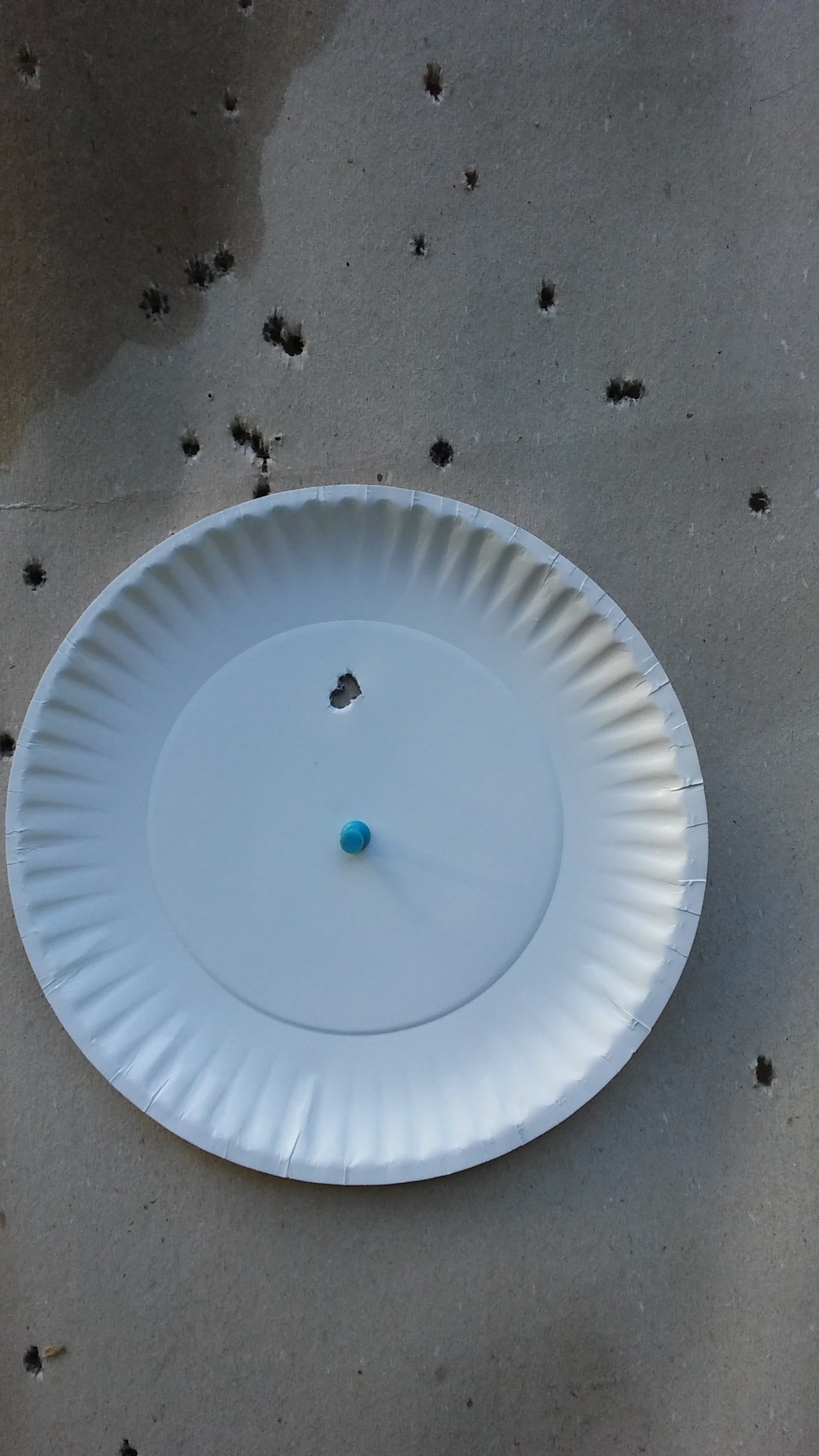

According to those that purport to know, DPMS will get you killed in the street. But, my bull barrel lr308 is easily sub moa with FGMM and Hornady match.
Reactions: WasNH4X
Haven't tried Hornady match,but I had one box of Superformance 165 GMX that shot really small (less than .50 moa ) 44.4 grains of SuperF 168 vld ......is slow but it shoots small for me ,along with 42.0 IMR4064 and about any 168 bullet I load.
