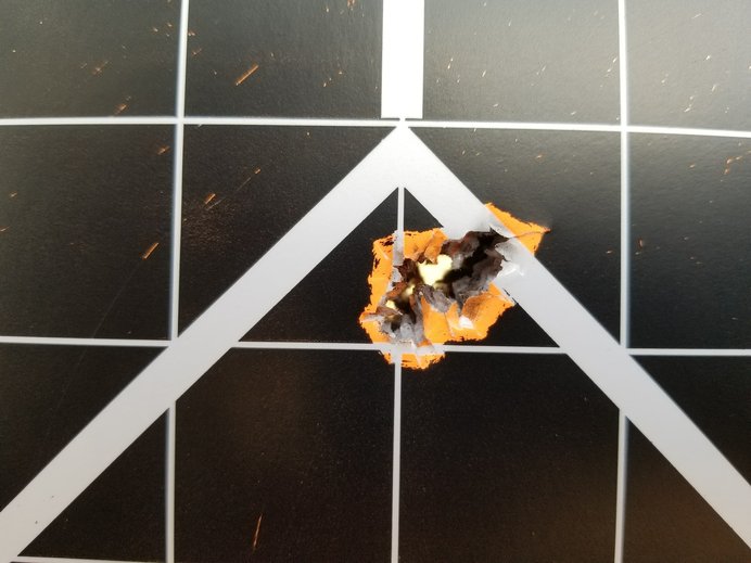

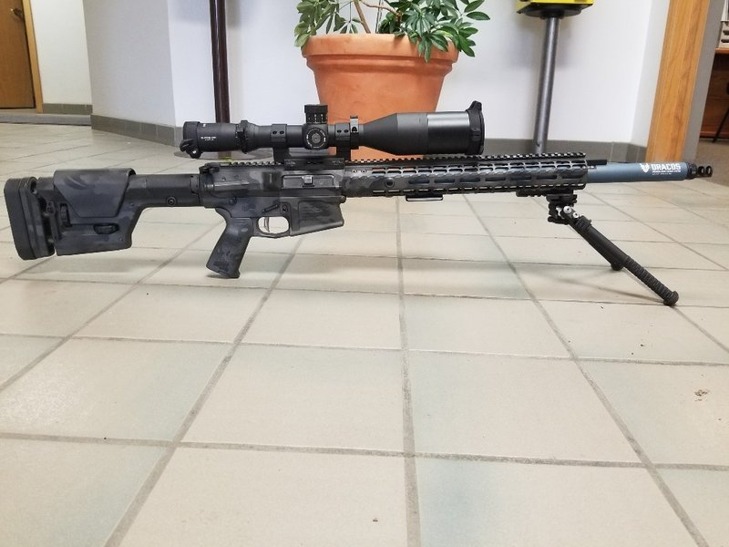

Put together a 6.5 with the new Dracos barrel on a Mega set. The guys at Dracos were great to deal with and the barrel shoots awesome with the standard 42.5 H4350 load. I used my ratty old hornady brass to load test with so im sure new brass that was prepped correctly would give better results.
Heres a couple at 100yrds
Heres 2 at 300yrs and 1.2 mil which was high and off paper
so 3 at 300yrds and 1mil
I have about 60rds through it now and its time for one more cleaning and test that lifetime guarantee out!
