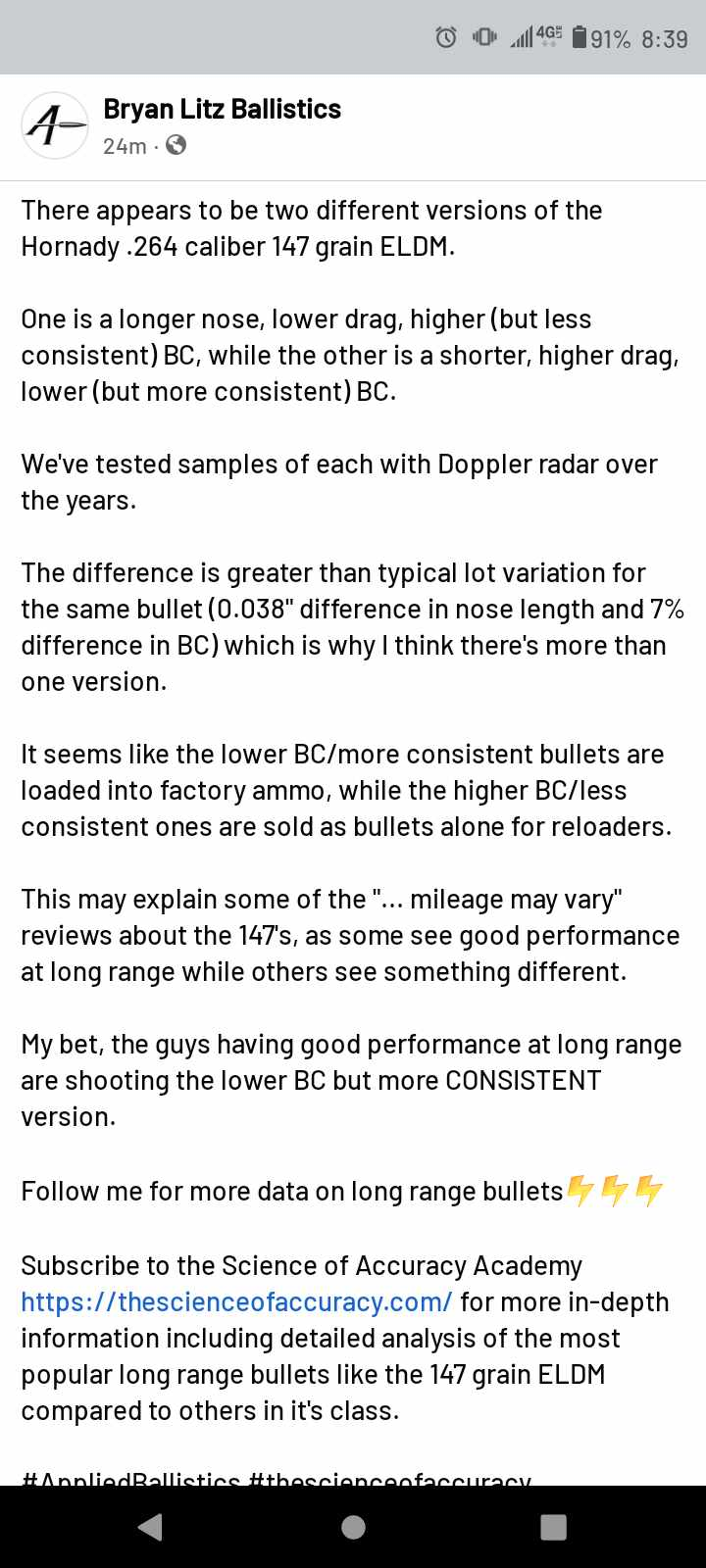

He didn't notice (or say why) what was causing the difference but it's real. The difference was round vs. flat meplat, nothing to do with component/ammo bullets.

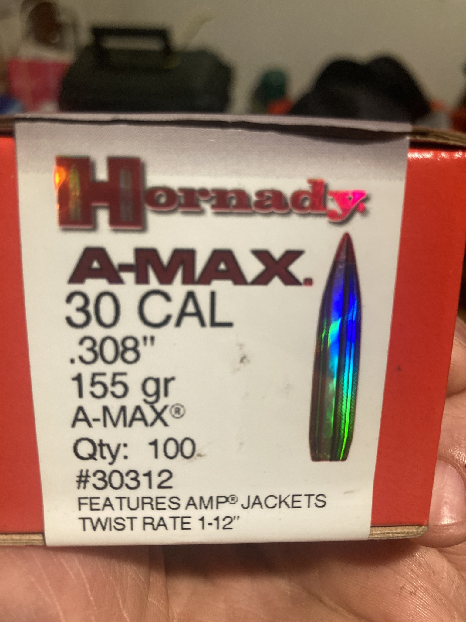

Thanks for the correction.
I was being dyslexic. I have A-MAX.
haha! Sorry.
