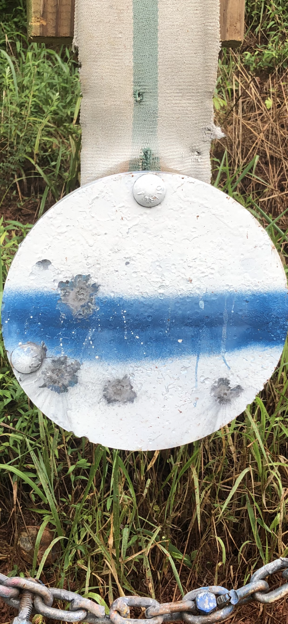

Today is what is prompting this post. Returned to my home range to shoot a couple of 100yd zeros and get out to 600yds. Temp was 72 degrees, 94% humidity, 29.79" and on and off rain. Shot a few groups at 100yds to check zero ended up around .5moa which is about the best i ever do. Worked my way back to 600yds and dialed on 4.7 mils. Now the hits were low! Using the reticle I was able to make corrections and ended up with 5.2 mils elevation.
