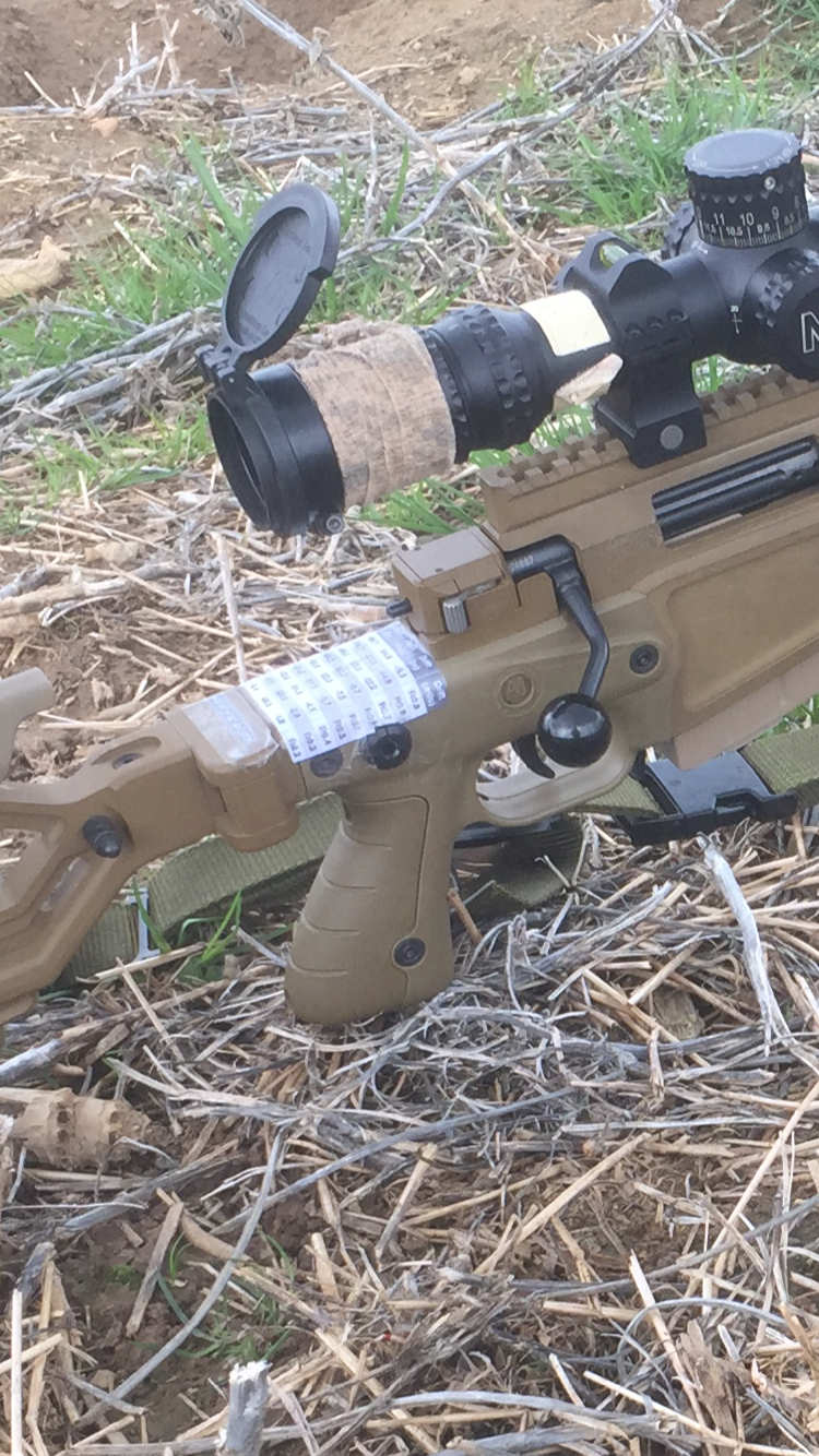

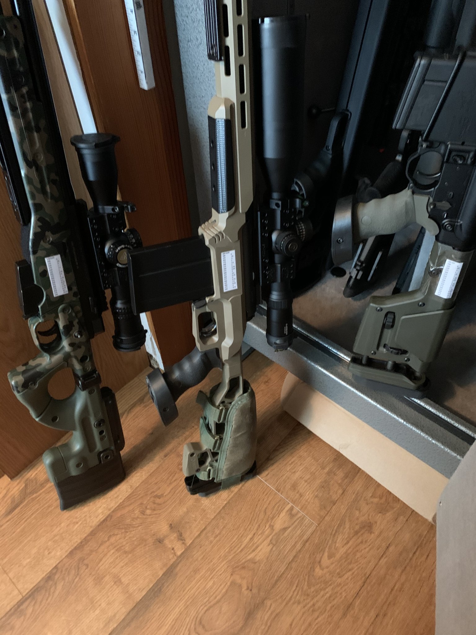

Drop chart in 25 yd increments to 500 yds on hunting rigs. Just printer paper taped on with packaging tape. Works well and easy to replace if it gets messed up. Use the phone with StrelokPro for further shots
I use the same method, also works on AR style stocks. I have the Velcro Stick-Ons on a rifle as well.
Reactions: deersniper

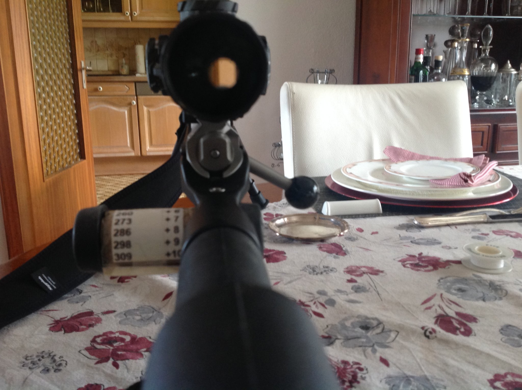

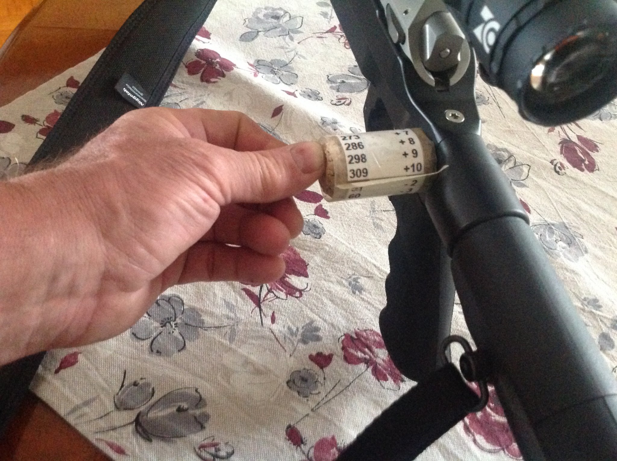

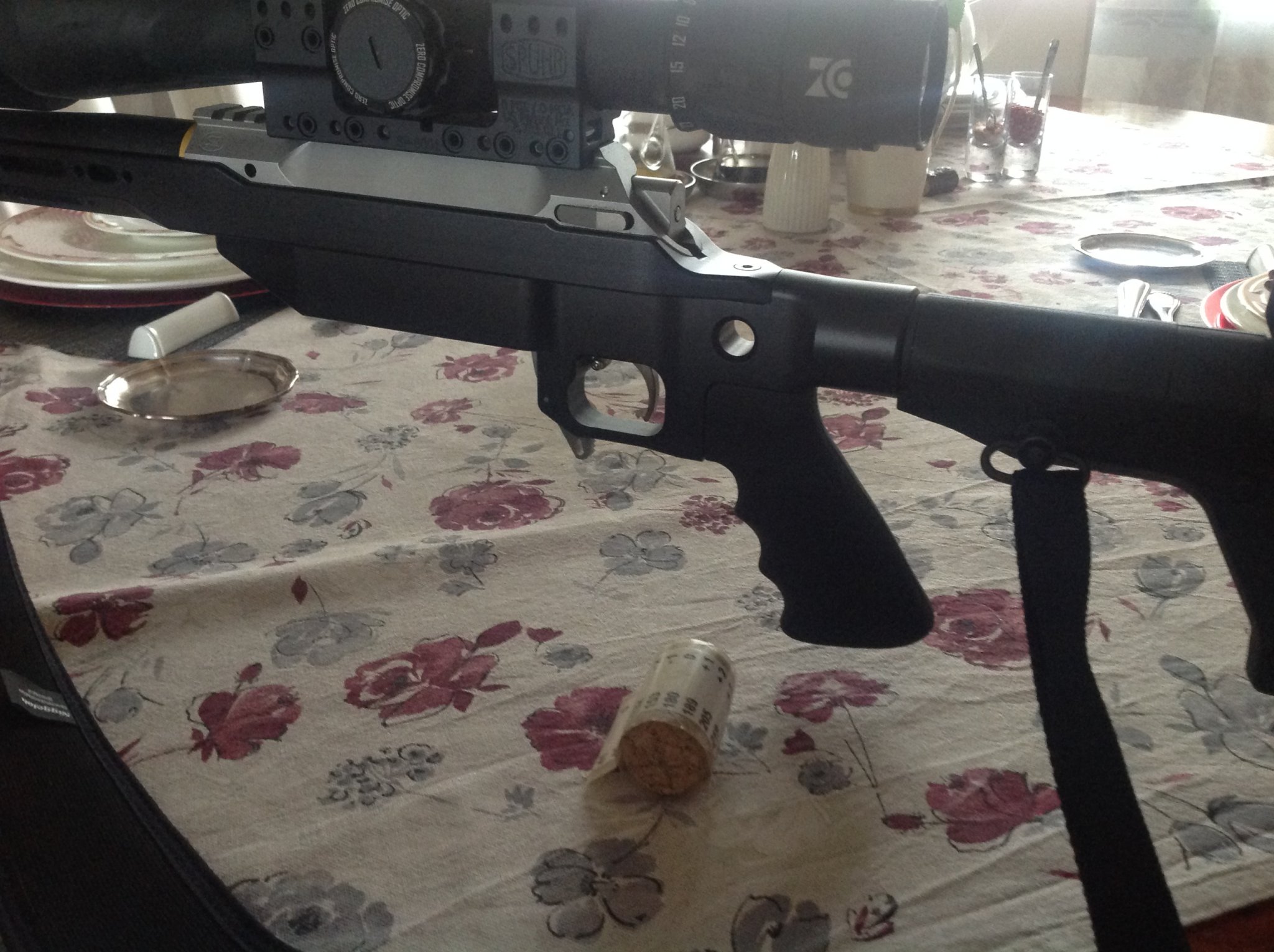

I printed a drop chart based on previous engagements at the range. I laminated it and attached it to a champagne cork (prosecco cork will do the job as well ;-)) . Using an existing hole in the chassis I screwed it onto the same, using black round plastic feet from an old maschine that has been dumped. Being cork, the roll can easily be rotated but nontheless sticks to the chassis due to its friction. Sole expense I got was the bottle champagne, which I do not regret anyway. Pics attached.
I associated the respective distance to each and every click down range, as I use this rifle for hog surgery as well. I do have another roll which goes from 20 m out to 801 m, done the very same way, every click related to the distance from where the adjustment applies. I am happy with this diy solution. I hate to spend a lot of money for things I easily can make by myself. In the days to come, when the full moon will be gone, I'm gonna turn a nice peace of black coated aluminum with nice end caps on it on my mini lathe, just to better fit the nice scope.

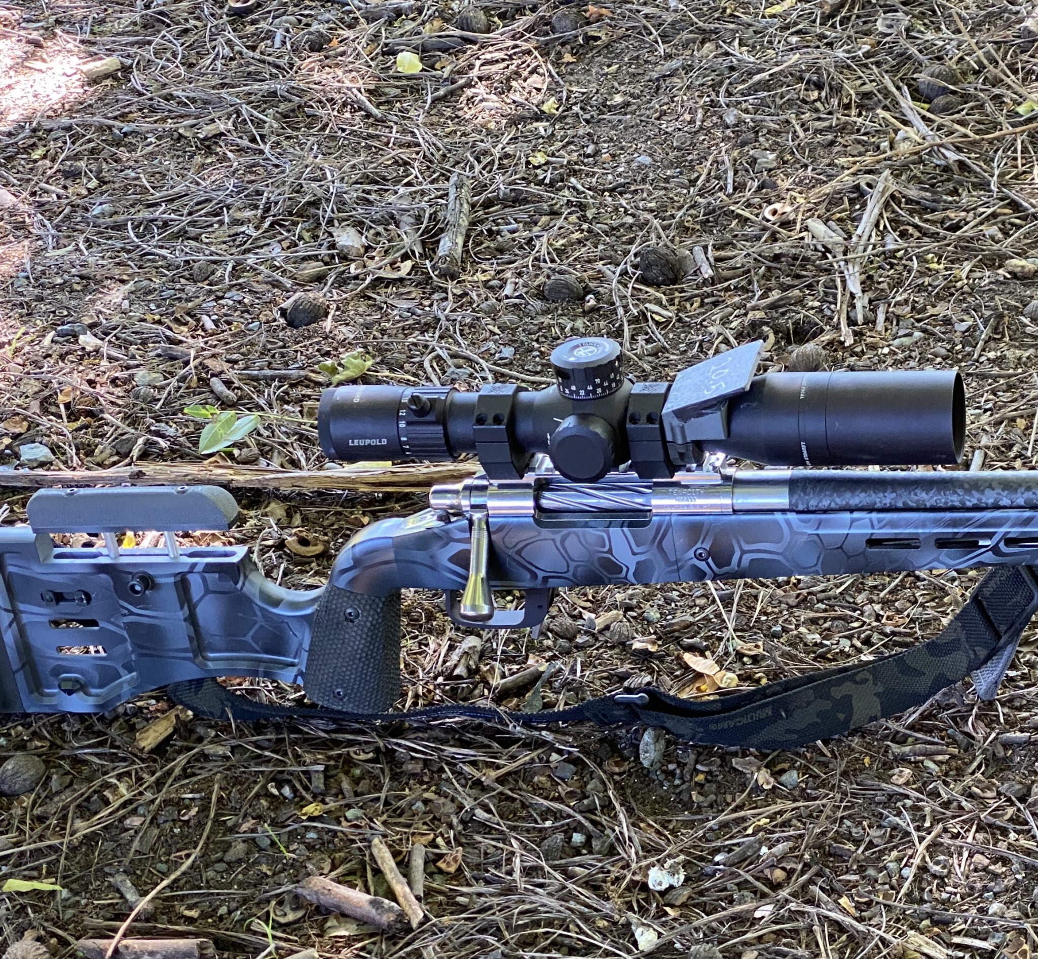

I 3D printed this slanted pice that attached to my scope then I use black 2” painters tape and a silver sharpie. I have my dope for standard condition written down and then I put a layer of tape over it that I can write down target dope on for multiple engagements or for hunting a mini range card. I don’t do distance I do my hold to target cause I don’t care how many yards exactly I care where I need to hold or dial. I also have a Garmin fenix 6 pro watch with Truflite ballistics on my wrist so have data there with my current environmental data. I also carry my kestrel... my sig rangefinder binoculars also has my dope in it so I have plenty of backups...
