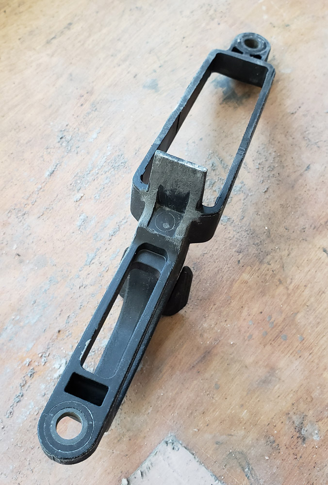

The Magpul isn't going to be a drop in fit for most BDL inlets without a little work to both the bottom metal and the stock inlet. AICS magazines require more width than a BDL floorplate requires and most AICS compatible bottom metals require a shorter pillar depth so in turn stocks like HS Precision and B&C need some machine work. I used the Magpul DBM for a project last year because it works off the BDL pillar depth and it came out pretty well, it required some modification to the DBM but that didn't take much time at all.
Modified Magpul DBM for HS Stock:
