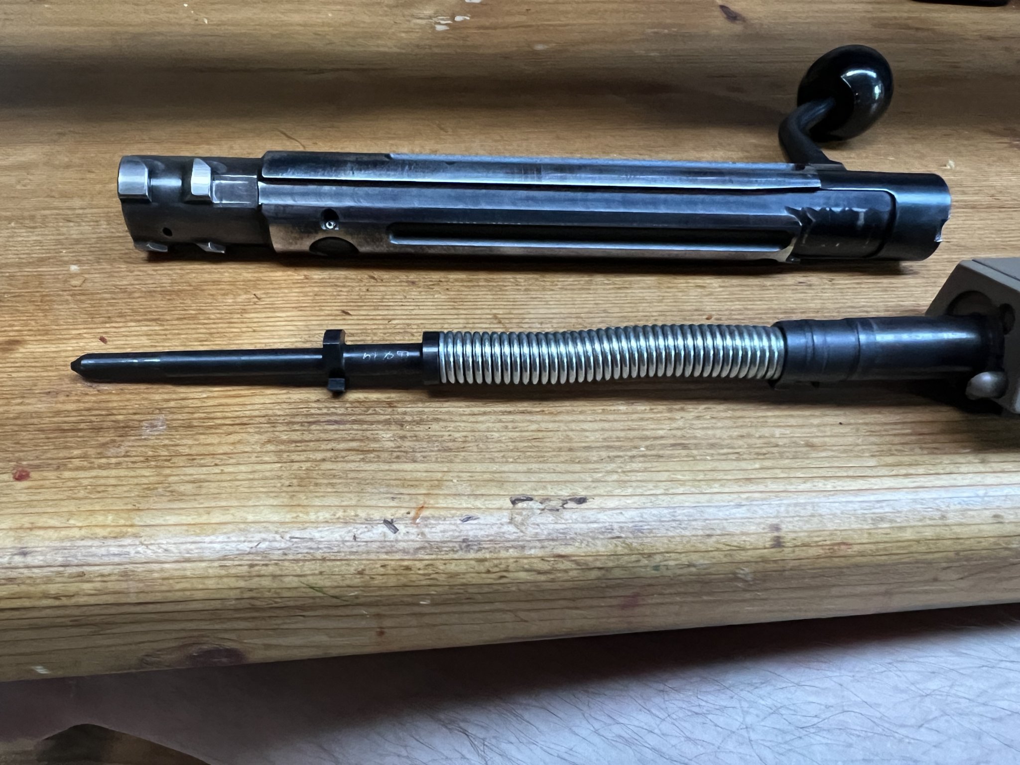

I’ve managed to pop my AXMCs firing pin during dry fire. Unfortunately it’s a long way to Rifles Only from the UK so show Jacob! I replaced it via the good folks at Sporting Services and have a backup FP on hand. It’s not stopped my biweekly dry fire session with the MC or AT, however.
