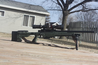

I think you did a great job except for the part about bipods. The Atlas PSR w/ ADM mount works very well on the AT in combination with the adapter that forum member samb300 makes that replaces the spigot mounting system.
It allows for the entire forend section of the chassis to remain free of crap that will get in the way of your hands. Honestly, before I got the adapter I had (and sold) the same Atlas PSR with the spigot adapter and used a Harris on the sling stud on my AE as well as my AT.
