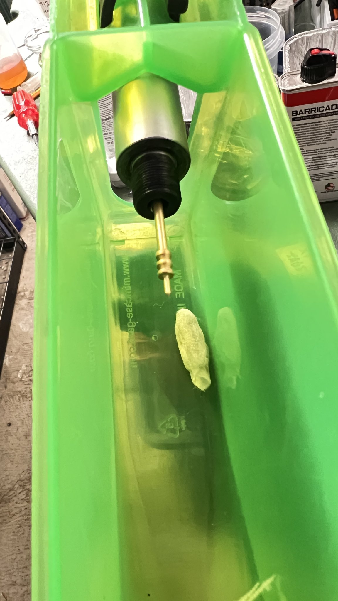

Bought a Dominus SR a while back. Still in jail.
Q: Which of their SR brakes catch the least patches within the brake itself when retracting the cleaning rod?
Or, put another way, which brake plays the nicest with cleaning patches/jags? Like when you’re cleaning the bore.
EDIT: Usually, I pop just the patch out of the bore and not the screwed-on thick bit of the spear-point jag, which is the diameter of the rod. As I retract the rod, the patch falls off. With a brake, the patch will probably(?) fall off within the brake.
I know I could probably just push the patch all of the way through the brake, but it’s be nice not to run the rod over the crown.

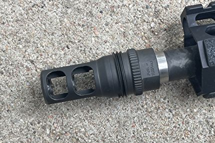

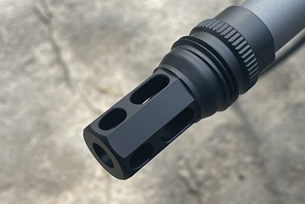

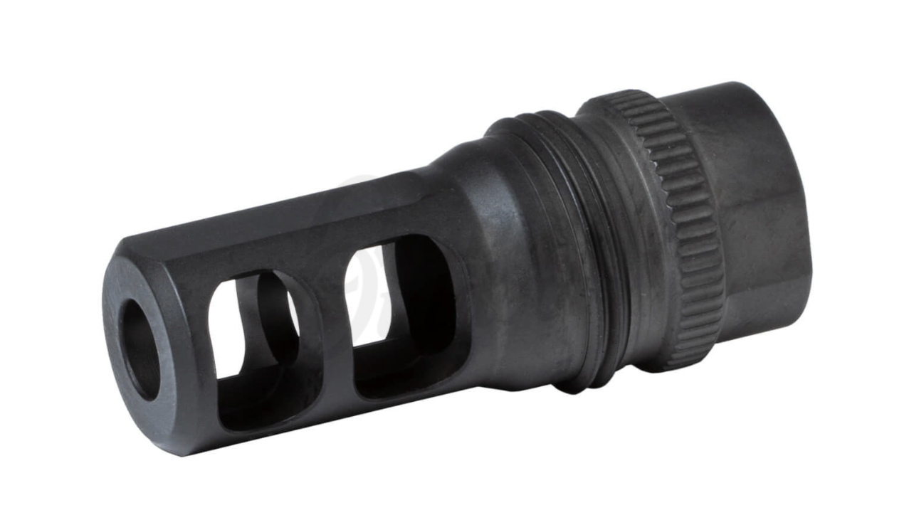

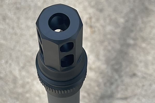

TBAC offers two different SR muzzle devices, a brake and a “non-timed” brake.
Note: I shoot 100% suppressed. So recoil reduction without a suppressor isn’t a factor for me here.
Regular brake, needs timing with peel washers (otherwise I look dumb at the range without the suppressor attached 🤡)
Non-timed brake, just spin on
As someone who has never owned a brake, I have no experience cleaning a rifle with an attached brake. Obviously the brake will be red-locktited on, as per TBAC, so I’m not spinning it off each time I clean.
I imagine it’s easiest to fish stuck patches out of the the regular brake, but then (for looks in my case) it’s the fussiest to install.
I’d rather just get the non-timed brake and just spin it one without the peel washer dance, but it looks like it has the smallest interior volume and smallest port openings…but it has 8 ports vs 4.

So are you pulling patches back through the barrel and chamber?
I would recommend just pushing the patch through the barrel, and removing the patch once you push it through the barrel and brake.
(Edited my main post to explain better)
Yeah, I didn’t explain it too well. See my post right below yours. NOT pulling patches back through.

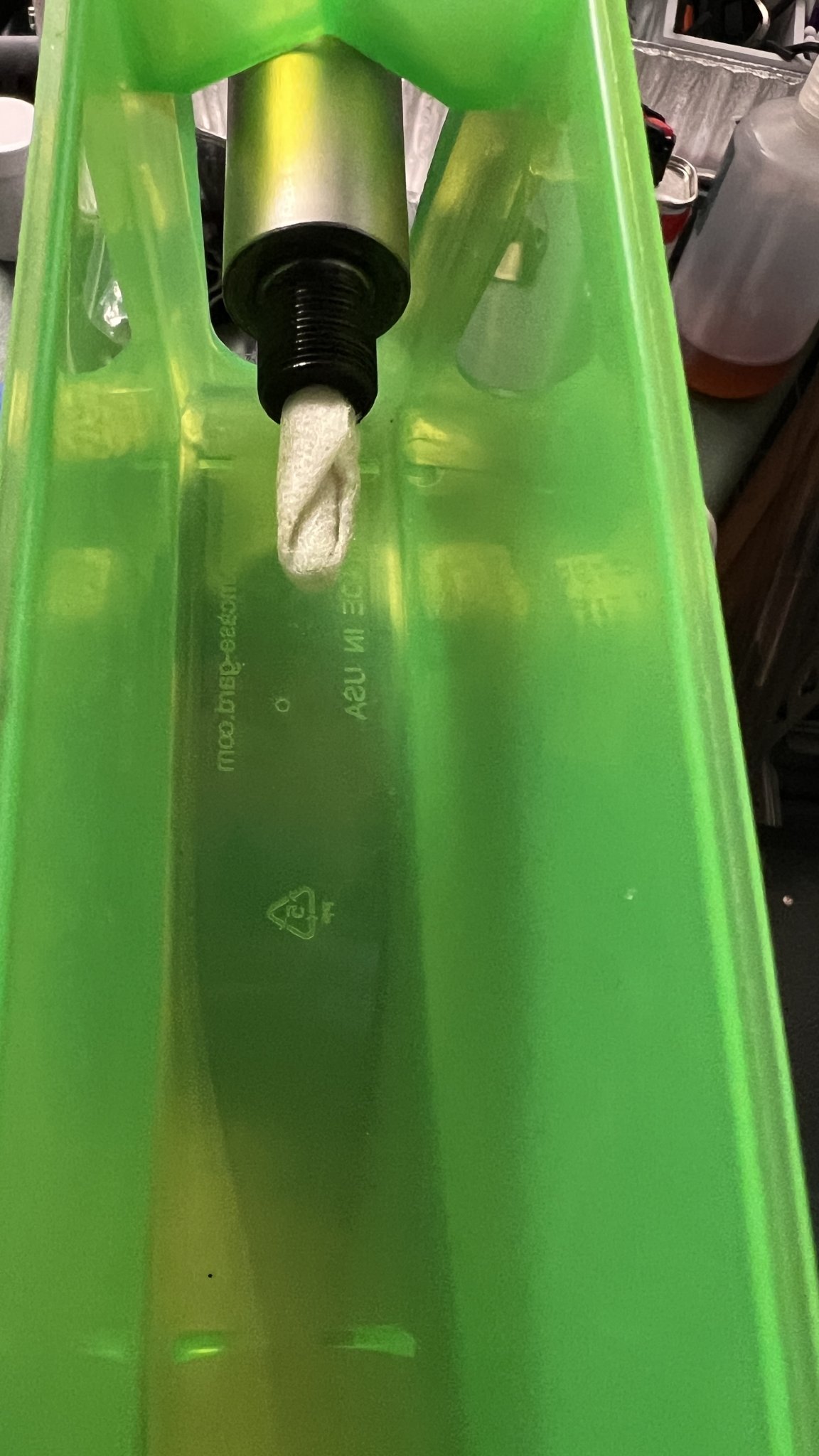

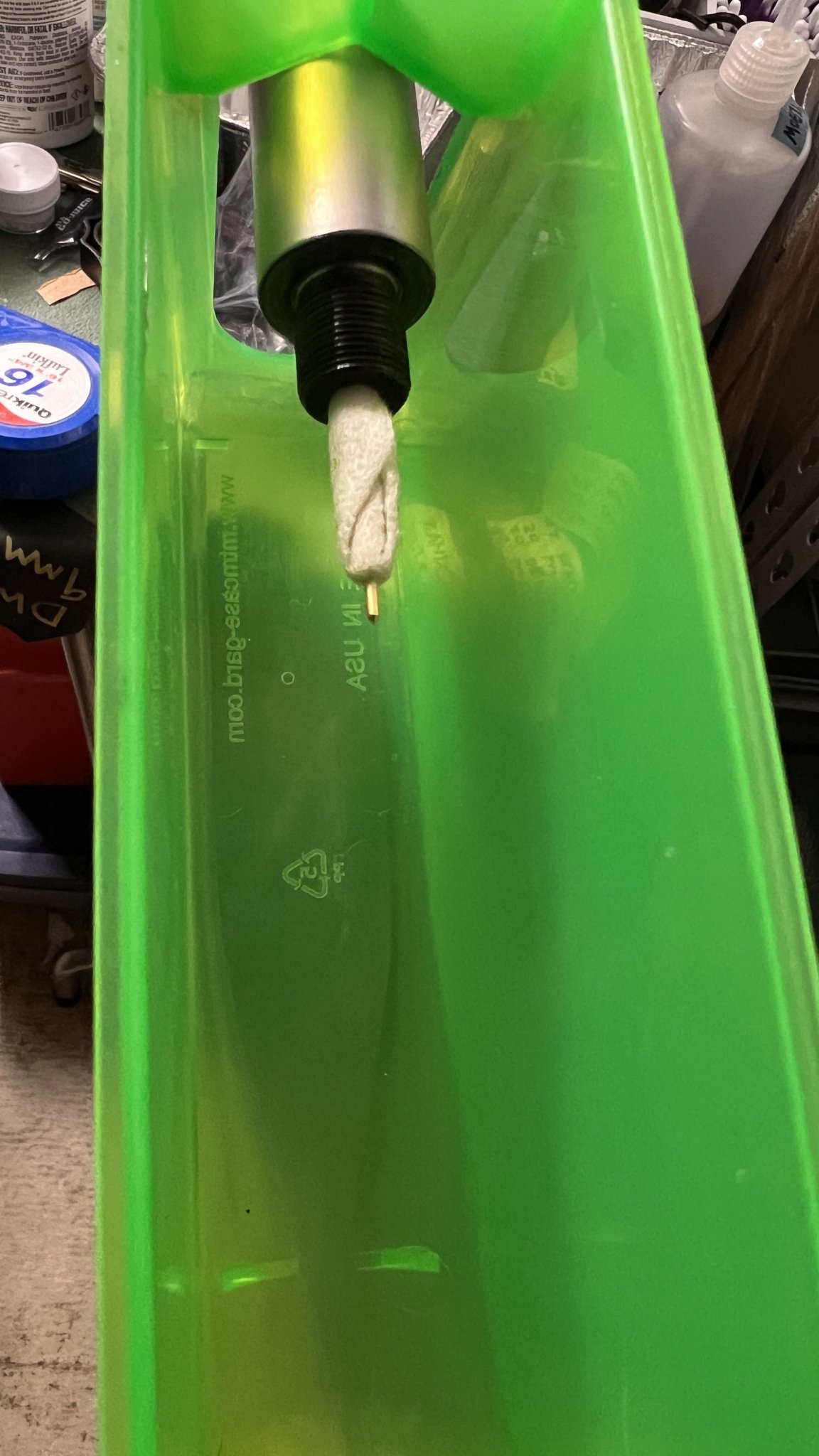

Usually, I pop the patch out of the bore and not the thick (cleaning rod diameter) bit of the jag. As I retract the rod the patch falls off.

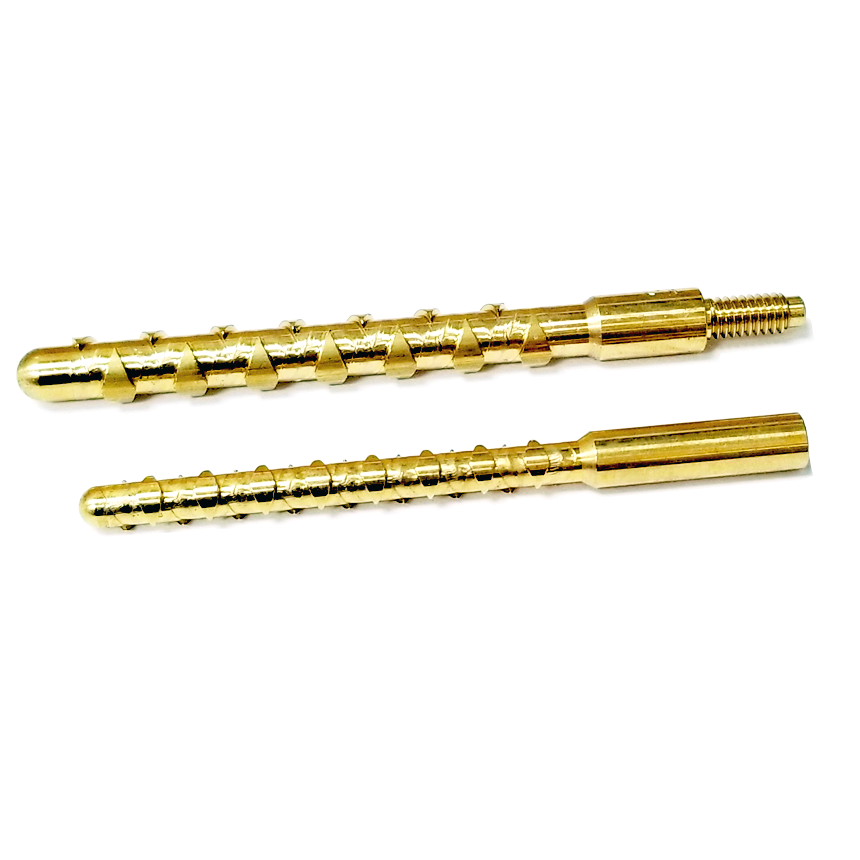

I use proshot equipment. Their jags are nice in that they are fairly long. Longer than dewey, for sure.
I could just orient the regular brake so the ports are facing up/down. This would allow the patch to perhaps fall off easier and not get hung up inside.
When the suppressor is off, I guess I’d just not have to give a crap about what others think about my “wrongly” oriented brake.
When the suppressor is off, I’d just not have give a crap about what others think about my “wrongly” oriented brake.
I just push mine through past the muzzle brake, gently. However I don't use a jag, I use an undersized bore brush (6mm in a 6.5 Creedmoor for example), and remove the patch by hand.
Clamp your rifle in your pattern makers vise with the muzzle facing the floor. You can also place a pan to help catch drippings and patches and such under that bore. Push that rod, push it real good, all the way in. Yeah, that's it. Remove the patch (if you are using a brush, remove it, too) before pulling out.
If you are using the spear jag then you don’t pull it back. It’s designed to push out, remove and unscrew, retract the rod.
If you are using a Parker hale jag then you just need to be sure you don’t let it exit the crown entirely and it should be able to be pulled back.

In either case, once you exit the crown I would take the patch off and unscrew the jag before retracting the rod back through the bore.
Vs
I gotta respectfully disagree here.
I use the same technique that Speedy uses in this vid. I linked to the time, which is 4:45.
I don’t follow his entire cleaning regimen, but I do do his patch drop thing with a spear jag because it’s so fast. I also use a little container like his that straps on the barrel to collect patches. This is the bit I’m talking about with this post, the dropping of the patch after the bore, but still in the brake (he doesn’t use a brake).
Also, just like him, I never unscrew a spear jag. I do ensure the interface between the rod and jag is seamless.
However, if I do something that requires me pushing a brush past the crown (wrapped in a patch or not), then I do unscrew that before retracting the rod.

There’s a chance I’m totally off-base and misinterpreting how Speedy and some others use spear tip jags, but I don’t think so?
To elaborate a tiny bit further as to why I think (but do not know) why Speedy doesn’t want to push the body of the spear jag past the crown.
As one pushes the patch down the bore, the jag is slightly suspended by the patch. The rod and jag are basically hovering (if you use a bore guide, at least).
If you push the body of a spear jag out past the crown, either the jag body itself or the rod drops on the crown area as the patch pops out. By “body” I mean the flared bit that screws flush to the rod.
Nice long-ass spear tip jags are one of the reasons why I like Proshot stuff. They’re way longer than Dewey and make this technique easier as they allow the patch to clear the muzzle and drop without the jag body running over the crown.
Never used other manufacturer’s stuff, so maybe there are even longer spear jags out there?

Just thought of something. The crown-to-port distance on either brake probably makes my question moot anyway. Most likely too long to allow the “drop patch” technique described above.

I did however buy the non timing brakes for my 338 ultra SR. I will never buy a timed brake for can as long as non timed brakes exist
Haha! Yeah, this is exactly why I’m asking. I don’t feel like timing the brake! But the holes look so small on the non-timed brake.
Shhh I still have SR brakes to sell until my NTB SR get here
I can’t think of why anyone would buy a timed brake with the TBAC offering of non timed
Unless you shoot unsuppressed
Which would make you uncultured swine and likely can’t afford a 338 SR anyways

Push it all the way through... Unscrew the jag, remove rod... Reinstall jag, reinstall new patch, repeat. It only takes a couple extra seconds and it ensures you don't knick the crown. This is how I clean mine. I do the same with brushes. Push through, remove, pull rod, reinstall, repeat...
OR...
Push the jag all the way through, and then gently poke it back inside the bore with your finger, then remove the rod, ensuring you don't slam the jag on the edge of the crown.
I do the same if I don’t have bare muzzle. With bare muzzle I grab the jag and push it into the crown. With a muzzle device I remove the jag

If you push a patch through just be careful when you retract the jag.
Push til the patch falls out the end and carefully pull it back through and you won’t have an issue

  1. Pick out patches that have fallen inside the brake body (with a tweezers if necessary)
  2. Look through the bore to make sure it’s unobstructed so I don’t kaboom at the range/in the field

You could push it through and pull with tweezers every time and wouldn’t have an issue. Red loctite wouldn’t hurt. I just don’t leave my can on so I use blue. It works for me but if you carbon lock a can it may grab the brake. My 556 ASR carbon locks like crazy. My TBAC hasn’t been and issue

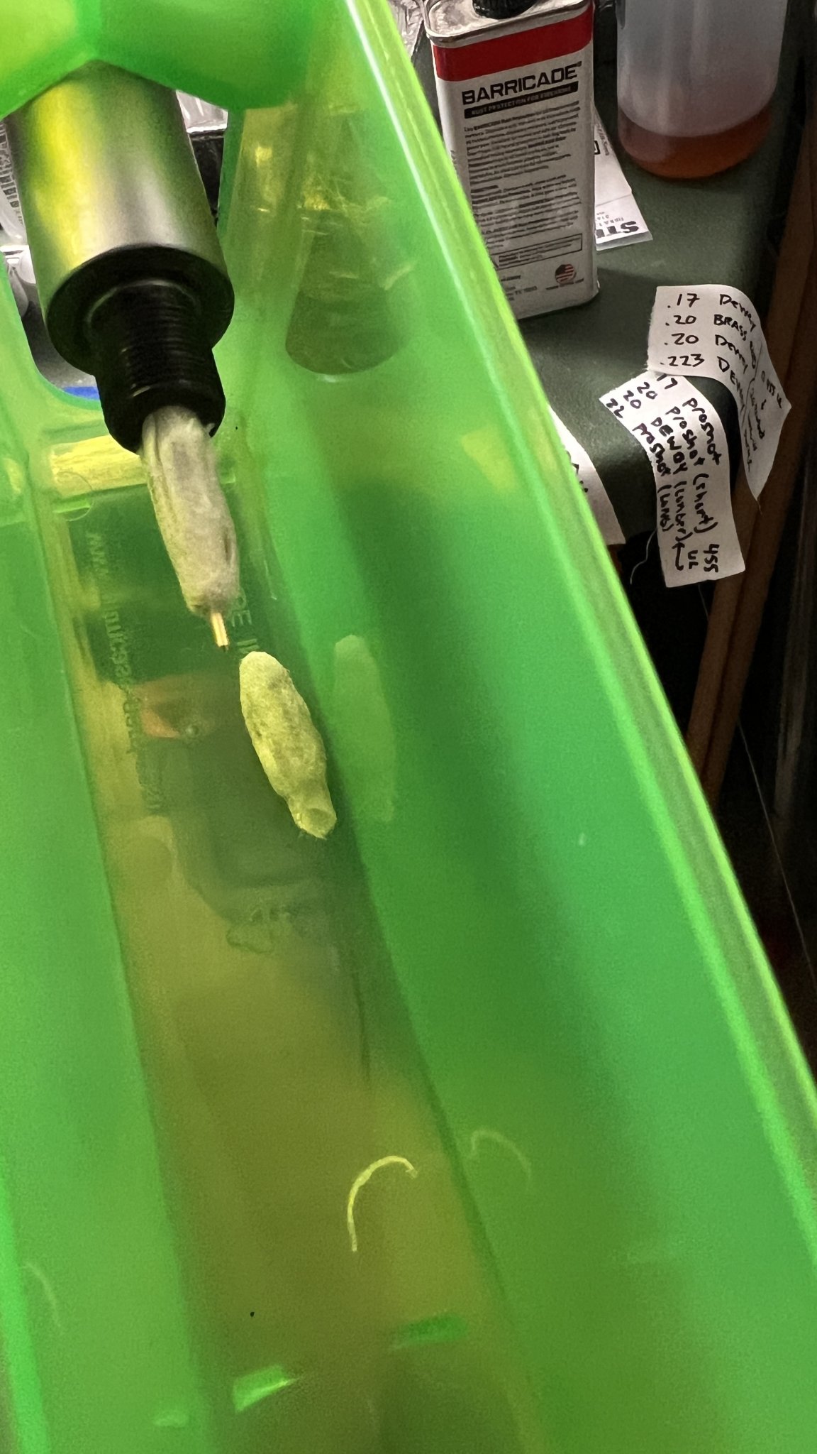

If you suspend that rifle with the muzzle to the floor, you are not relying on some torn piece of underwear to keep your jag "suspended".
You also really don't even need a bore guide at all but I do use them.
Annnnnnddddddd...all the crap is falling out of the bore and into my drip pan.
Reactions: carbonbased
Currently (with no brake) if I don’t quite get the patch to fall off halfway through the cleaning session, I just load another patch and “send it” (sounds so dramatic 🙄 ).
Patches push the occasional reluctant patch out. I just make sure to quickly inspect the bore after I’m done.
See, I loathe making the (short) trip down the to muzzle. I hate cleaning and I’ll do anything I can to speed up the process.
While I do have a pattern maker’s vise (not an Emmert, a Wilton and in storage) and I do think your idea has merit, my currently living situation makes your solution impossible.
I am filing that away and I do thank you for it.

With just a bare threaded muzzle, when I retract the spear jag a used patch can occasionally just barely cling to the bore/muzzle face. Can look like a ghost exiting a cave…suspended in midair.
I think I need pics. Hold on.
Where is the patch falling off? If my patch fell off in the bore my jag wouldn’t pass it. Otherwise if it’s falling off in the brake you could easily retrieve it
You’re putting way more thought into the cleaning process than I ever have. I would just run the patch through until I could grab it or it came out the brake
The retract the jag so it doesn’t contact the crown

So here is what I’m talking about at the muzzle end.
204 with 1 3/8 square patch​
I stop here. In fact, that’s as far as this rod goes. It’s up against my bore guide. A happy accident and super efficient as I don’t have to sneak up to the end.
Rod has been fully retracted. Often the patch falls on its own. I don’t touch it as I don’t want to waste time, and anyway, there’s no benefit to hand-removing it anyway (unless it’s the last patch of the clean).
New patch pushes old patch out.
A view of the max the jag can possibly exit on this gun. Crown cannot be damaged.
