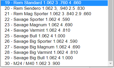

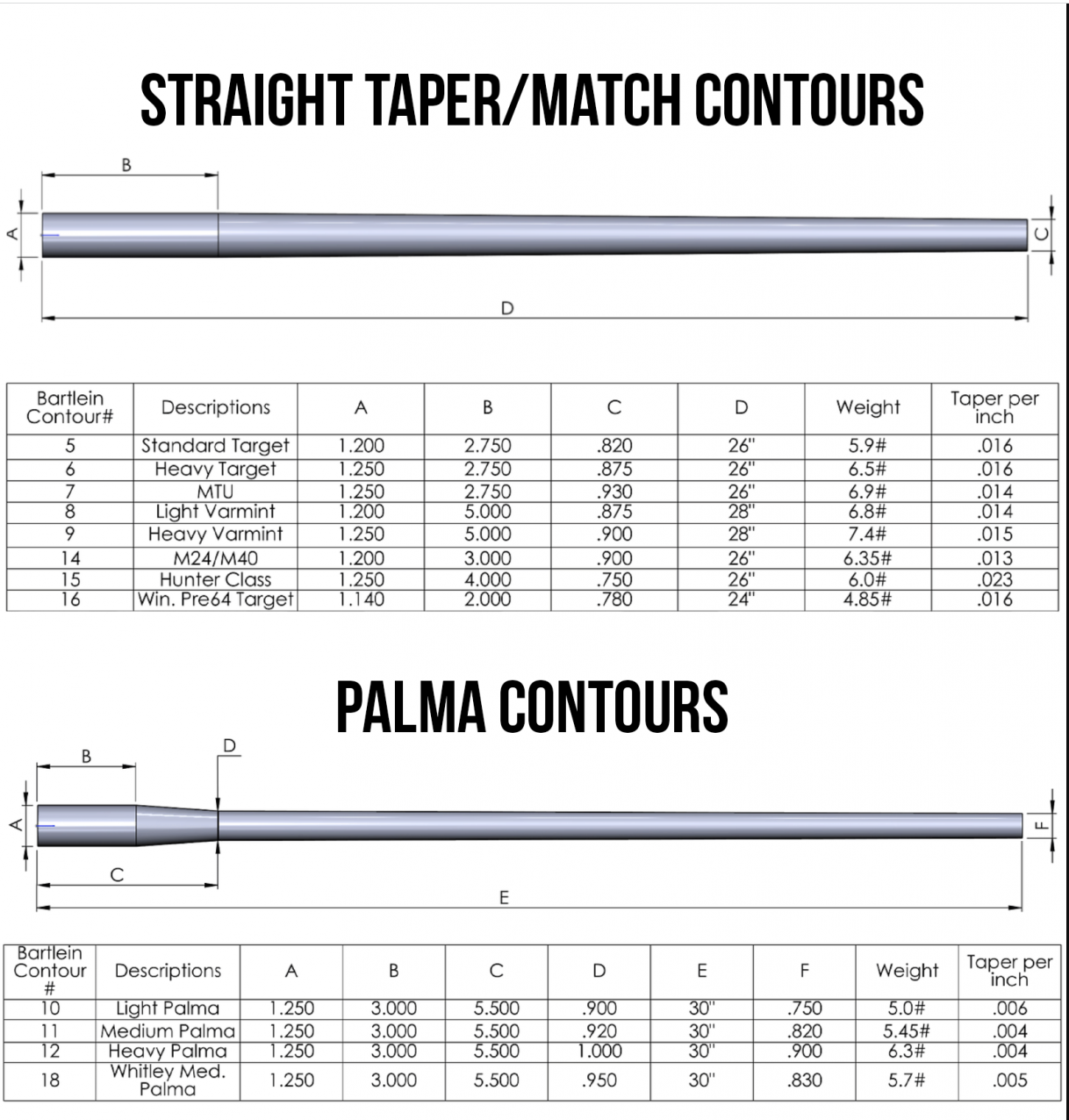

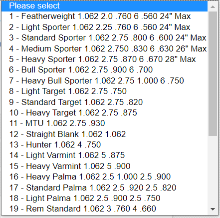

You mentioned the other barrel contours (M24, MTU [I don't know what this means!], Palmas). I had assumed that these were all about tradeoffs in weight vs stiffness. I just kind of picked the bull sporter at random as a tradeoff figuring it wouldn't be stupid heavy. So let me ask another dumb question - given that I'm not carrying the rifle a lot, do any of the other options you mention bring any advantage besides weight? Why wouldn't I just want the thickest wall (and therefore heaviest) barrel? (Heavy Varmint??) At some point does the weight cause droop over the length of the barrel? (These are the choices)

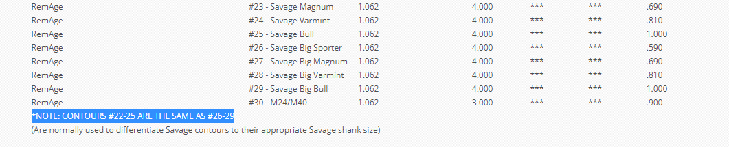

What's the difference between the Savage Bull and Savage Big Bull (both say 1.062 / 4 / 1.000)? Both look the same here ( https://www.x-caliber.net/contours ) #25 and #29

Basically when it comes to selecting barrel contours, the major factors would be total weight, weight balance, heat sink capacity and stiffness.
Stiffness isn't something that a lot of people worry about for a lot of these heavy profile barrels unless they're putting a heavy suppressor on the front in which case you want a stiffer barrel simply to have less deflection (less point of impact shift).
The thicker the barrel the larger the heat sink capacity (typically means you can fire more rounds before barrel gets hot) and while you can sort of figure out which barrel is pretty thick by total overall weight, the profile plays a role in where the thickness lies and how that corresponding weight is distributed.
The more the material is concentrated towards the chamber (either due to profile or barrel length), the lighter the front end will be. Depending on barrel length since longer barrels act as a lever. This can be a positive or negative depending on your uses. Now even if you won't be carrying the rifle a lot, an excessively light or heavy front end of the rifle may affect your offhand shooting (should you choose to shoot offhand).
In the picture below, the example of similar weights but different barrel lengths and profiles would be the M24 profile at 26" barrel length with a weight of 6.35lbs compared to a Heavy Palma profile at 30" barrel length and weight of 6.30lbs. Similar total weight but different in the balance. Also note how both of them transitions to a muzzle diameter of 0.90" but the M24 contour tapers more gradually than the Heavy Palma.
Most modern chassis and stocks will fit a M24 profile.
If you want the heaviest of the heavy barrels, you get a straight contour. It will not taper at all. Whatever diameter it is at the chamber will be the diameter of the barrel at the muzzle.
Edit - for the Xcaliber profile there is no difference between the Savage Bull and Big Bull for the Remington barrels. Basically #22-29 are all the same
The heavier the mass the more it mitigates recoil, force equals mass times acceleration so the more mass the less that forces accelerates and recoils into you. Takes longer to heat up and warp etc. Just simply make it easier to shoot.
The difference between the normal vs big is what savage calls small shank and large shank for their actions. If you look at the savage sections 22-25 are under the small and 26-29 are under the large.
And since they basically keep the contouring the same aside from the thread to fit the action I assume it’s just a carry over to make the contouring operation universal before it goes for the specific action threading. The Remington can use whichever’s nut contour and then get its specific cut.
