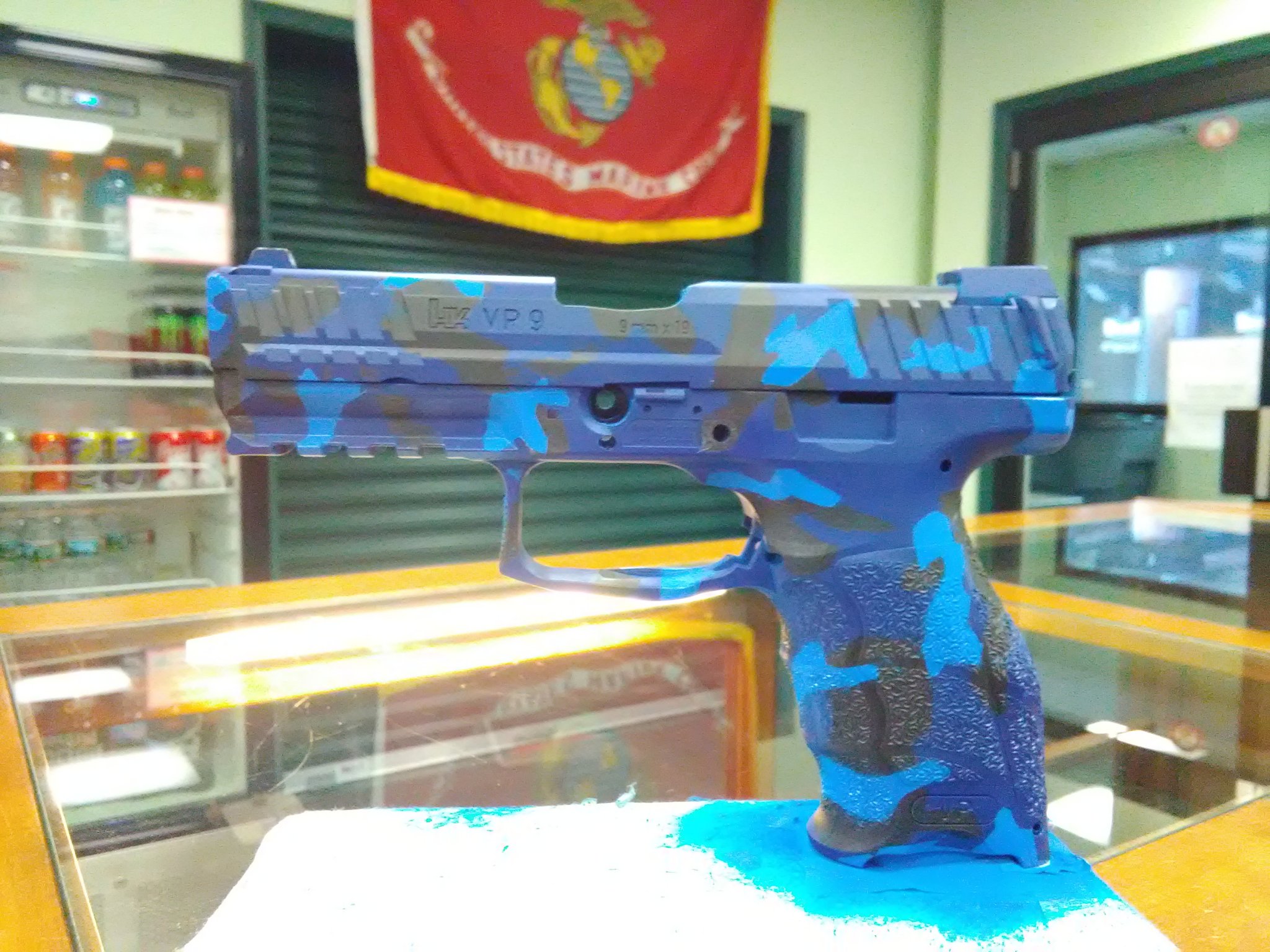

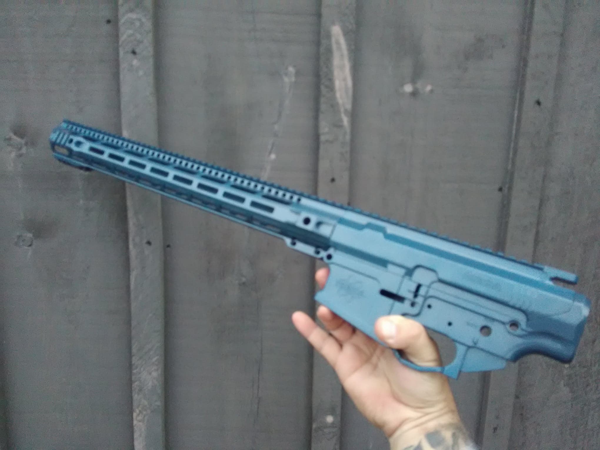

If you want something permanent and easy to apply. I say go with KG Industries Gunkote. I have done numerous firearms with it and it is pretty easy to apply with a basic airbrush gun and small compressor. Prep is the key and then baking it on for an hour at around 360 F. If you are going to do polymers, they have an additive that you mix into the color you are doing, this reduces the baking temperature to 160 F. 118356959_826007751473115_5268080595226343971_n.jpgIMG_20170722_152548.jpg
