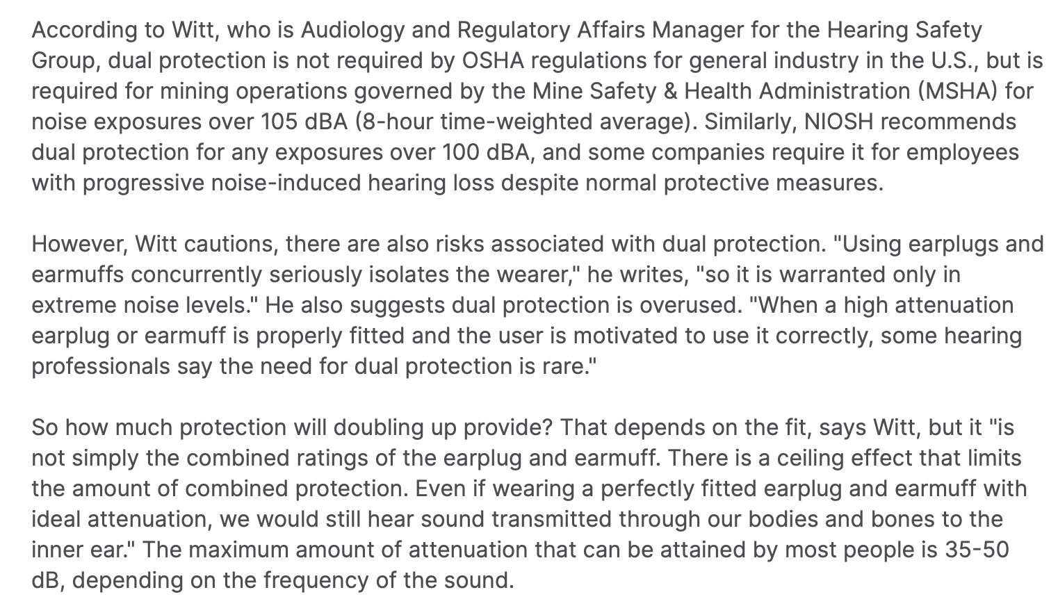

Using electronic ear pro (in order to hear commands and shit), if you don't double up, you will go deaf around these guns, period.
That's not true at all. In fact, it's actually being pushed recently to not double up so that you actually do hear commands.
OSHA requires double protection when the average decibels is 105 for the entire 8 hour work day. But there is no conclusive evidence and it's basically a "safe than sorry" rule. They also only recommend double protection is the most extreme environments as it isolates the person from other important things (like range commands).
And active (electronic) hearing protection is no less safe than passive.
You can double up all you want for comfort and such or if you want to take a better safe than sorry approach. But you're not "going deaf period" if you don't use plugs with electronic muffs.
Doubling up being "warranted only in extreme noise levels" Mr. Witt is talking about are things like loud factories, mines, and working near jet engines...
...all of which are pussy as fuck when compared to being 10 feet or less from a braked rifle.
Not to mention, OHSA/MSHA and just about anyone else base their findings on A-weighted measurements, usually taken at a fairly meaningless 1000Hz, and do not even take the shockwave/concussion/pressure-change effects of sudden transient sounds on the inner ear into account.
