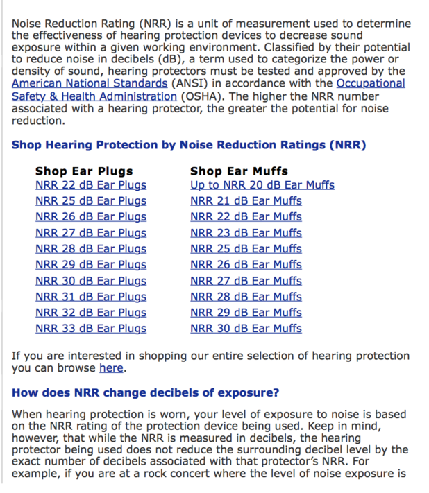

Guys with the Etymotics. Looks like these only have 15db of noise reduction. Are you really finding this to be enough, especially indoors?? Most decent ear pro is at least 22db reduction.

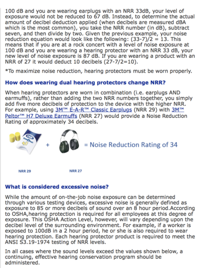

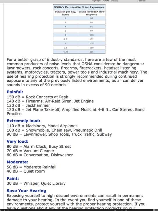

Here is how ear protection noise reduction ratings are converted to a reduction in dB.
Note the reduction formula when combining dual methods of protection.
