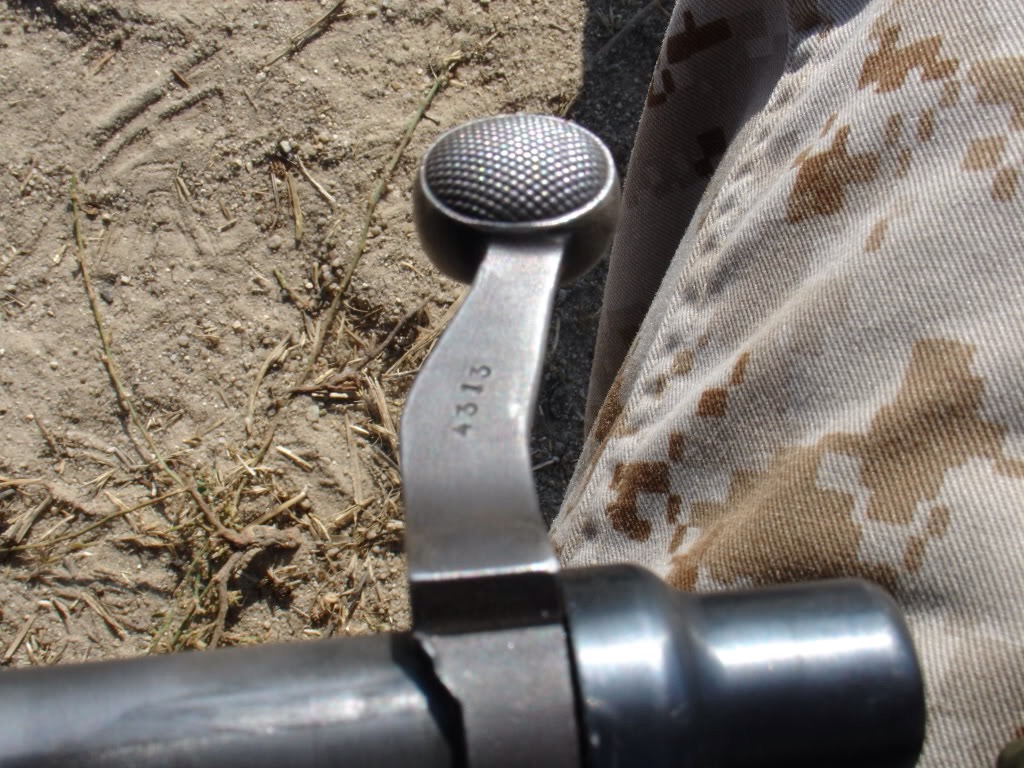

This is what I find is incredible Skunk. Your scope 1114, was sold by the CMP in 2017. I love anytime I can identify a rifle or scope serial while in service. Especially when you can identify where they were used or who used them!
Here's when your scope was sold, I wonder who owns it now.
BTW your rifle 224313 was initially built in Sept 1977, so basically one of the first M40A1's built, and was rebarreled in Aug 1995. So that might be when it picked up the shroud. But no way to know for sure.
I LOVE these original in service pics! Thanks for sharing!
