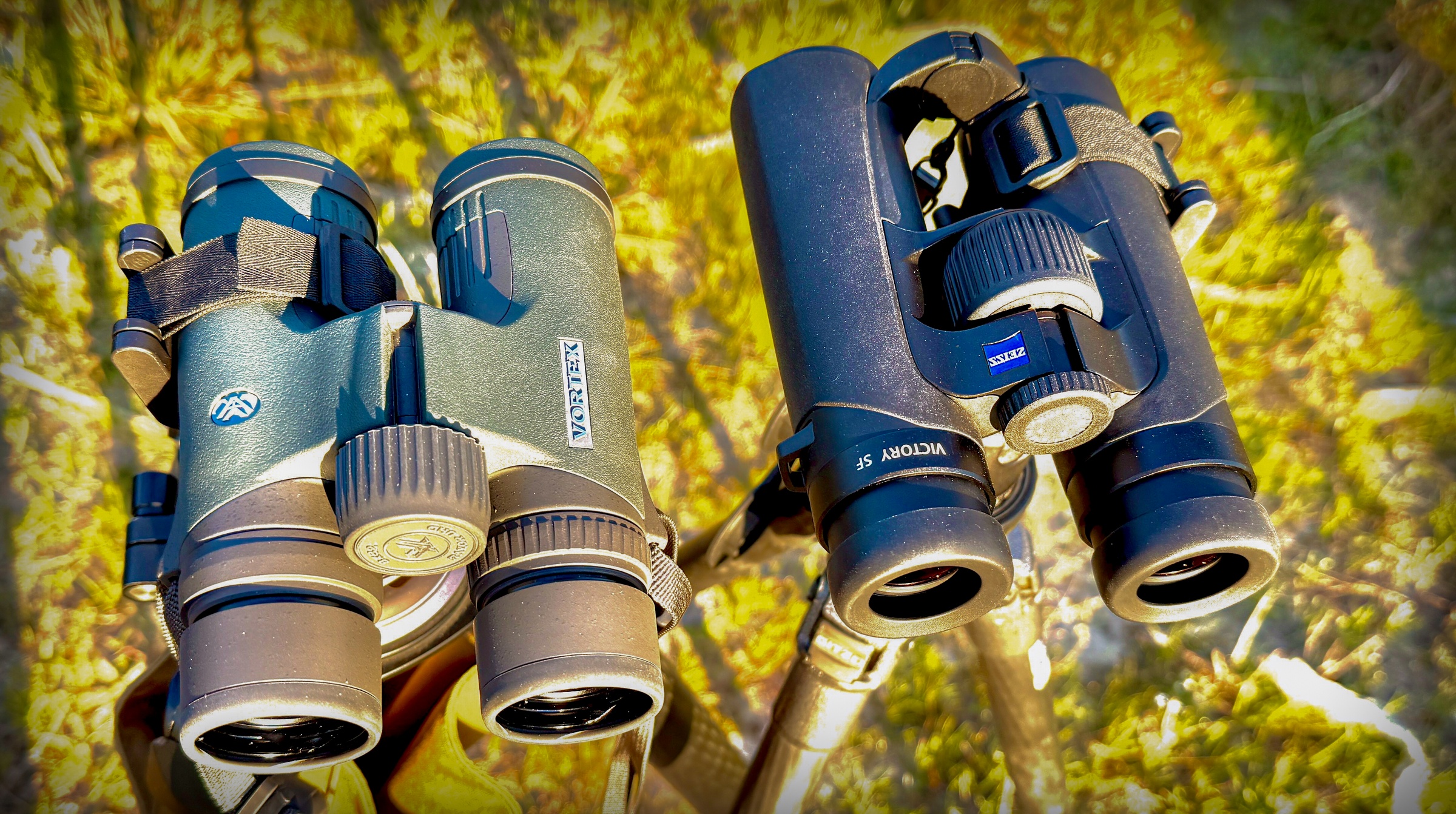

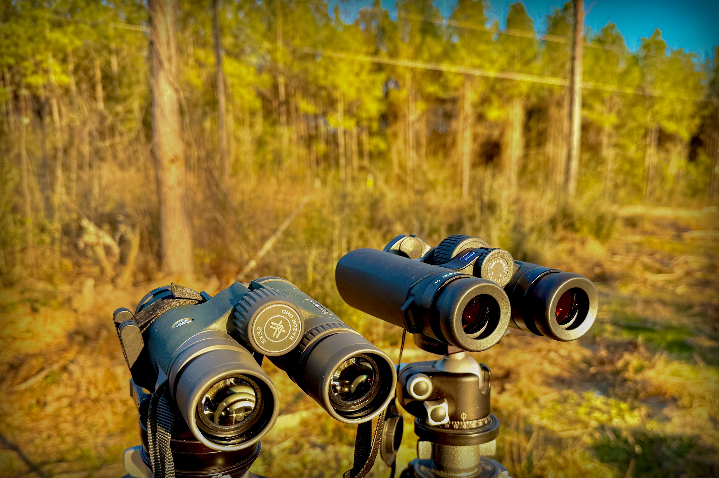

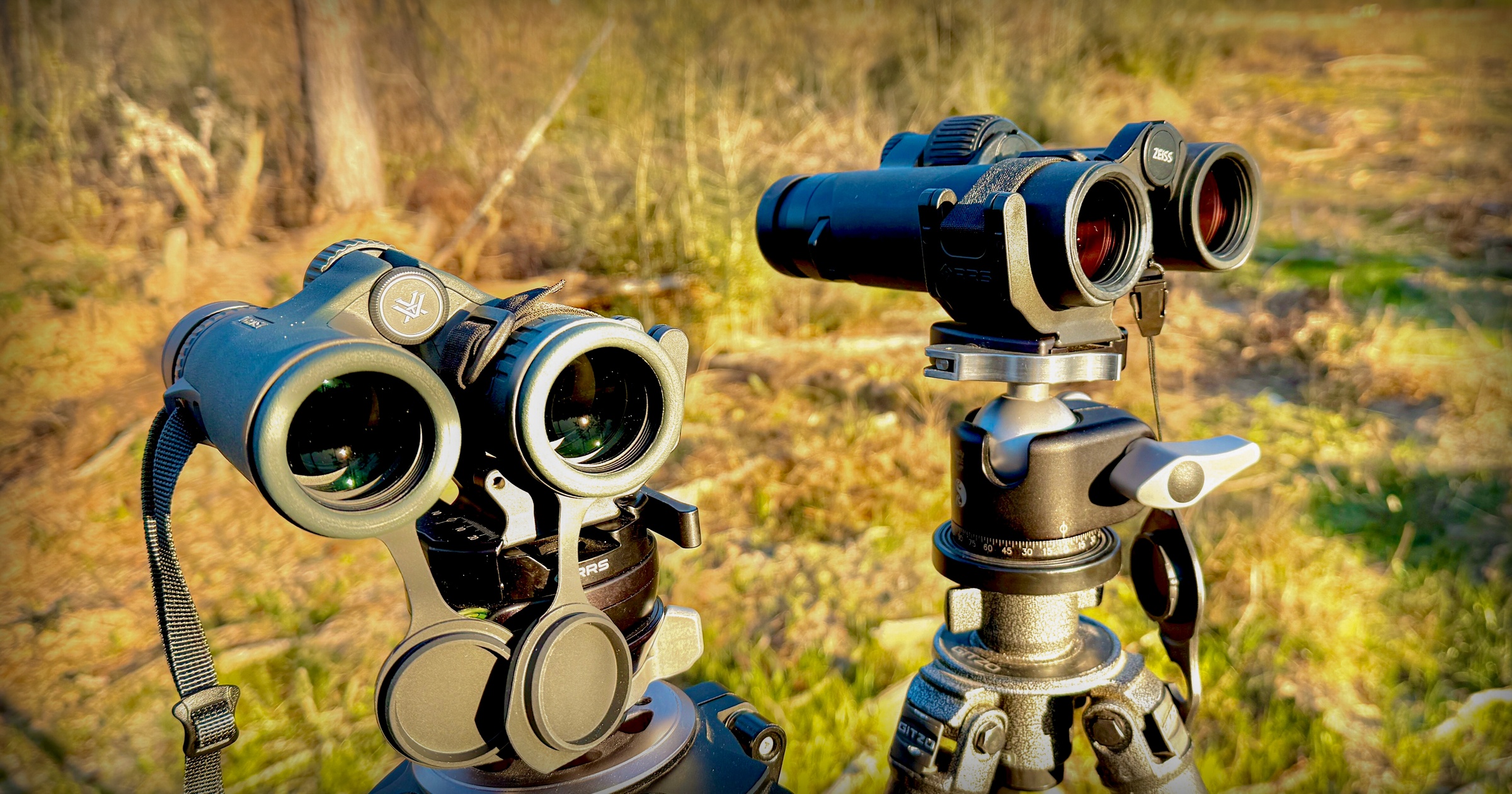

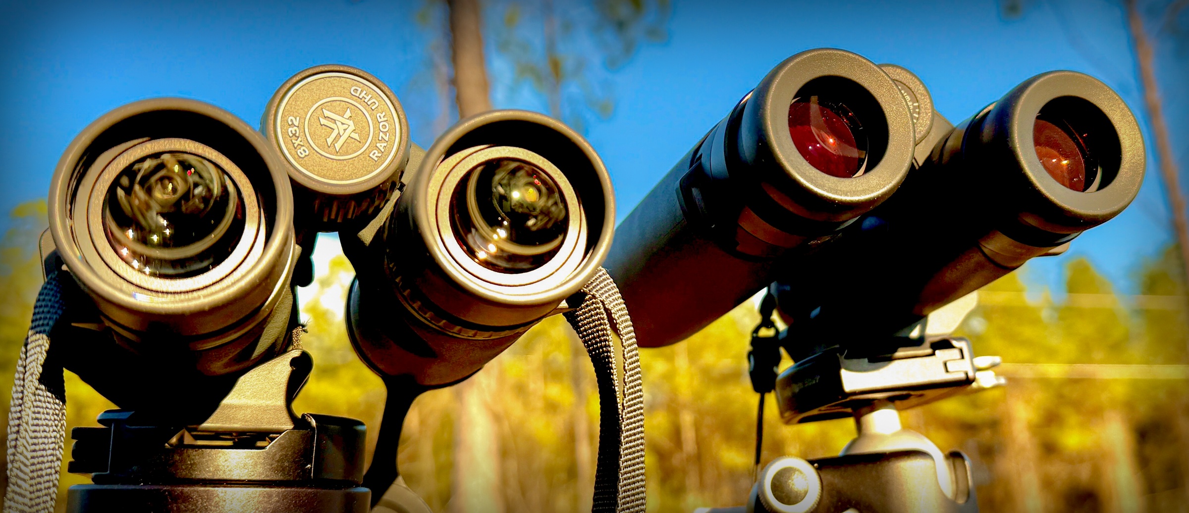

    I thought of bringing in some of the other players but time these days limits me, so just the two:
    Zeiss Victory SF 8x32 and Vortex Razor UHD 8x32.
    I have had both binoculars for about a year allowing me to use them in different situations in the field giving me a good idea about what I like about both along with what I think has room for improvement. One thing to note is that there is quite the disparity between street price with the Vortex UHD running about $1000 less, so that gives the Vortex a significant advantage… let’s dive in and see.

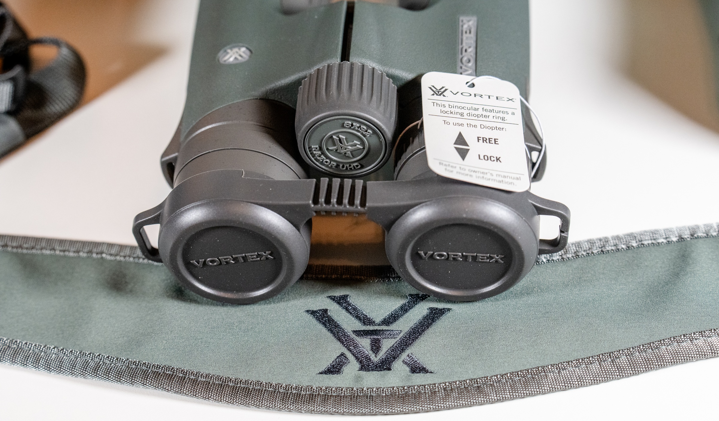

    Diopter Adjustment Rankings: Vortex Razor UHD 8x32 > Zeiss Victory SF 8x32
    The Zeiss and Vortex use the more traditional diopter setting, right in front of the right-side eyecup making for an easy set it and forget it adjustment; however, the Vortex offers a locking diopter which inhibits the ability to accidentally bump the setting.

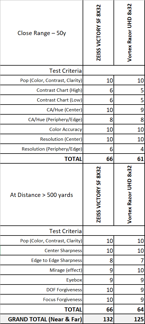

    Optical quality Test Results (higher numbers are better)​

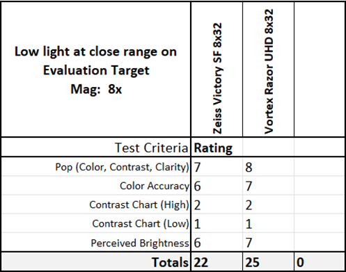

    Twilight Transmission (low light performance)​
    From about 20 minutes after sunset, I begin testing both binoculars side by side as the evening becomes darker and darker. These results are very subjective and as I have aged, I believe my eyes low light acuity has decreased. You may have very different results depending on your age and how good your eyes are. What surprised me in this test was how well the Vortex did with pop, color and perceived brightness – both binos have the same magnification and objective but more than likely Vortex has done something with their glass and coating that give it an edge in low light.

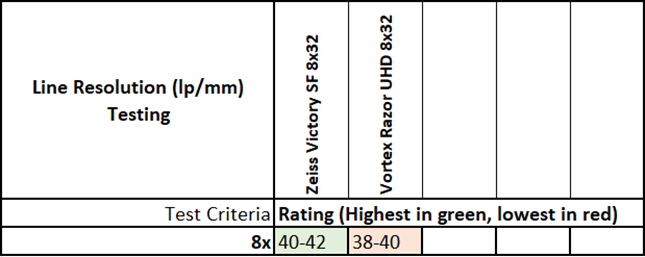

    Resolution Line Chart (LPI)
    It’s one thing for me to look through an optic and judge resolution based on a 1-10 ranking, but it’s quite another to look at line charts and determine how many lines I’m able to resolve at a given magnification, my resolution testing above is a good “first impression” but the line chart does not lie and provides a more quantitative result. For most results you’ll see a range – it is hard to resolve exact values with your eye and I would try to narrow it down as best I could but sometimes eye strain, perfect alignment, etc. would get in the way. The Zeiss had an edge here and this is where it’s $3k glass really shines.

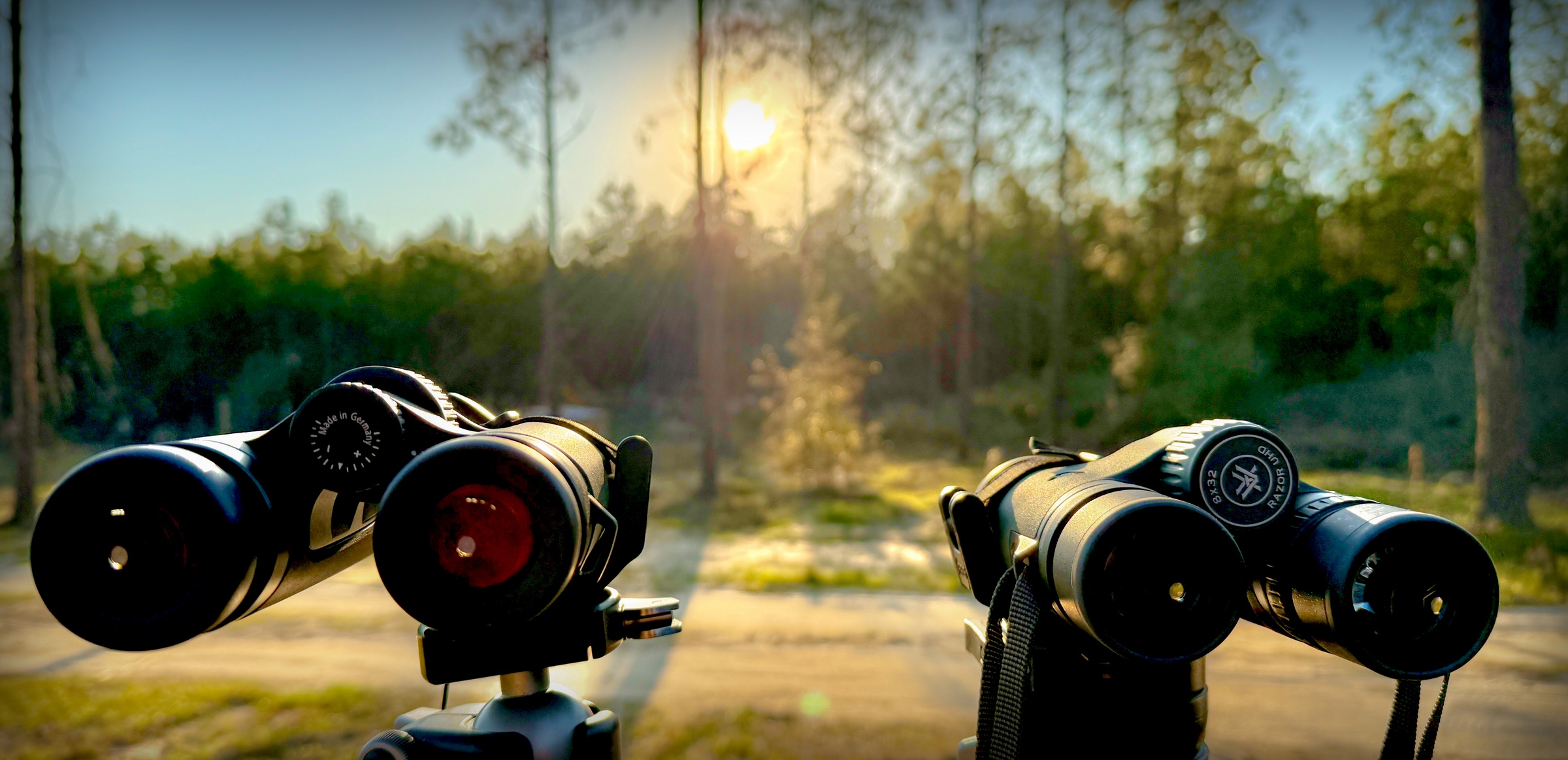

    Flare/Halation (direct sun on objective at 10x)​
    • ZEISS VICTORY SF 8X32: Very good but some wash.
    • Vortex Razor UHD 8x32: Outstanding, very little wash.
    Overall Optical Assessment Results: Zeiss Victory SF 8x32 >= Vortex Razor UHD 8x32
    This was an interesting comparison, first off you have a $3k optic going up against one about half its price from two of the biggest names in sport optics, one has the very best glass from Germany while the other boasts arguably the best glass from Japan. They each have their nuances, in the evaluation above the Zeiss comes out on top with superb IQ to the edges and excellent contrast at close range; however, at distance I actually preferred the “look” of the Vortex over the Zeiss slightly as the Vortex felt like it had a more natural view as well as greater depth, but up close the Zeiss offered a more 3D like view and I felt like I could see the different focal planes of separation between both near and far objects. My thought is this, if your primary goal is birding where subjects will be pretty close the Zeiss is going to win out, but if you are scanning distant objects, I think I’d prefer to be behind the Vortex. I actually did a little “birding” with both binoculars off my feeder in the back yard, fine details in the feathers could be seen with both binos. CA on the Vortex was a little stronger than with the Zeiss and the edge-to-edge performance of the Vortex struggled up close, but the Vortex performed better in low light testing. Hopefully this is enough information to help you make a decision based on your specific needs, I don’t think you can go wrong with either but I would say the Zeiss Victory SF lives up to its name and is the victor here if you’re looking for the absolute best in optical performance, but if you’d like to save a little you are not going to miss much and in some areas have a better experience with the Vortex. For the price, the Vortex offers outstanding price/performance ratio.

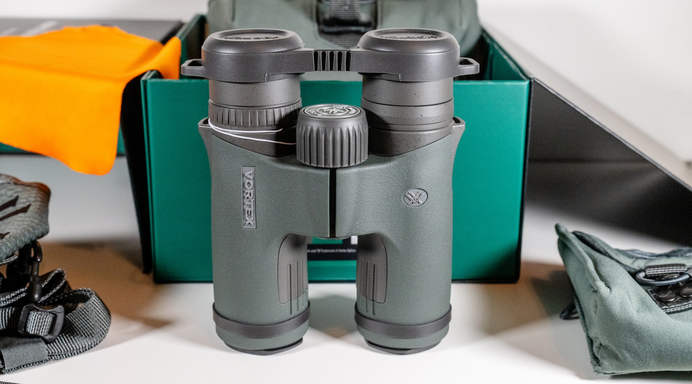

    Below is about as close to an unboxing video as you'll see me get... (sorry I didn't do this for the Victory SF)
