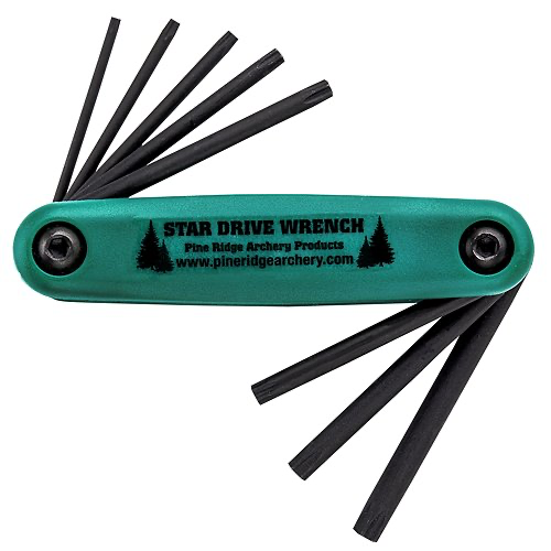

The next day i figured before drilling it out i would try a star drive wrench...they have a bit of a taper and the tool looked somewhat promising in my desperation....bingo, it was so easy, like it was created just for this problem...worked like a charm.

Are you sure the set screw wasn't a Torx head and you were using an allen key mistakenly to start with? Those little Torx fasteners are a mother like that. I am not sure how many times I have done it.
"Star drive wrench" :ROFLMAO: :ROFLMAO: :ROFLMAO: Sounds like something from star wars.
great point, it is a weird name (i had to look up the name to be sure)

this is the type of tool i used:

Small allen or hex head set screws are notoriously annoying. The 2 most common problems with the them are a small amount of material at the bottom of the tool pocket that prevents full depth engagement unless cleaned out first. And secondly incorrectly size drivers... metric used in standard, standard used in metric, and cheap out of spec drivers.

thanks...i bet you're correct, my allen keys were the cheap ones they throw in with all the AR parts that i've collected over the years...i should start investing in some quality tools. lesson learned, it was pretty frustrating.
