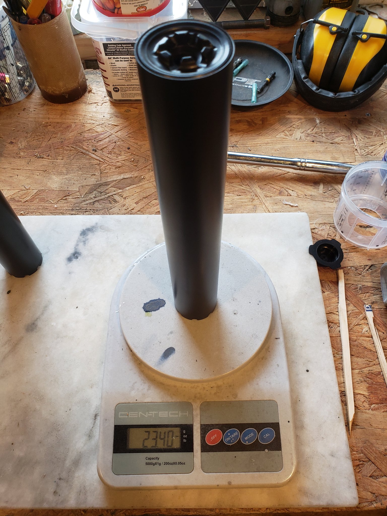

I have not used Nick for any of his SOT services. I have seen lots of his work through my research, and have spoken with him regarding my own projects. Hes a top notch dude, no question. He has some pretty fancy tricks up his sleeves when it comes to recores. I'd wager he uses the serialized part of your tube, over a well designed section of his own, and welds the rest. Guaranteed he lightens it. The latest form 1 i did is 10", Ti tube and caps, all 17-4 SS internals. Shes a whopping.....

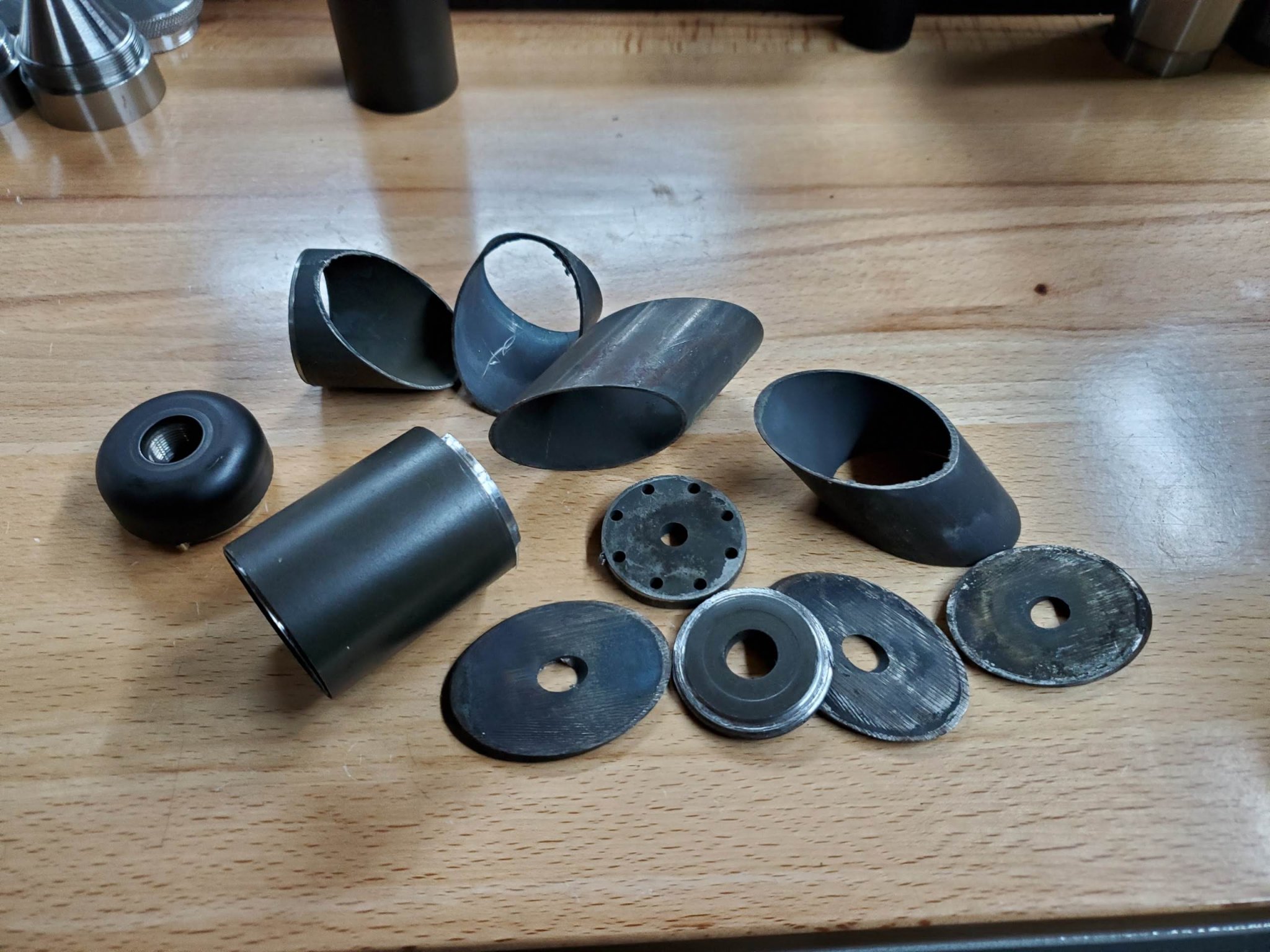

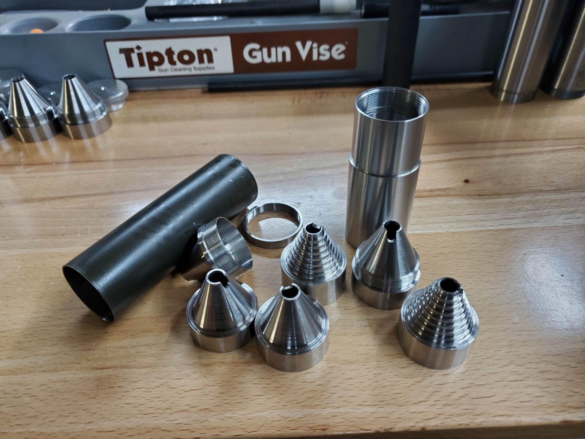

Nick recored an old AAC Evolution 9 can for me. Got rid of the aluminum stack and replaced it with a stainless shielded cone stack. It only gained 3 ounces but now I can clean it once in a while. He also shortened and threaded a Winchester/Uberti 1873 in 38 Special. Absolutely Hollywood quiet and a ton of fun to shoot.

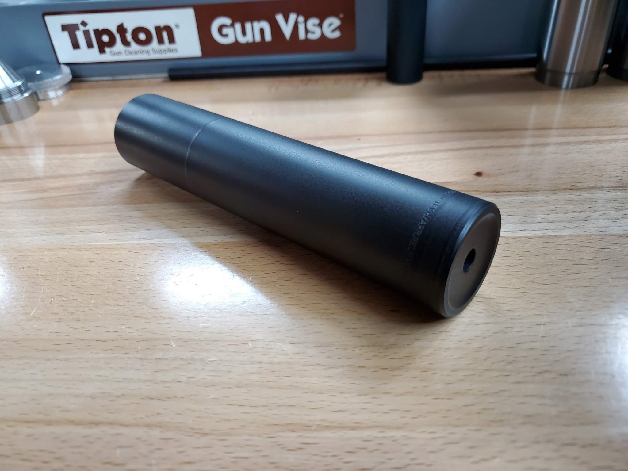

I had them recore an old Soundtech slant baffle .223 can that weighed 23 oz, and had a number of other issues, including not being very quiet. Ended up with a nice quiet 15 oz can for my son’s .223 bolt gun. It was a little under $350 for the work. I debated whether it was a good economic decision, but I got a very serviceable can with no extra tax stamp, and more importantly, no 11 month wait. His wait time is a bit longer now, but he does good work.
