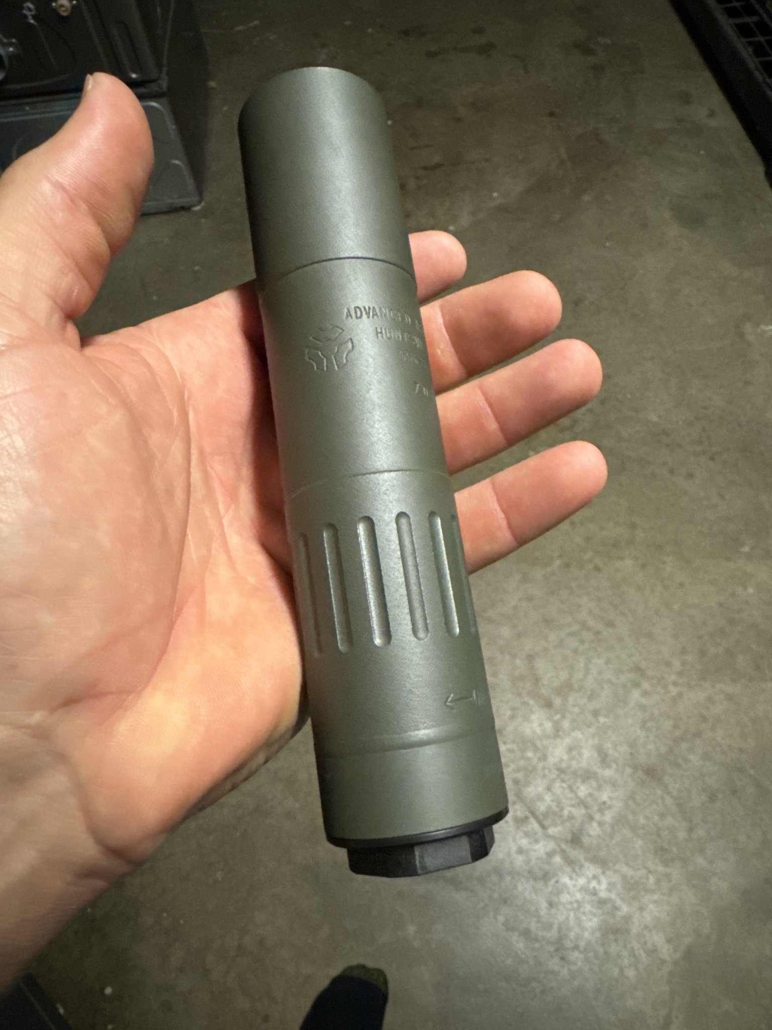

Here’s a picture of my 556-SD. I’d show you their thread work but honestly my 419 adapter is torqued in there really good and it’s late. You can see the weld where they cut off the back and welded on the new HUB threaded section. Cerakote is part of the job too so you’ll appreciate a fresh color on an old can. I know I sure did.
That looks fantastic, just what I’m looking for!

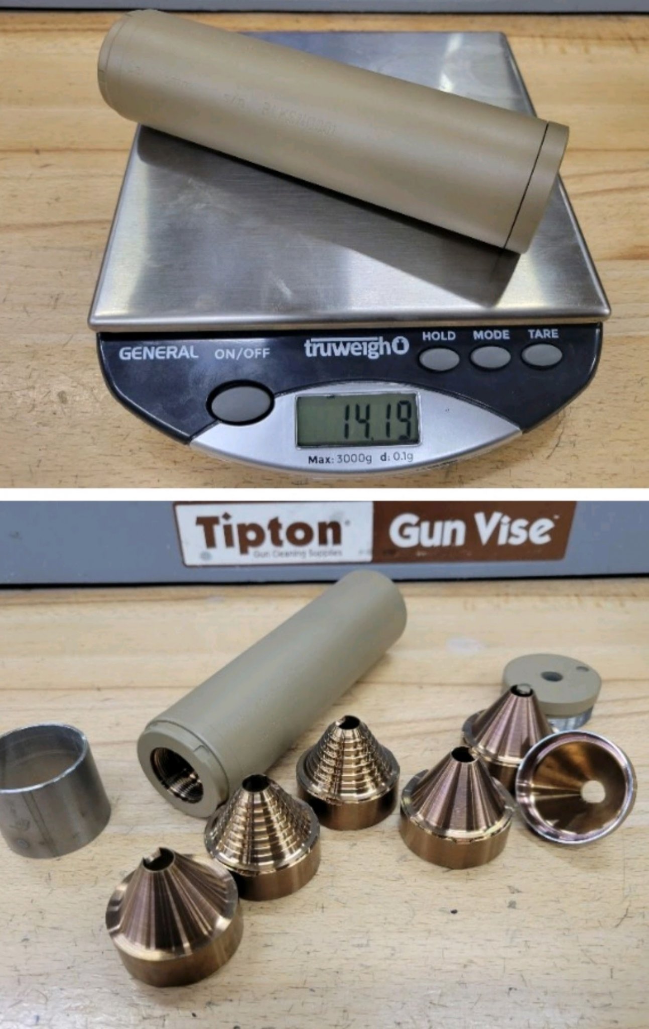

I had a POS from Witt Machine (useless piece of garbage) and had ECCO recore the can and replace the end cap with whatever the Q Cherry Bomb is.
Absolutely worth it for me.View attachment 8397073
I laugh because you’re not the only person I’ve heard that from… All the hype when the Witt cans came out, I was extremely skeptical, and apparently was right to be so. Glad I never bought one, after hearing and reading many legit post-purchase opinions of them.

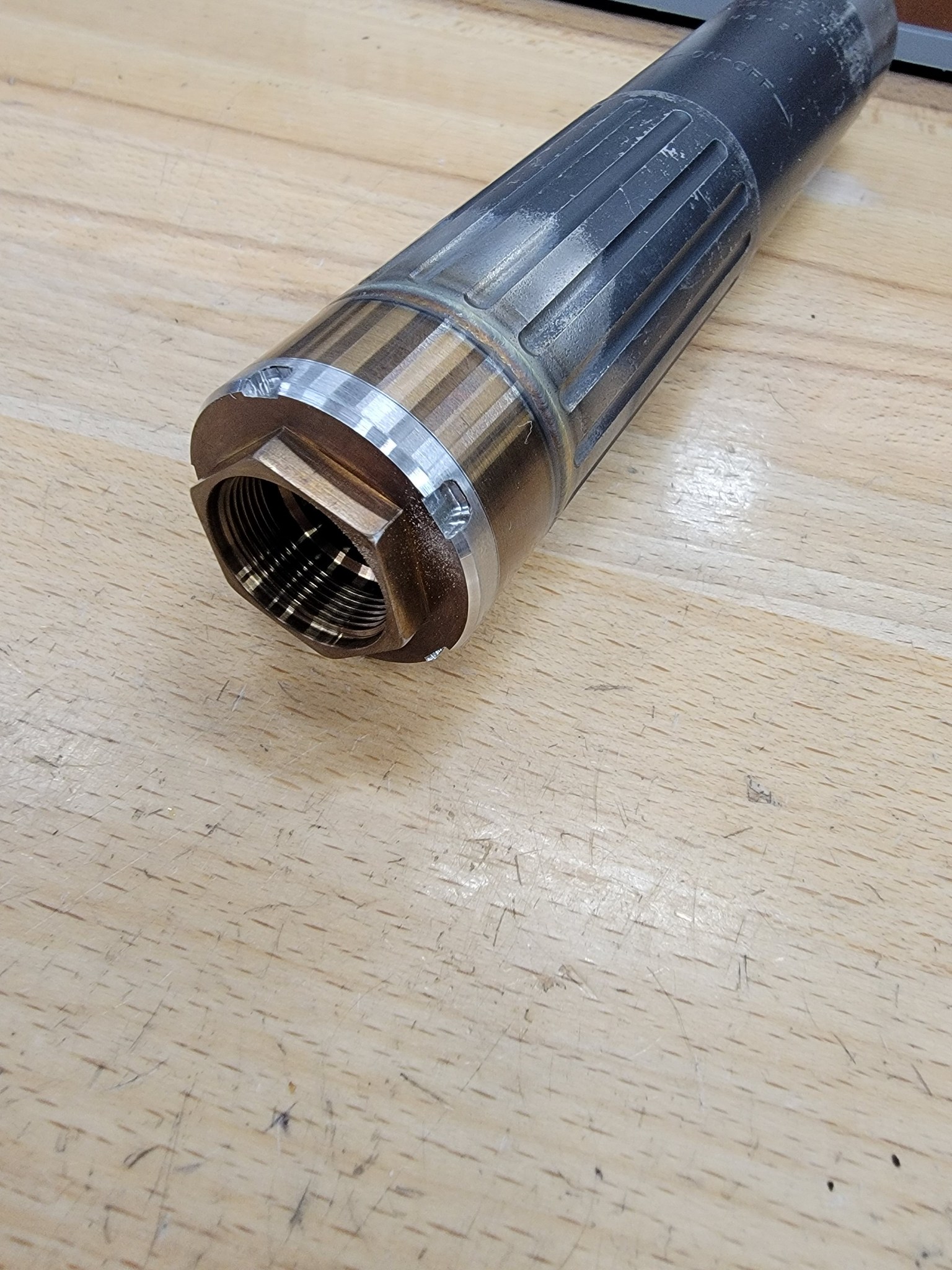

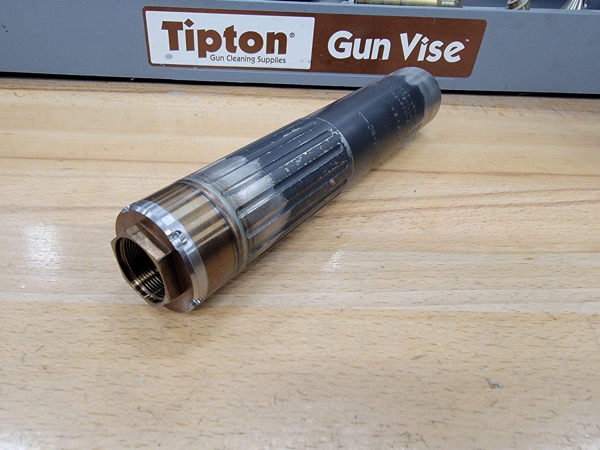

I can 100% vouch for ECCO machine and converting an sdn6 to run a cherrybomb. I got so fed up with that dog shit 51t mount. Sent it in. I can’t remember exactly what was done. All I know is they cut the ass end of it off and re-thread it for a q plan b. Now the can threads right onto a cherrybomb. I’ve shot many one hole groups on two different .308 rifles built by LRI. You won’t regret converting. Here some pics of my now Franken-can.

I can 100% vouch for ECCO machine and converting an sdn6 to run a cherrybomb. I got so fed up with that dog shit 51t mount. Sent it in. I can’t remember exactly what was done. All I know is they cut the ass end of it off and re-thread it for a q plan b. Now the can threads right onto a cherrybomb. I’ve show many one hole groups on two different .308 rifles built by LRI. You won’t regret converting. Here some pics of my now Franken-can.
Looks awesome man, appreciate it. Im going for it! I’ll let you guys know how it looks/shoots when it’s back.
