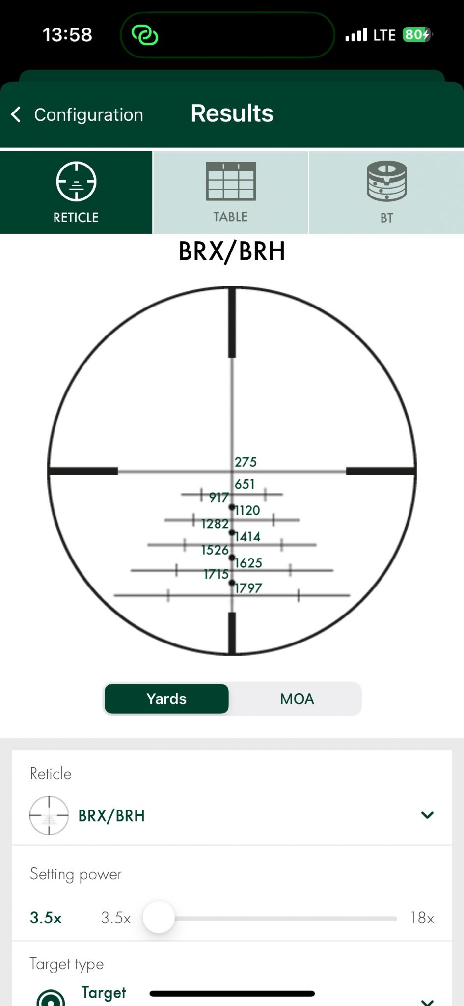

    For example, I have a Swarovski Z5i 3.5-18x44P with the BRX reticle. I have it on a 280 Ackley that is pushing 140 gr Berger Hunting VLD at 3250 fps. I have it zeroed at 275 yards. I used the factory app to start with but then went and verified with actual shots on target. The app was real real close. I have attached screenshots from that app for you showing max, mid and min zooms. I have a piece of cardstock taped to my stock with the verified yardages written using these 3 zoom levels on a mockup reticle. Most of the time, deer are well within my point blank zero and I just shoot them. Once in a while, they are far enough away that I want to verify with the LRF. Then I look for that number on my chart, maybe change the zoom accordingly.
