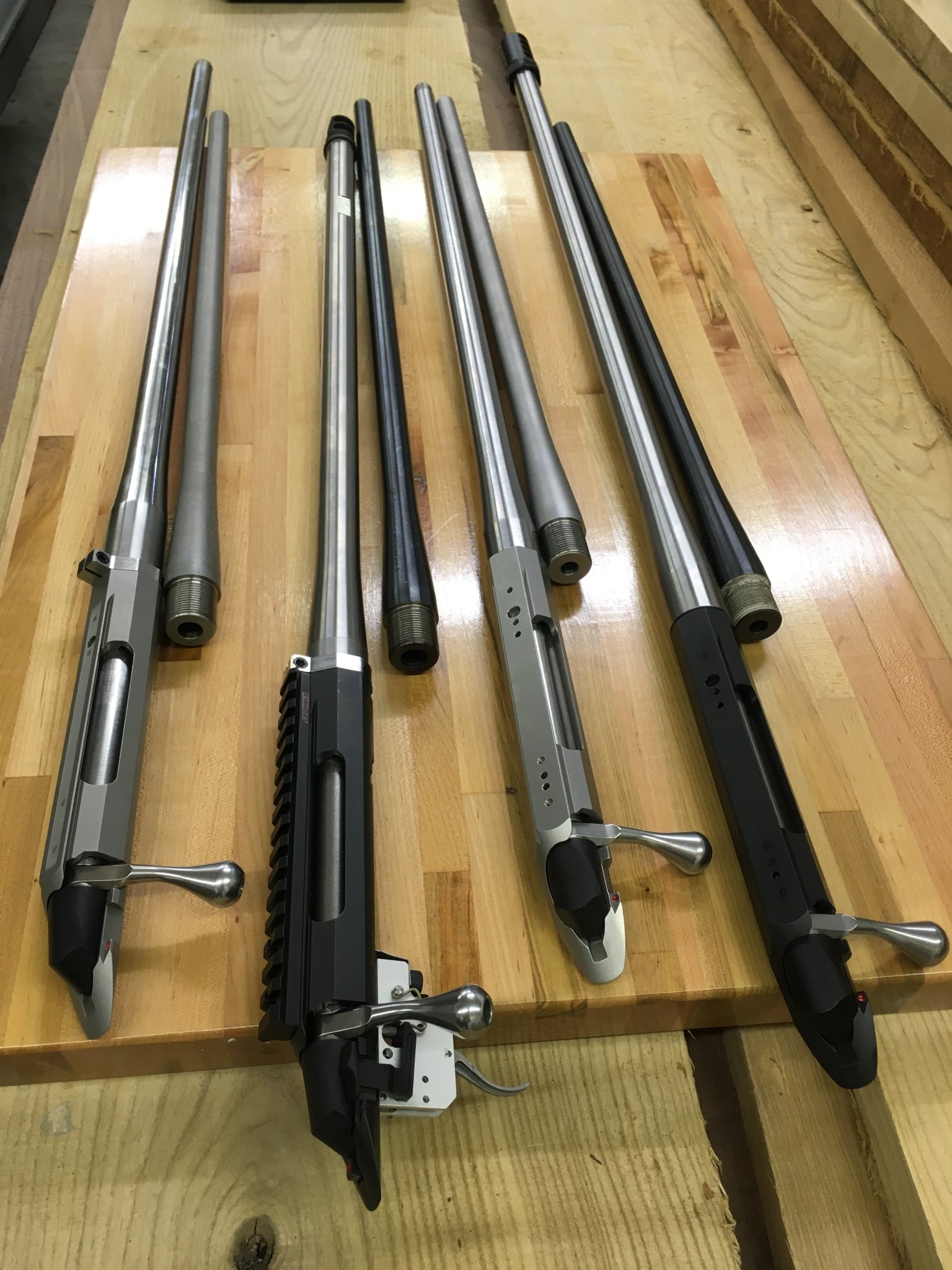

Switch barrel rifles quickly become two rifles... that's the pattern for lots of people.
Barrels are easy to swap with a vice and action wrench. Done well, are repeatable within .1 or .2 mil.
Can be a takedown rifle, within its limitations. Something like the Vector, Switch Lug, that don't require an action wrench and vice are "easier" than torquing the barrel tight.
Experiences vary. It is very user purpose driven.
It was easy to switch barrel, but at the range it was altogether more hassle, so I just bought more actions...
I do still switch barrels between hunting seasons, etc, but it is for an extended time usually.

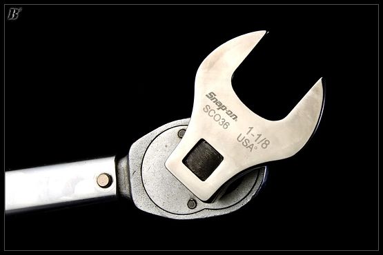

The key is buying a SHOULDERED prefit barrel with WRENCH FLATS milled in the barrel towards the muzzle (see diagram below)
Wrench flat sizes differ based on who does it and barrel contour. You'll then need a torque wrench to put a barrel on AND a breaker bar to take a barrel off and something like a crow foot extension to the size of the wrench flats. (See pic below) (the crows foot, will slightly skew the torque values because you're adding length to the force. Easy calculation tho FYI)
As stated above you'll hold the chassis with the action in it between your legs, then screw on/off the barrel you want. The only concern is being able to hold the chassis/action tight enough to get an appropriate amount of torque. Some users report being able to get 40-55 ft lbs.. which is on the low end of a normal prefit.
All honesty, you'll most likely rarely need to switch in the field. Easier to just get a barrel vise on your bench and do a more traditional way.
Edit: I would buy a set of Go/No Go gauges on every caliber you plan on using to check yourself on at least the first change for a barrel. Always consult the smith with your plan too and double check the torque range allowed on their barrel.
