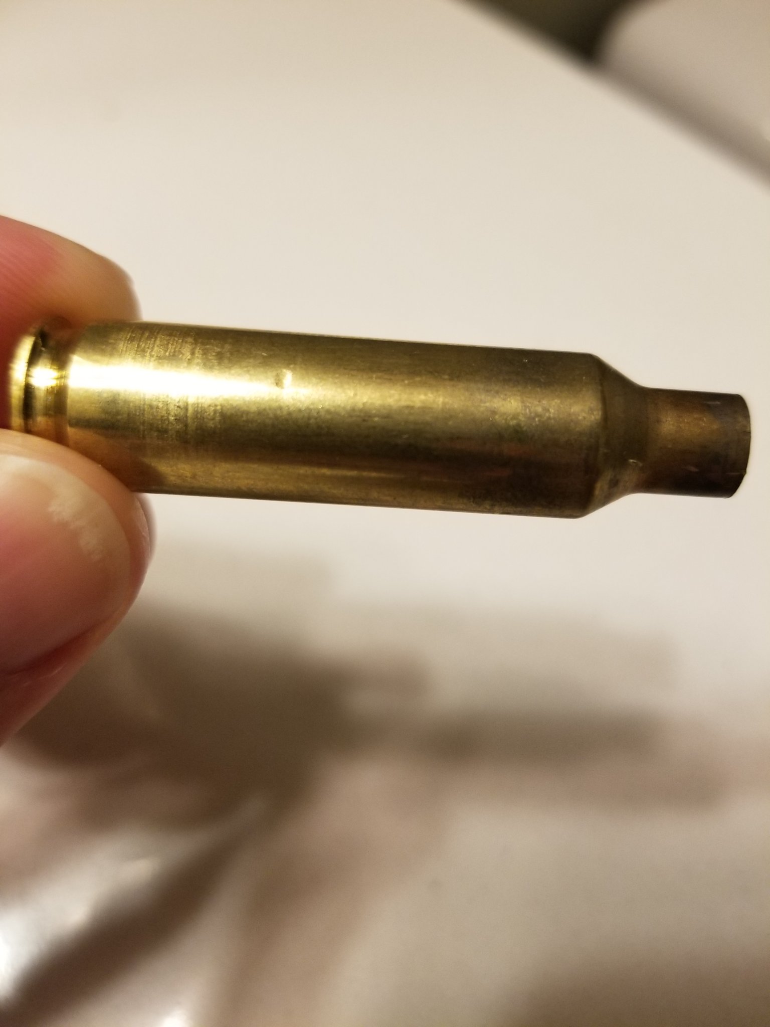

I having started diving deeper into gas guns a bit more than "oh that's cool". I have a Savage MSR 10 Long Range in 6.5 Creedmoor with a Magpul UBR stock It has a 22" barrel with rifle+ length gas port and an adjustable gas block. My issue is that I'm having consistent 2 o'clock ejections and its beating the mess out of my brass when I adjust the gas block just one notch I start having feeding issues. I have spoken to a few different spring and buffer companies and have gotten mixed answers. One said go heavy on the spring with a light buffer, one said the exact opposite, one told me to go as heavy as I can on both and lastly one said to turn the gas block down as much as I can and go with a light spring and buffer. I'm not worried about recoil, I want the best performance and reliability out of my rifle. Does anyone have any recommendations or actual evidence for any of the combos?
Lastly does any of the have any effect on the projectile's performance?
Thanks.

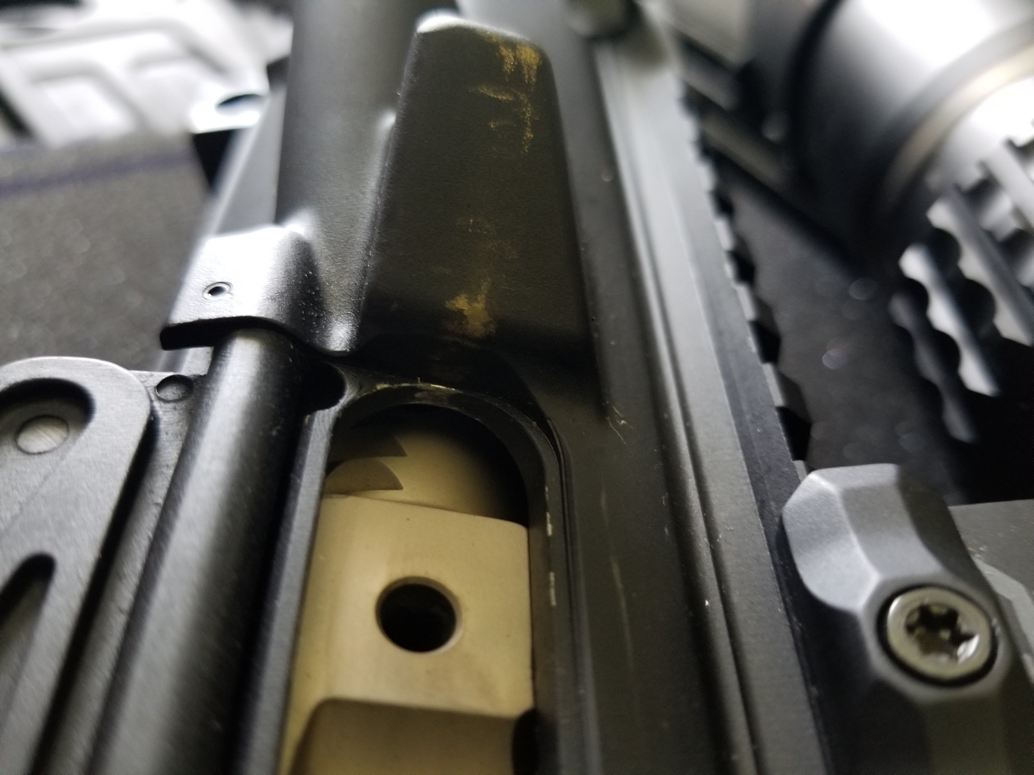

There are the pics. Small indent on the case and paint chipped on the upper. I think the bolt is coming back too fast and slamming the case into the upper not the deflector.

That being said, even a small dent in the middle of a case is frustrating, but there are a ton of guys out there wrecking brass wayyyy worse than that particular photo shows.

That's why I asked because that is not a 2 o'clock ejection. I would take your ejector out and look and see if it has a little rubber o ring, if it does remove it and test. Another solution is to take your ejector spring and clip a 1/16th off the spring, this will tame down the pressure and force of the ejection of the brass... And, that is not that bad for a gasser on brass.
I appreciate the responses guys, I'll look in to what eklarsen recommended. The rifle does have dual ejectors. Man I'll have to look up some really wrecked brass, haha. Thanks guys
How does the rifle shoot? Is your concern about the brass damage? Put a small piece of adhesive backed fuzzy Velcro strip on the deflector (the mark on it will tell you where). This will cushion the impact just enough. Being black, it will be almost invisible on the upper. Or, get a brass catcher.
