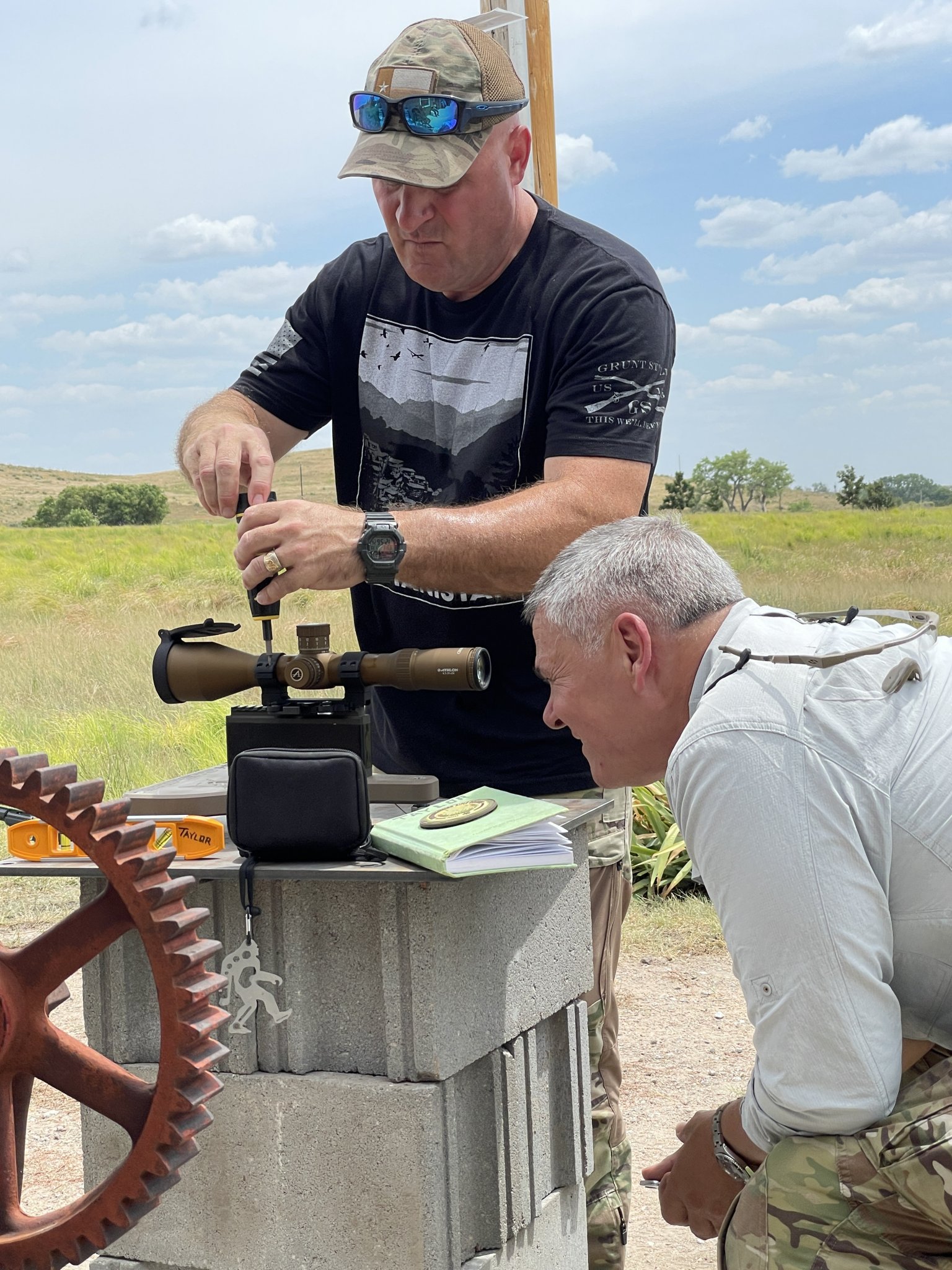

@harry_x1 if you think this is something you will do more of, save yourself a lot of frustration and buy one of these.
this makes leveling a reticle so easy I can do it in under 10 minutes. Here @lowlight demonstrates.
i cannot recommend this tool enough.

I teach Basic, what I call Day One Precision Rifle Classes, we call it the Fundamentals. We focus on rifle set up and adjusting the rifle to the shooter, the analogy I use is your car. If I move a seat or mirror in your car you would immediately know.
If the shooter sets the rifle up correctly, understanding their own body, and comfort level, things go much better. Instead, people randomly set up their rifles to a concept vs a certain level of comfort. Because of this fact we pull every scope today to test for tracking and to demonstrate parallax as well as check the reticles. We find at least 1/3 of scopes are canted in the rings.
Once that is fixed, we have just over a 1/3 of students who are either heavy-headed or pull the rifle over on a loose bipod, so they are inducing cant.
In all these cases, levels are usually viewed before Shot One, you check before you shoot, then once you start shooting you ignore it, meanwhile, shot 2, 3, and 5, are canted. You can see the groups tipped over. This happens every day, with a noticeable amount of students.
The level itself is an idiot light saying your car has a problem, it does not fix the problem if you don't understand the problem and nobody understands it. They think if they match the rifle to the scope via a $6 vial of liquid, they are good. Never understanding how they go smell blind to the issue, and induce the cant while shooting.
I would rather have a crooked scope on a comfortable rifle than one setup level to the rifle that I constantly push over. I can fix the shooter with a predictable lean, it's the ones that fight the notion to move the system so it fits you better.
Here I physically roll the rifle over, enough that would bury a level, (if I used one), I wanted it noticeable, but sort of on the edge of what a person would notice themselves. Because at a certain point everyone who cants notices when they go too far and fix it. The 5-degree examples often used a STUPID because nobody cants that far accidentally if you do it on purpose you probably understand (like I show) who to account for it.)
Lastly what I will say is get up a bit higher on your elbows. Think of our children, go back in time when we used to lay on the floor and watch TV for hours. We never had to teach kids or ourselves as children how to hold our heads up comfortably. If you get off your forearms the raising of the body keeps the head straight. When your head is rolled your odds are canting the rifle increase 10 fold. This stuff matters.
Any my contribution while i am here ...
