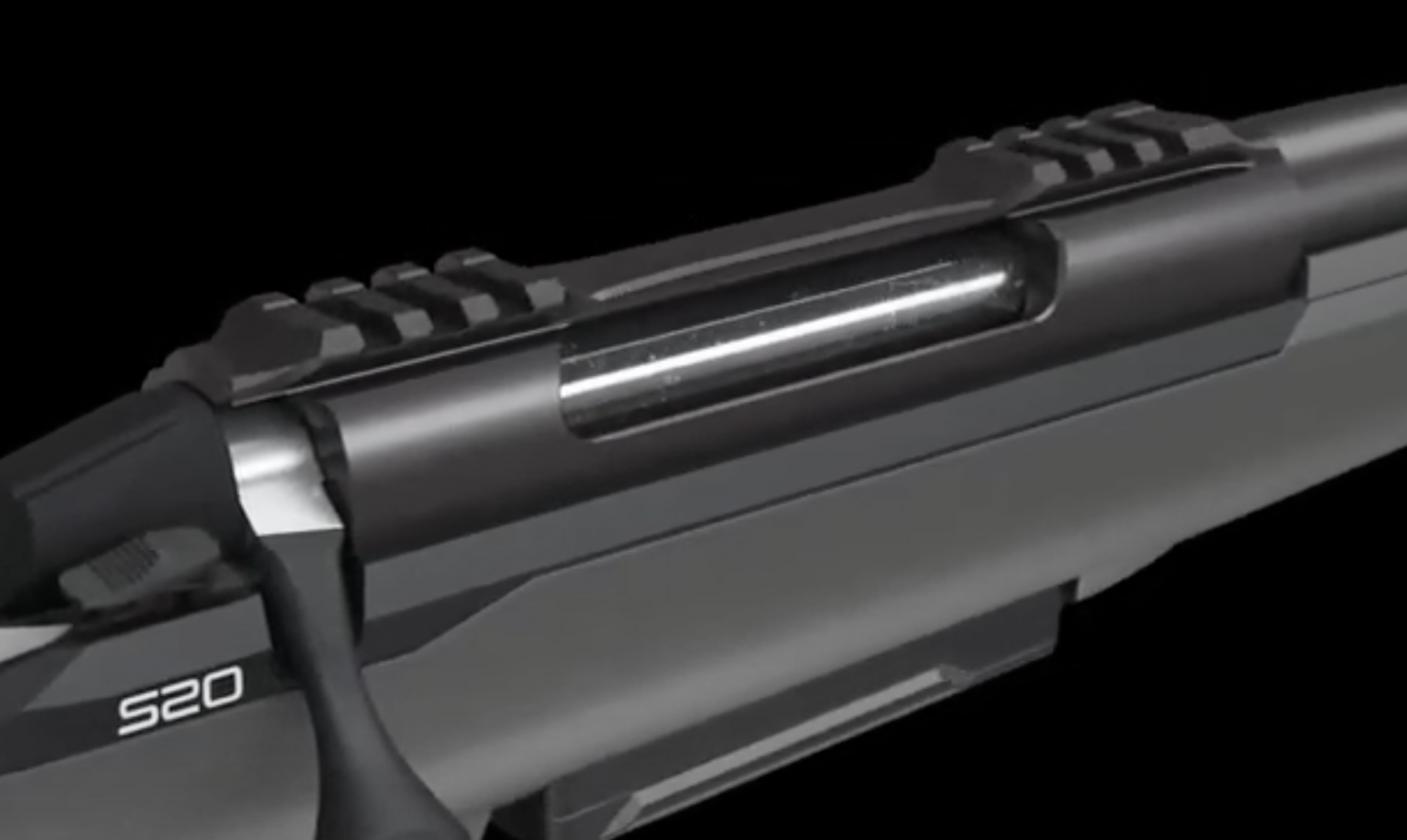

lastly, I am considering getting a Sako s-20, which has a built in rail, but kind-of in 2 pieces
I want +20 Moa for this rife, how do I accomplish that?
add a 20moa Picatinny rail on top of the built in rail?
do they make 20 Moa rings?
get a one piece spur mount with 20 Moa and secure THAT to the built in rail?

they said NONE of their unimounts would work on the s-20, because of its two part rail design :(

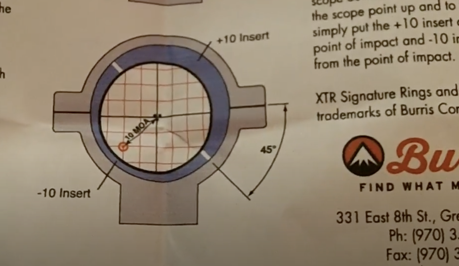

very interesting, just watched one video, he had this image of the instructions :
I see how there's a thinner and thicker insert.
the instruction image indicates they they should be offset from horizontal by 45 degrees - ie the ring's equatorial line is NOT parallel to the INSERT's equator.
seems like that is going to introduce some left/right can't, as well, . . . doesn't it?
well, now that I watch a 2nd video, it seems they do NOT have to go in at an angle, and CAN go in with equators aligned parallel to one another.
it seems that the example above is if you are trying to move your p.o.i 2" down, and 2" left.
DO I HAVE IT RIGHT, NOW? FINALLY, after three updates

very interesting, just watched one video, he had this image of the instructions :View attachment 7481937
They can be aligned in any position, its at a 45 angle in that pic merely for an example. I plan to pick up a pair to add elevation to a rifle I cant 15 degrees to the left.
BTW, the amount of elevation they add is dependent on the ring spacing.
Hawke also makes rings that can add elevation (but not cant)...
Reactions: Protondecay123
so isn't the elevation (adding Moa for distance) just "windage neutral" cant,
whereas if the "equators" aren't aligned, then it is adding +/- elevation can't AS WELL AS +/- windage cant?
do I have that right
Yes. Unless you decide to use them to optically center the scope instead of to add elevation.
The rings come with neutral spacers, you have to buy separately (on most) if you want to adjust elevation with the scope.
If you use the offset shims, you can use them to optically center a scope (I do this on airguns), or to add elevation. That is what the guy in the video is doing.

the easiest way to add MOA to a fixed rail will be with a one piece mount (spuhr, for example) that has built in angle. It’s possible, I think Burris sells something, to shim a set of rings to include some angle. I’ve never used that setup though.
Did that to a Sako, gotta watch the ejection...
