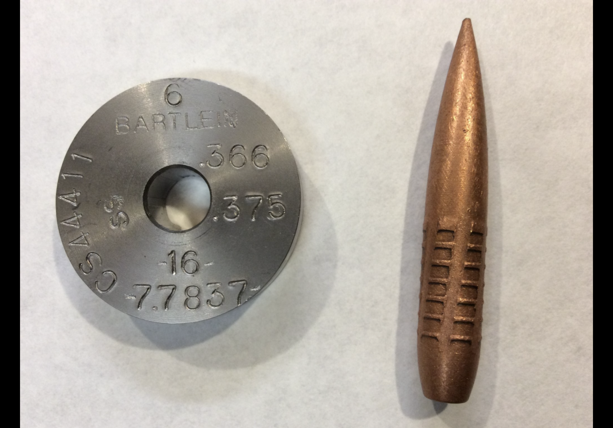

I have a few Bartlein gain twists, couple 308's didn't notice any reduced pressures from std. Bartlein barrels. They do seem to be easier and more forgiving for load development. All my gain twist are only .75 gain as recommended by Bartlein. An interesting note though is with the 416 pushing 500gn. A-tips around 3000fps w/gain my bullets stay together & my buddy's with a std. twist at the same velocities seem to "evaporate" randomly.
Reactions: oneshot.onehit
I just sent a Bartlein 6.5 cm MODBB left gain twist barrel to Altus to be spun and mounted on a Deviant.
I too went w .75….8.25-7.5.
I’m not expecting miracles from it but hopefully it will be a bit more gentle w my bullets which will be somewhat helpful.

My thought was that having a gain twist would take some of the initial pressure and make it easier on the handgun. Frank explained that a gain twist would not accomplish what I was after.
Using very careful loading techniques, the load proved effective against 65 pound steel rams at 200 meters. (They have to be knocked off of the stand, or the hit does not count) However, the little handgun was much happier with 69 grain Sierra’s usign it as a half scale gun for which it was intended.
