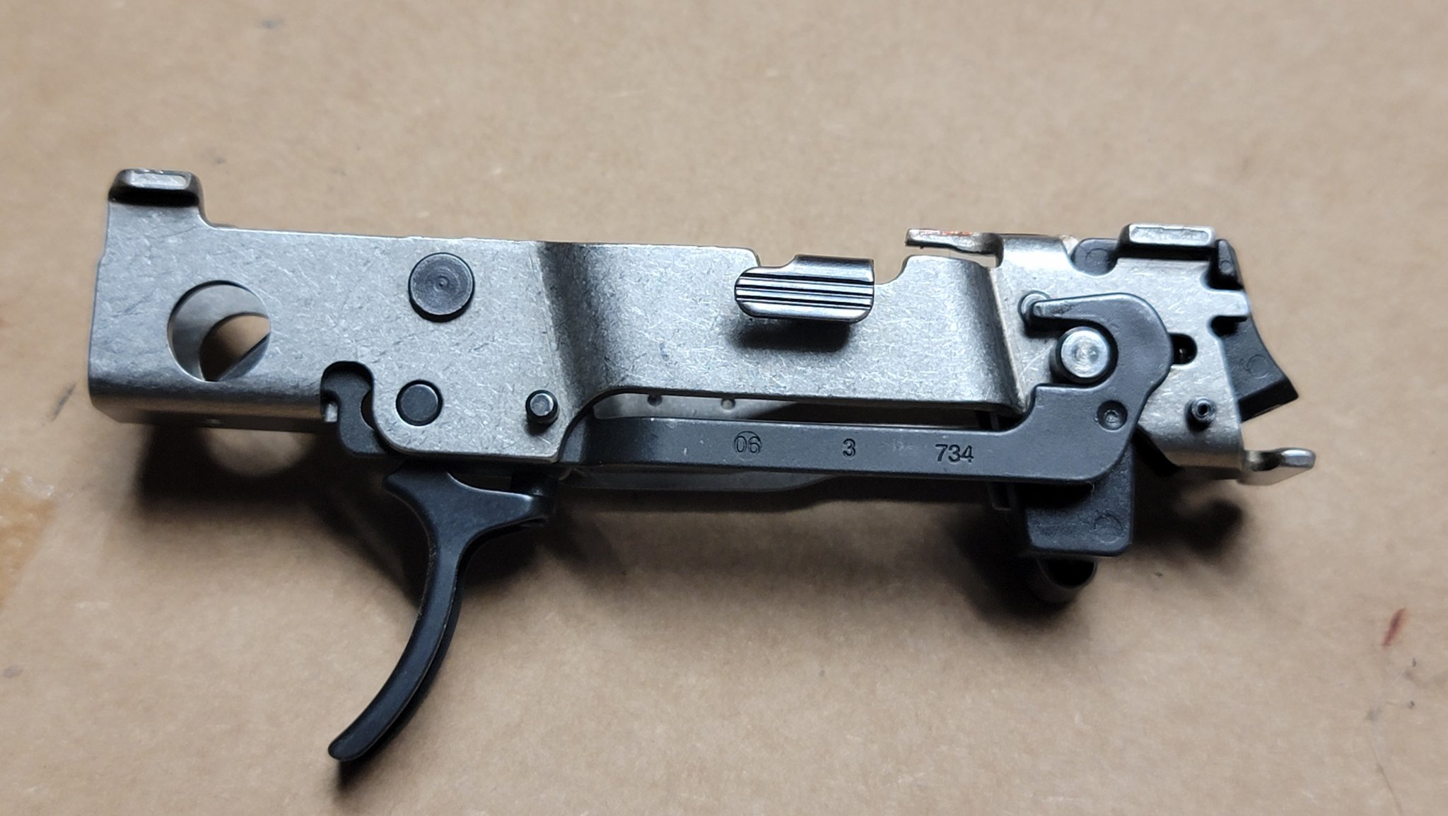

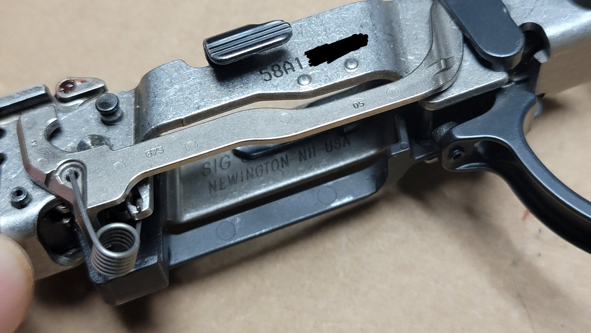

I'm PLANNING to SBR one of my Sig P320 FCU's for use with the Strike Industries SMC (basically another FLUX type system)
The question is, how would you suggest engraving the FCU, and once it's done...do you need to mil a slot in the "grip module" so that it's visible?
I realize being visible from the outside is required, BUT...the FCU is the actual registered part and the Manufacturer, City and State are NOT visible from the outside of a fully assembled pistol either. (which i assume is also required for the OEM MFG)
TO ME, based on the factory markings, it would make sense that the engraving could be on the left side...and the fact that it's not visible when a grip module is attached should be irrelevant.
What say you?
ALSO, the name of my trust is rather lengthy... is truncation or abbreviation due to the limited real-estate on the FCU?
