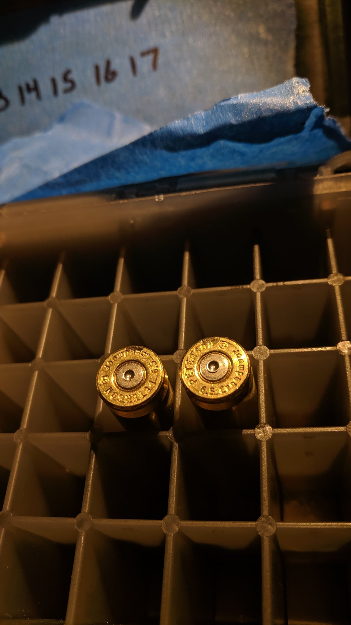

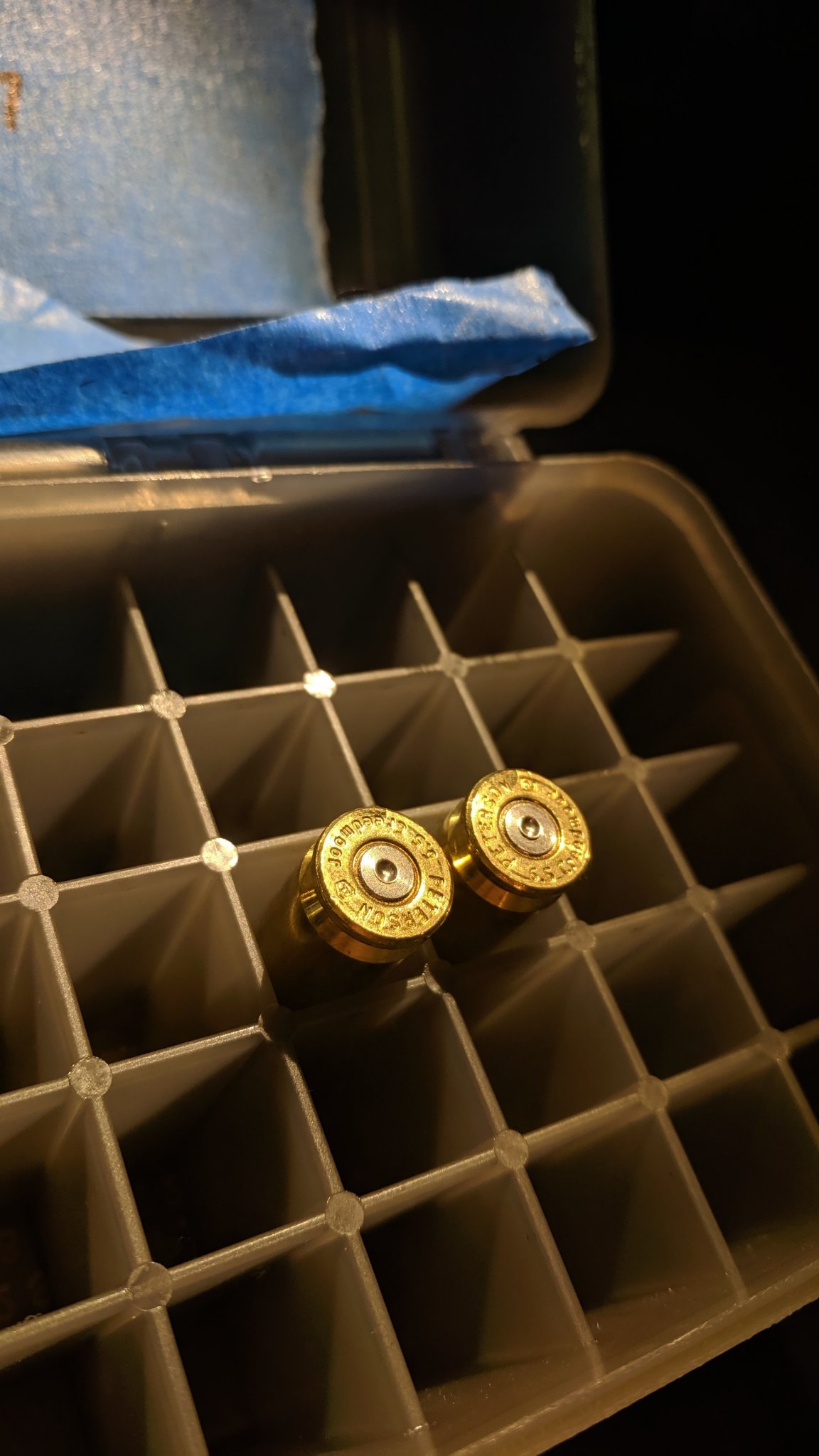

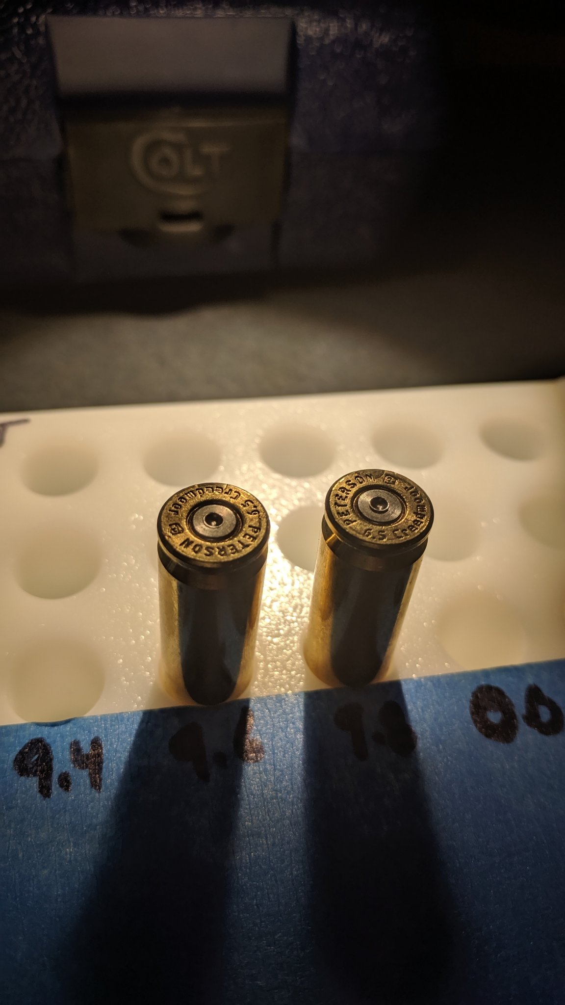

So I have been trying to work up a load on a 6.5 creedmoor barrel for my AXMC. It seems like I'm getting primer swipe no matter what. I have loaded the rounds and ejected them without firing to make sure they were not to long. The case on the left is 39gr H4350 at 2677fps. The case on the right is 41gr H4350 at 2791. 147gr bullets in Peterson fat neck brass. I don't want to go below the 39gr but if I'm getting swipe no matter what should I just say screw it and run the 41gr? Both have an awesome group with single digit ES/SD.

The case on the right definitely has significant primer flattening and cratering. You definitely need to back off from that.
Both cases have noticeable ejector marks but I'm not seeing any ejector swipe. Possibly you just have a sharp ejector that is cutting into your brass.
