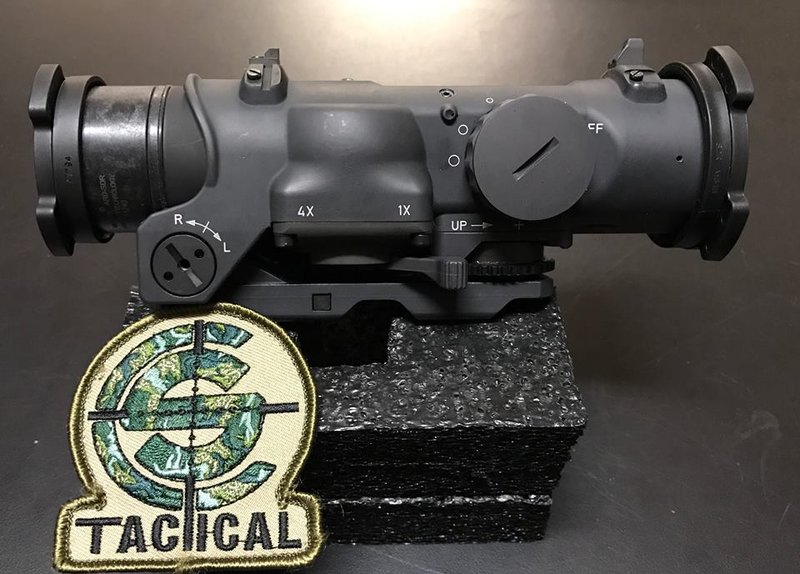

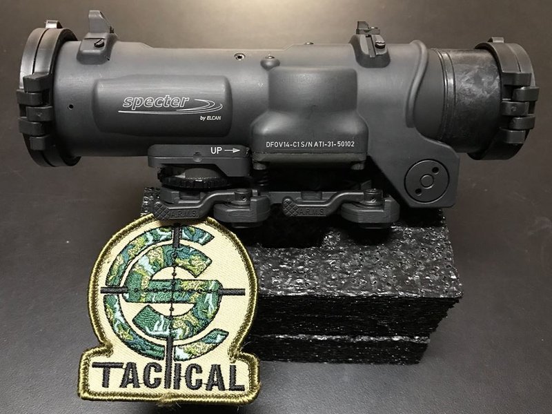

Thinking seriously about getting the 1-4 Specter. For a shared home on top of an SPR and an M4 build. Plan on running BH 77TMK 5.56 exclusively .
Anyone have one and fell out of love with it ?
TP...
