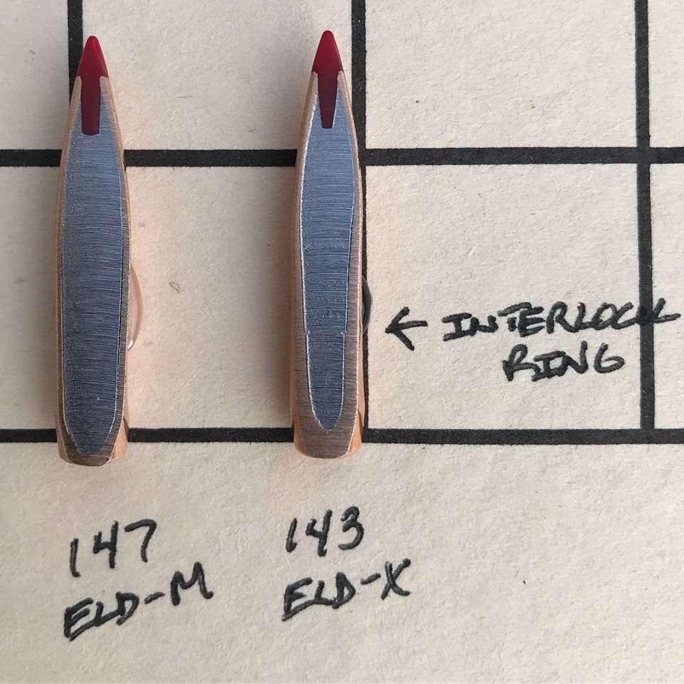

The ELD-X is a little more expensive than the ELD-M. In 178gr. .308 it is about $3 per box (43 vs. 40). The BCs are similar. Curious why they are more expensive. Same difference for a 6.5 (although the bullet weights are a little different - 143 for the ELD-X vs. 147 for the ELD-M).

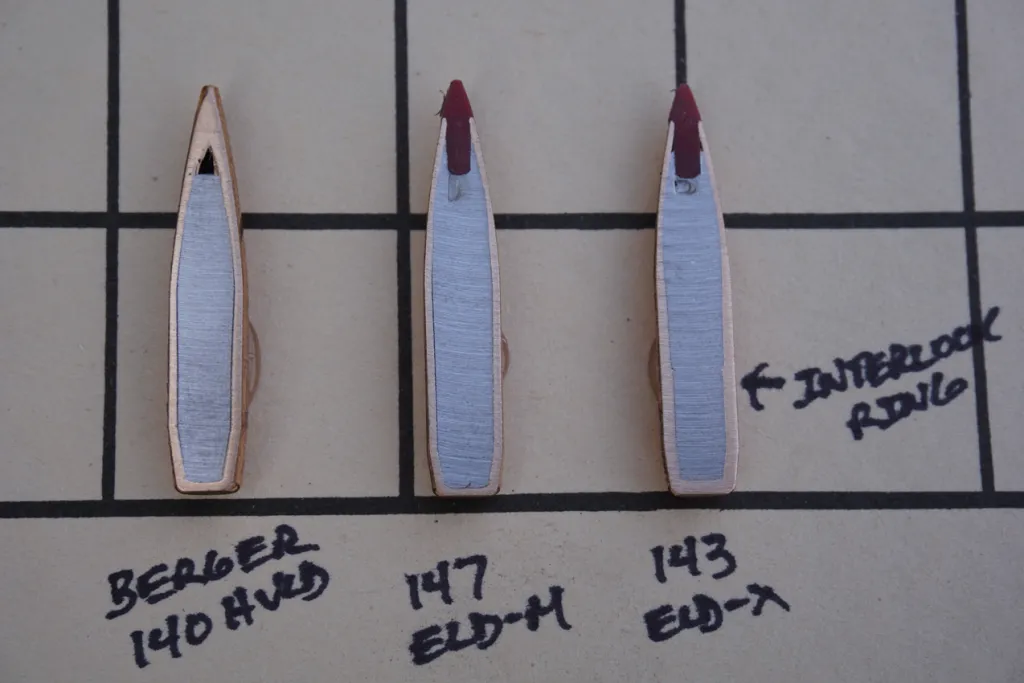

The X is intended to expand. The regular matches aren’t.
Notice the jacket thickness and the interlock ring if you zoom in.
Yes, I knew that the X was a hunting round , designed to expand, etc. Just did not understand why it was more expensive. I guess they charge more because they can and hunters are willing to pay more. I do appreciate the construction differences details though!
For PRS shooting, there is no downside in shooting the -x is there? Other than wasting money, right?
The taper in the jacket requires more steps in the manufacturing process. More dies to be made to draw the tapered jacket. Add the interlocking rings again adds a step. That adds to the cost. There's more copper jacket material too, but the labor and added perception of a "hunting bullet" is what adds to the cost. Just my 2 cents worth.
With that said I sell 6.5 CM 143gr ELDX ammo all the time to my local hunters. One hunter took a huge ram, big buck, and a nice cow elk this year while hunting. I've seen a few decent bulls fall to that round too. I haven't got to hunt with ELDM's on big game yet but that's what I'll use in my 260 AI, 7-08, and 7mm RM. I've dumps a few big badgers with a 75gr ELDM in my AR. A couple of yotes fell to that combo also. I'd just keep the impacts on big game under 2600 fps and above 1800 fps with the ELDM's for the most reliable performance. I'd also stay off the front shoulder and go for the crease.

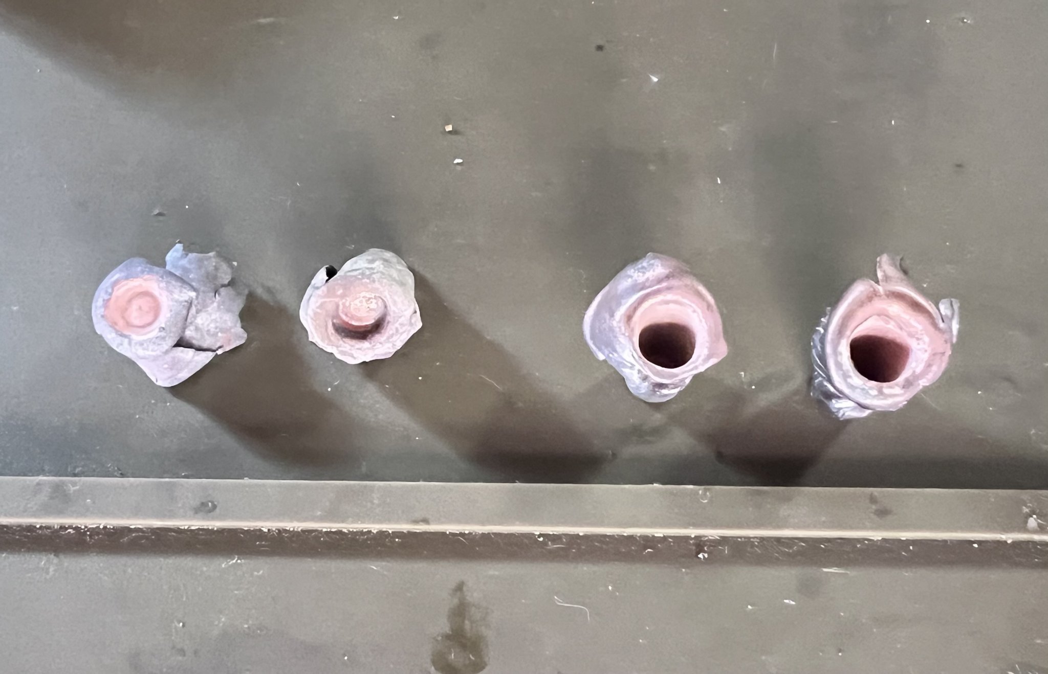

One of my kills with the ELDx, the fist size entrance was larger than the exit. I couldn’t figure it out at first. Then my hunting partner came up with the answer.
It appeared that the bullet had shed & shattered it’s jacket on impact and the core kept going leave a clean small diameter exit wound. This was a doe antelope. Unfortunately those fragments went laterally as they penetrated. This load was going a modest 2944 fps at the muzzle.
Bergers are specifically designed to “grenade” according to Berger.
The problem is these fragments deflect going into places they shouldn’t and meat loss.

So again the added taper requires more steps to the manufacturing process. The last manufacturer I worked at even started using EDM to speed up the manufacturing of dies. Then each die has to be hand polished and tested. Then the jackets and cores need to be QC'ed at each step. It all adds to the cost of the finish product.
