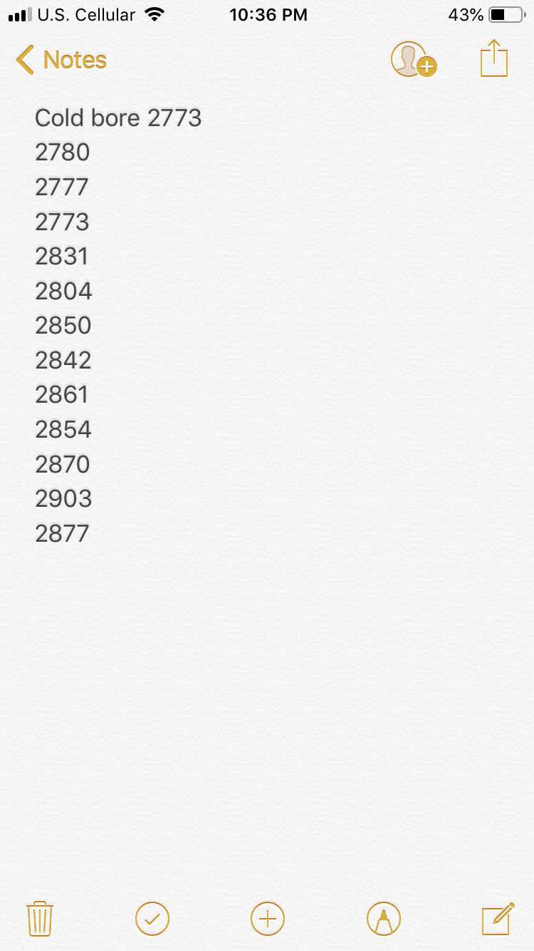

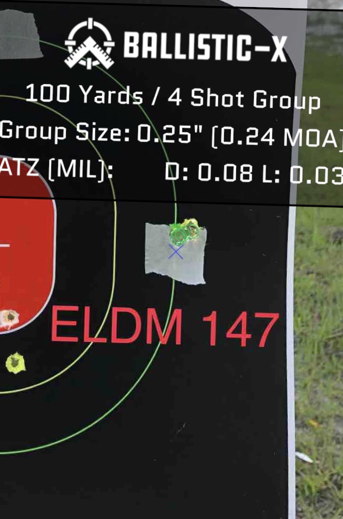

Was shooting some ELDM 140 at 276 yards today and using the ballistics x app to give me dope. First shot a touch high. Made on click correction and was dead center the next 3 shots. I plugged in the correction into the muzzle velocity truing and it spit out 2,848. Can that be correct. Rifle is Savage 10 6.5CM with 22” barrel, 1/8 twist. I have 2,700 plugged in for velocity with the 147’s and it was right in with the apps dope call.
Think you nailed it. Here is the zero offset at 100 before I went to 276.

I don’t know if this helps, but if you’re speaking about factory loads I believe it. I’ve pulled several eldm rounds and weighed the powder to find out their loaded really hot from factory. 43.7 was about average only being off a grain or two here and there. Same for hornady bulk 140 bthp. I reload mine at 41 grains of 4350 and get 2700 fps avg and 2690 with Berger hybrids. Maybe someone else can chime in here that’s loaded hotter I’m not sure if 2+ grains will give you an extra 148fps increase or not but Id bet it’s probable. Good luck.
If you're chambering the round from the mag, then waiting the 20 seconds to fire, then the cartridge is heating up as it sits in the chamber........., and so is the powder.
As successive shots are made, the chamber heats up more, causing higher powder Temps and would contribute to the increasing velocity Trend.
^^ yep. Fire one , extract immediately after follow thru and leave bolt open , dont rack another one if you are testing ES / SD.
Once you are back on target and comfortable , rack another and fire asap. Bout 5 rounds per set is enough unless you are in really
cold conditions . You can easily test the effects of cooking a round if your chrono is working properly ; try running 5 shots in 30
seconds or less , then leave the 6th shot in the chamber for at least 30 seconds before firing .
This issue is one of my biggest problems teaching ELR classes ; its right next to guys taking 15 seconds to shoot after a
wind call ....... Borrow a better chrono if you can , Magnetospeed or Labradar will tell the truth pretty quickly .
whole lot of this. almost every shot gets faster as chamber heats and powder cooks getting hotter and hotter
I learned my lesson one time with this:
A while back, I was doing some positional practice and let about 20-30 rounds go in about a 3-4 minute time span. Decided to shoot a couple of my "borderline" high pressure/velocity rounds I was testing and had shot 10 or so of them at the beginning of my session when my barrel was cool.
Chambered one, got distracted for about 30 seconds. Fired it. Pierced primer, heavy bolt lift, had to pound the bolt to extract.
I was able to take a dental pick and pull out the primer by hand, had the most distinctive ejector swipe I have personally ever seen.
So, lesson learned. Get on target, chamber, then shoot within a couple/few seconds. OR don't be in a rush and just let the chamber cool down.
