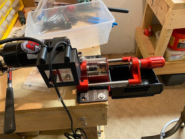

    I had a dillon , sold it, Now using a Henderson and love it. I have athritis and it's easy on my hands Chamfers the case while it trims it .
