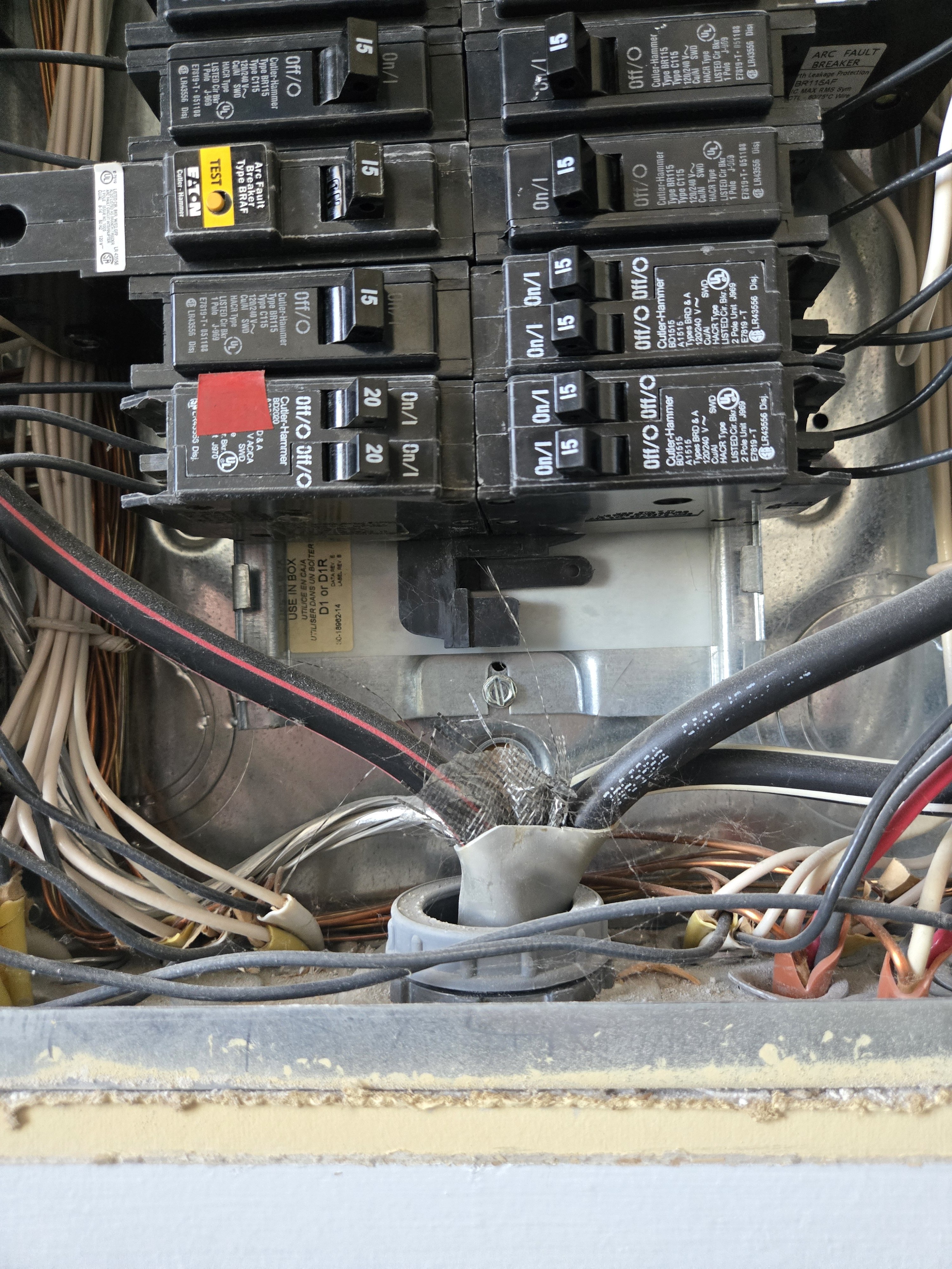

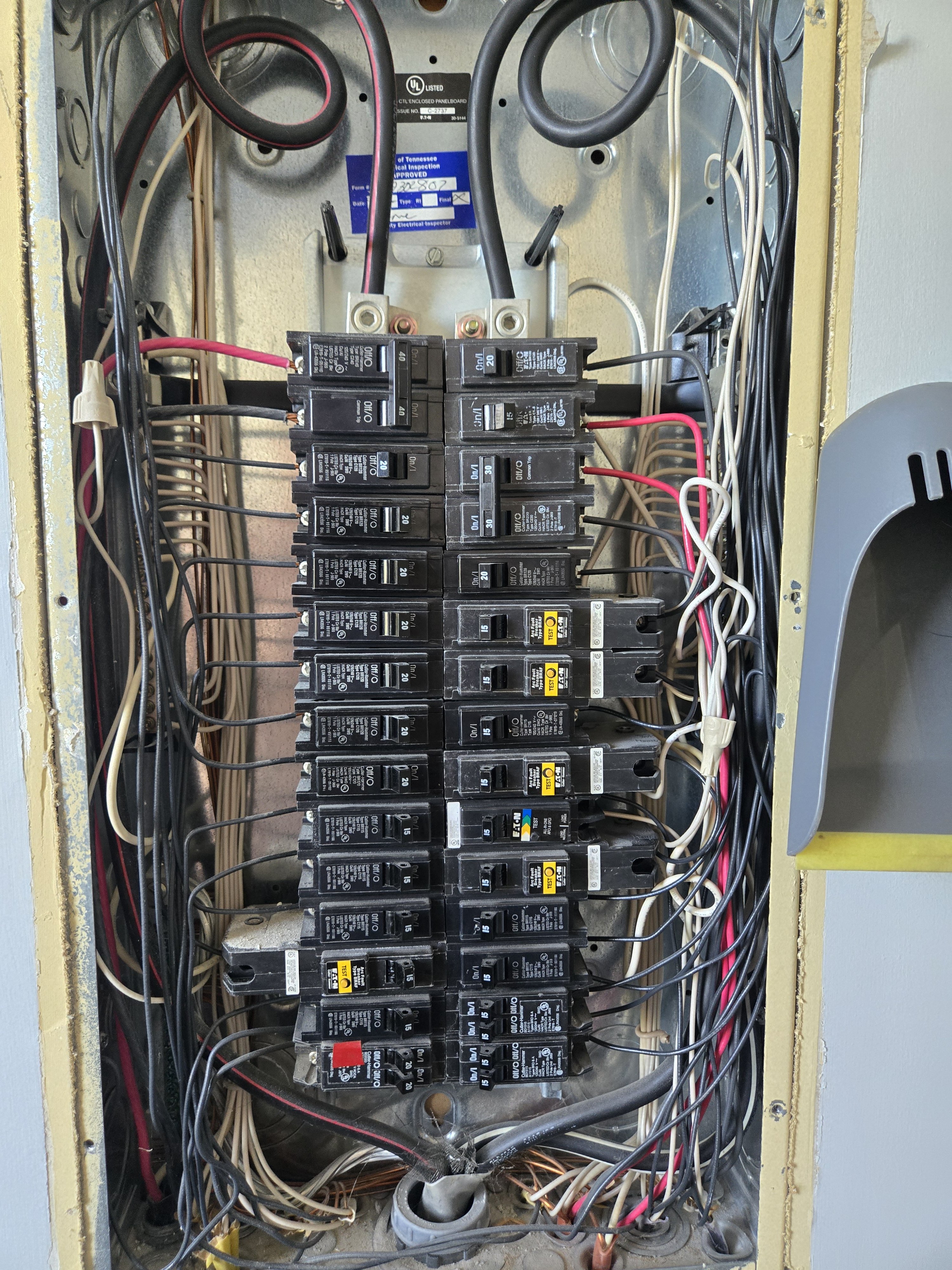

Seeing if there is any electricians that can answer a question for me. I'm needing to wire in a 240 volt plug for my garage and opened up my breaker panel to make sure I had room for a 60a breaker and I don't think I have any open slots , there does appear to be two on the very bottom of the board but I'm not sure if those are supposed to be left open ?
Assuming my board is full, is the best option to wire in a subpanel?

It is common for companies to make dead fronts with more knock-outs than the actual buss bar length.
Best thing is to wire in a subpanel. Like a Siemens 8-16 indoor next to it. Feed some #6s or #6/3 romex on a 2 pole 50 amp. You will have to move circuits to that subpanel in order to fit in a 60 for what you want.

Looks like a CH BR 40 space panel. They're sold with a main breaker 42 space also, but they use the same insulators and dead-front for either leaving to 2 spaces with no stabs.
Just install another BR 24 space panel next to it. BR2100 breaker in your current panel, feed it with #2 AL SER.
Then the fun job of moving at least 2 of those circuits over to the new panel.
Keep the ground and neutral separate. You may need an add-a-lug for the neutral buss to get a #2 in there.
Or, if you're never planning on another addition, you could pick up 2 BR2020 breakers, replace 4 of the breakers on the left, and add a BR260.
Just make sure you don't land a #14 on a 20A breaker if you use the second option.
And please for the love of God don't mix and match brands of panel and breaker types. Drives me up a wall when a customer calls me out and sends me a picture of a SQ D panel only to find out it's in a CH sub panel.
Please tell me its something cool like a welder and not an ev charger. Oh and yes your panel is full . If you want to you could remove some of your 20 Amp breakers on the left and replace with skinnies to make room for a double pole 60 Amp breaker.
